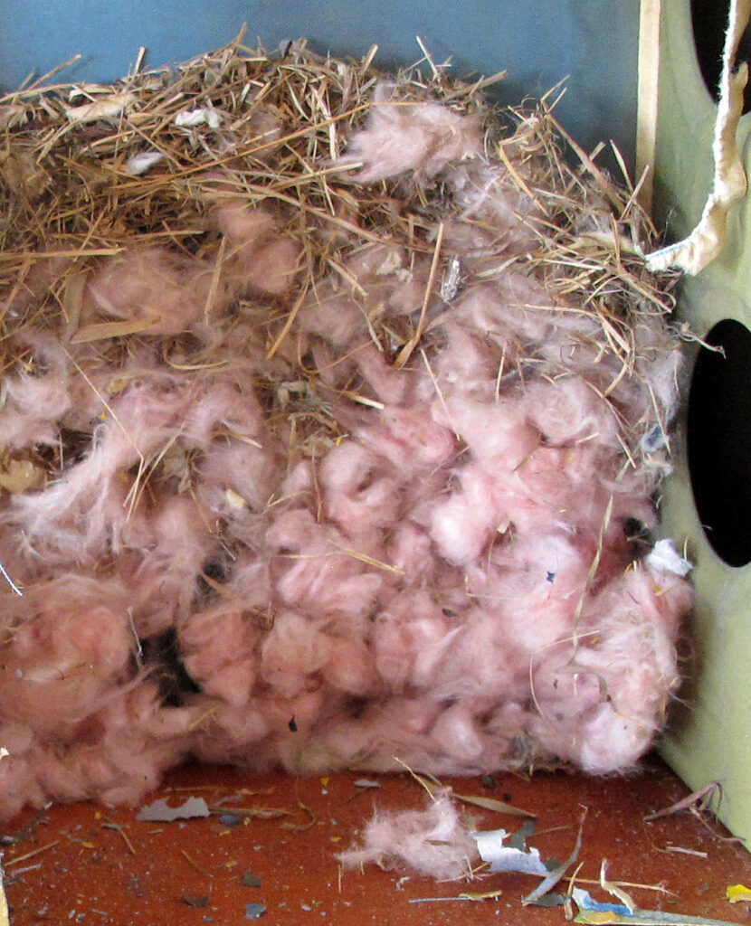

Pests. What’s new since you last saw the airplane? You might find creatures found their way in. You might not notice this right away, but it could cause serious problems if you go flying. An example is mud daubers plugging up the pitot tube and other critical air-reliant openings.
Mice love sewing cord. Even a short romp inside a fabric and laced wing can produce amazing damage, creating ballooning fabric panels upon flight. Use a suction cup to check panels and look inside with a good flashlight or scope.
