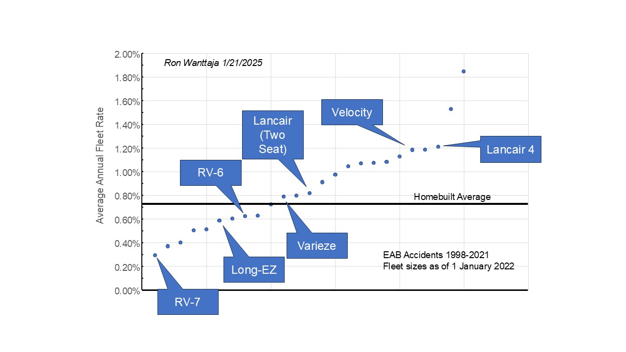

Ron,
Any chance of an update on the charts of homebuilts in comparison???
Thank you,
DV
The original article was written in 2010, which is before the FAA started the three-year re-registration process for all US aircraft. This really hammered the fleet sizes for homebuilts; we lost about 20% of the fleet by 2013, and this especially affected older types of homebuilts such as Long-Ez and Variezes.
I did grab some little newer data I had… and put it up on my web page for downloading:
http://www.wanttaja.com/rate_2021.jpg
Again, you’ll see a jump in the rates, but this is due to so many older, inactive homebuilts being removed from the registry.
