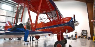

![1936 Boeing Stearman Rebuild 1936 Model 75 Boeing Stearman, s/n 003 now CF-TCQ. [Credit: Mike Davenport]](https://kitplanes.com/wp-content/uploads/2026/04/DSC_5743.jpg?w=324&h=160&crop=1)
