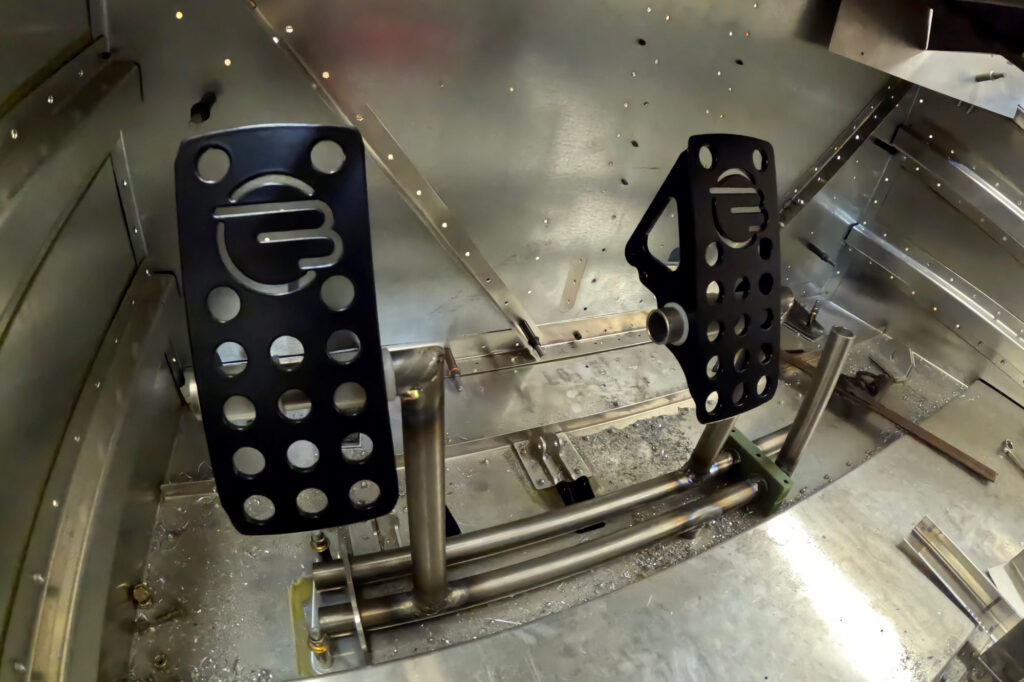

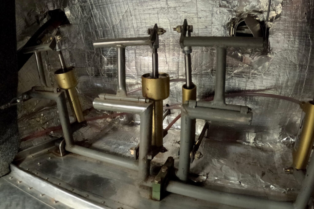

Even though there has been a full month of very limited build progress, trust that things are always advancing because my mind is almost constantly thinking about designs, even when I am not around the shop. There are a lot of obstacles to overcome, a few “aha” moments, and many hours of unseen progress when building any customized aircraft. Both of my builds share the same workspace, so while working on one, I am regularly glancing over at the other and thinking about the next steps for both builds and how to approach them. My goal has always been to get the 750SDXtreme flying first and I am still working out many details with it. One of the most current details includes research for the brake system, such as picking out the best Beringer master cylinders that will match my custom setup and geometry. The Zenith 701 and 750 designs differ in their master cylinder mounting and I have yet to decide which setup I like better. The 701 designs that I have lots of time operating, attach the bottom of the master cylinder to the vertical tubing on the pedal itself. So the entire master cylinder moves with the rudder pedal. As you rotate the rudder pedal forward, the toe brake angle rotates forward as well. This is a very simple and robust design that works excellent. The only disadvantage I see is that it requires a bit of an awkward extended foot/toe posture when applying the brake while the rudder/steering is pushed fully right or left. Basically, when trying to make very sharp turns on the ground.
The 750 design attaches the bottom of the master cylinder to the floor instead of the pedal tubing. When mounted to the floor, the geometry changes and the toe brake pedal stays closer to an upright position throughout the rudder pedal’s range of motion. While this seems like a more ergonomic design, I have limited time actually using the 750 brake setup. I have heard that the 750 floor flexes some while applying hard braking, causing a slight lack of brake control/feel during hard pedal pushing. This design obviously depends on the floor’s rigidity to maintain a firm brake feel, so I will be adding some additional stiffeners in my 750SDXtreme. Another unknown is my implementation of the Beringer Rudd’Air brake pedals. I really like the concept of these pedals, the extra foot contact area, and the adjustability that they offer, but I have never actually used them to see how they “fit” me. This is another reason I have been trying to get the 750SDXtreme in the air before finishing the Super701/half build, because it would give me the chance to see how a few of my ideas actually work and how I might improve on them before I build those components from scratch for my highly modified 701.
