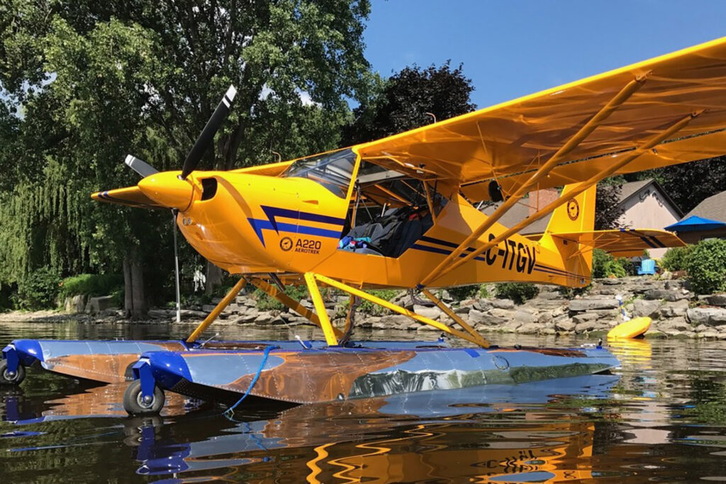

![The Aerotreks can be operated on conventional landing gear, skis, straight floats, or aluminum amphibious floats. Both 100 hp and the 115 hp Rotax turbo engines provide sufficient performance for float operations. [Credit: Aerotrek]](https://kitplanes.com/wp-content/uploads/2026/02/gagne-a220-floats-10-1024x683.jpg)
Options extend the Aerotrek’s versatility. In addition to the standard tricycle gear and taildragger configurations, the aircraft can be fitted with amphibious floats. Several float-equipped Aerotreks operate in North America, using straight floats, aluminum amphibious floats from manufacturers like Zenair, and composite floats from Canadian suppliers. The 100-horsepower engine provides adequate performance for float operations, though the optional 115-horsepower Rotax 914 turbocharged engine is available for those seeking more reserve power. The turbo installation makes particular sense for high-altitude operations.

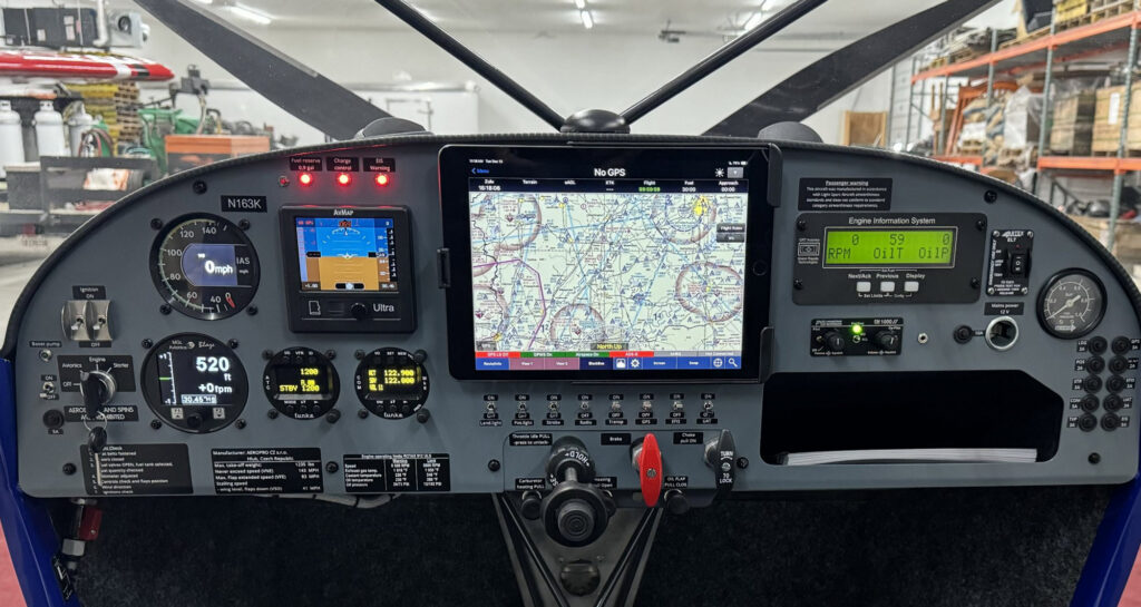

Glass panel avionics have become increasingly popular among Aerotrek buyers. Both Dynon and Garmin systems install readily, with many aircraft featuring either Dynon SkyView displays or Garmin G3X systems. These installations typically include GPS navigation, engine monitoring, and ADS-B transponders. Some owners specify simpler avionics packages centered on portable GPS units and basic engine instruments, keeping costs down.

![Complete instrumentation includes airspeed indicator, MGL electronic altimeter and VSI, and compass. Engine instrumentation is standard and includes a GRT EIS Model 4000 digital engine monitoring system. [Credit: Aerotrek]](https://kitplanes.com/wp-content/uploads/2026/02/panel-n163k-med-1024x545.jpg)
