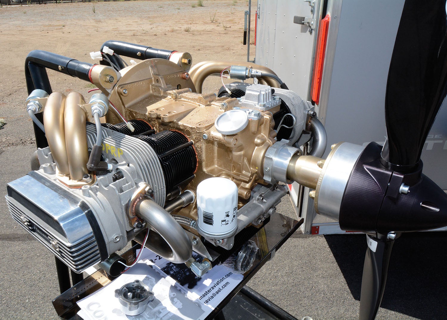

Revmaster’s bread-and-butter engine is the R-2300D direct-drive unit. Highlights are Revmaster’s own new-production cylinder heads and a fourth main bearing for maximum crankshaft support.
Easily the most experienced VW engine house, Revmaster in Hesperia, California, has been hot-rodding VW car engines since 1959 and building VW aero engines since 1968. Impressively, the original crew of Joe Horvath and Ralph Maloof are still making VW cars go very fast and developing new aero engines, so they must be doing something right.
Their bread-and-butter powerplant is the R-2300 (2331cc or 142 cubic inches) at 82 hp using 3350 takeoff rpm; the continuous rating is 2950 rpm. Clearly now a well-sorted combination, the R-2300 uses Revmaster’s own cylinder head and bristles with internal upgrades. These include a new four-bearing crankshaft, the unique ability in this market segment to support hydraulically controlled propellers, an eight-coil/eight-plug dual CDI ignition, dual 20-amp alternators and a simple, slide-type, floatless RevFlow carburetor.
