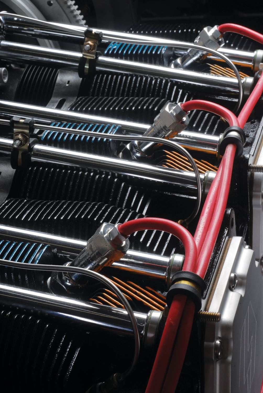

ULPower engines are where the horizontally opposed, air-cooled layout meets electronic fuel injection and ignition. Many models are available, including reverse rotation, aerobatic and several displacements.
