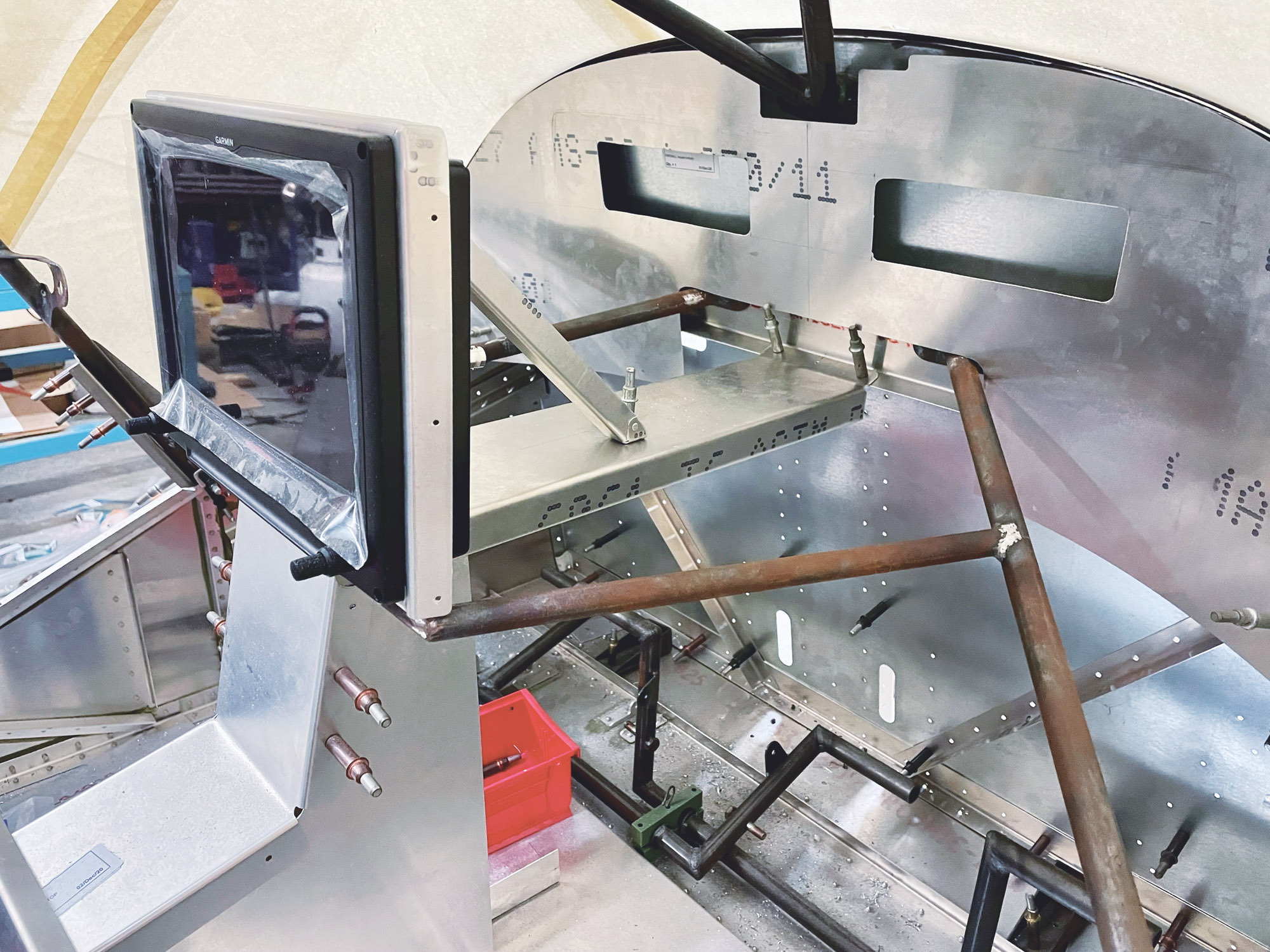

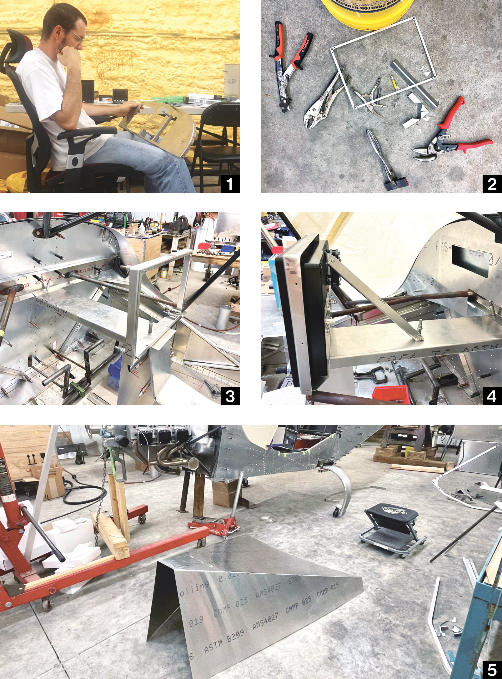

For now, with the seat frames basically complete and the door frames and windows in the works, I have also been spending some time getting the correct position for the instrument panel. Since I have the Garmin G3X Touch display in hand, it is finally time to put some of my ideas for this unique instrument pod/panel to the test.
I have been staring at cardboard mockups for months, considering exactly how I wanted it. The instrument panel is one area where the builder’s creativity and uniqueness shines. You can walk by a whole line of kit airplanes and not see too many differences on the outside, besides paint, of course. But when you look at their instrument panels, it is usually difficult to find two that are similar. I really enjoyed building the super-clean and nearly switchless panel for my Super701 and I am now determined that all the cabin area inside this Zenith CH 750 SD will put even the Super701 to shame.
1 Throwback to 2017 and Jon pondering the Super701 instrument panel design. 2 A 5-gallon bucket to sit on and lots of hand tools are what’s required to fabricate the custom Garmin G3X Touch instrument frame. 3 Here’s the instrument frame mocked up on the custom center channel brace, all sitting on top of the standard Zenith tunnel. 4 A fabricated support bracket/brace for the G3X keeps the screen steady without the cover. 5 A large piece of 6061 sheet aluminum has been bent and it’s time to begin cutting the instrument panel cover.

With my 750 SDX goals, I do not need all the extra real estate for instrumentation because I am going to depend on the single Garmin G3X for practically everything. So instead of having to fit all the instruments into the panel, I will be building a frame around the G3X.
Although these one-off pieces are very time-consuming to fabricate and build, they are still some of my favorite parts of constructing the 750 SDX. Starting with pieces of the standard L angles that come with the kit (I ordered several extra when I got the kit), I trimmed/crafted them into what is basically a small profile picture frame around the G3X, with a wider flange on the bottom for mounting and a special brace for the back to keep the G3X where it needs to be when the panel cover is removed.

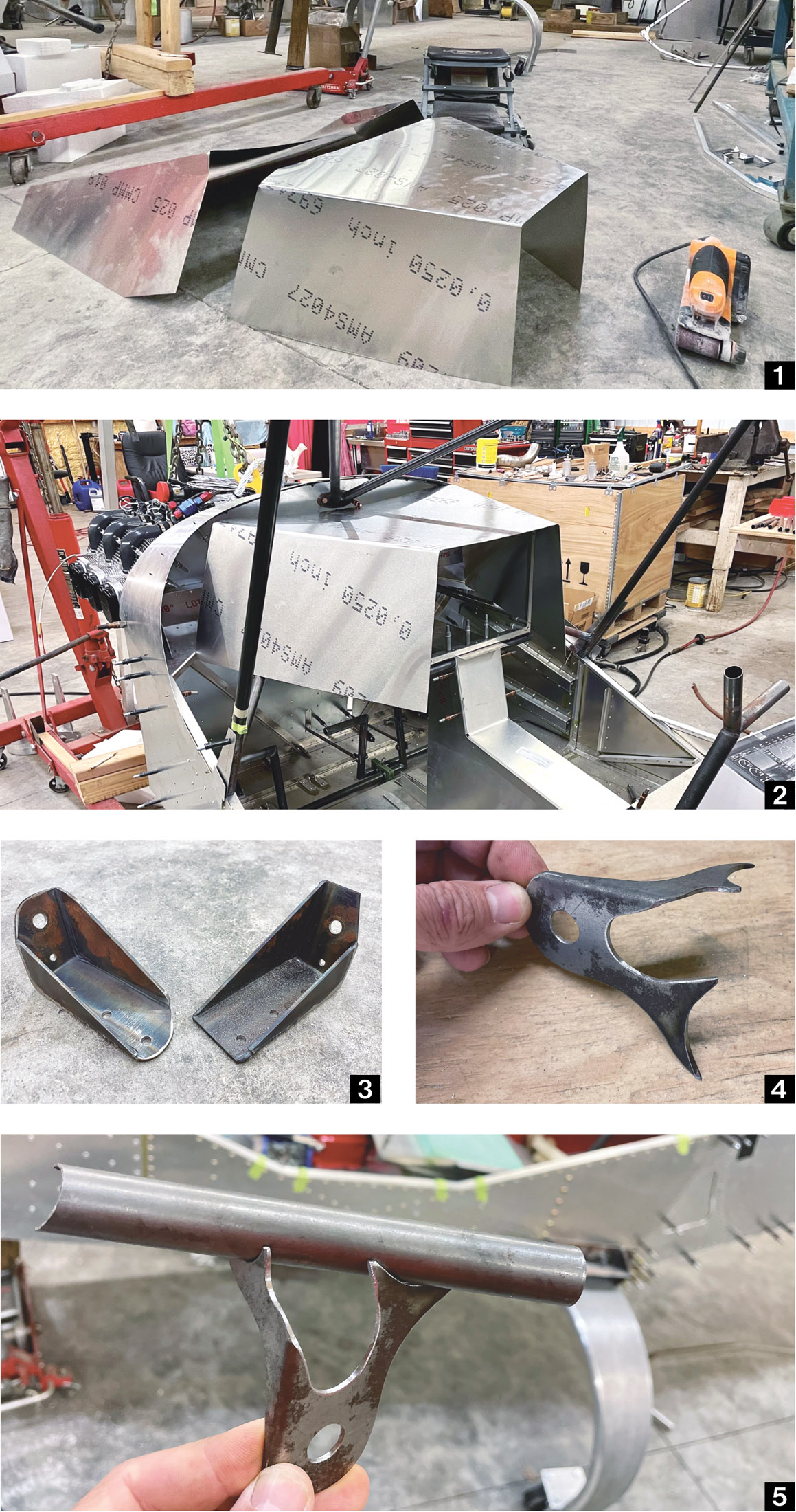

The panel cover is just a flat piece of the same aluminum skin used by the factory that I carefully marked and bent to fit around the G3X frame. I have to admit that trimming the back of the panel cover to match the rounded firewall cover was incredibly time-consuming. It is now all mocked up and mostly trimmed to fit, but there is still a little tweaking left to do to make everything exactly how I want it, so I will show more of the pod/panel next time.

Example? Even the recently fabricated and installed chrome-moly throttle bracket has been shaved to a bare minimum. The throttle cable will be one of the very few exposed pieces required for engine control and I intend to keep that to a minimum as well. The actual bracket started as a flat chrome-moly plate. I bent a 90° angle onto the plate to help with structural rigidity, then carefully measured, positioned and drilled the half-inch hole for the throttle cable to pass through and be tightened down. With plenty of trimming and sanding, I “coped” and made the bracket fit nicely onto the side tube of the cabin frame. Finally, I eliminated all the extra material possible and then welded the bracket directly to the cabin frame.
1 The panel cover, just beginning to show its proper form. Time, it takes time. 2 This is the initial placement of the rough-cut panel cover. 3 Shaving weight one piece at a time, with slightly over one-third of an ounce per piece saved on several of these factory chrome-moly brackets. 4 Here are some of the extremes: cutting material from the custom throttle bracket. 5 Coping the chrome-moly bracket to fit the cabin frame tubing.

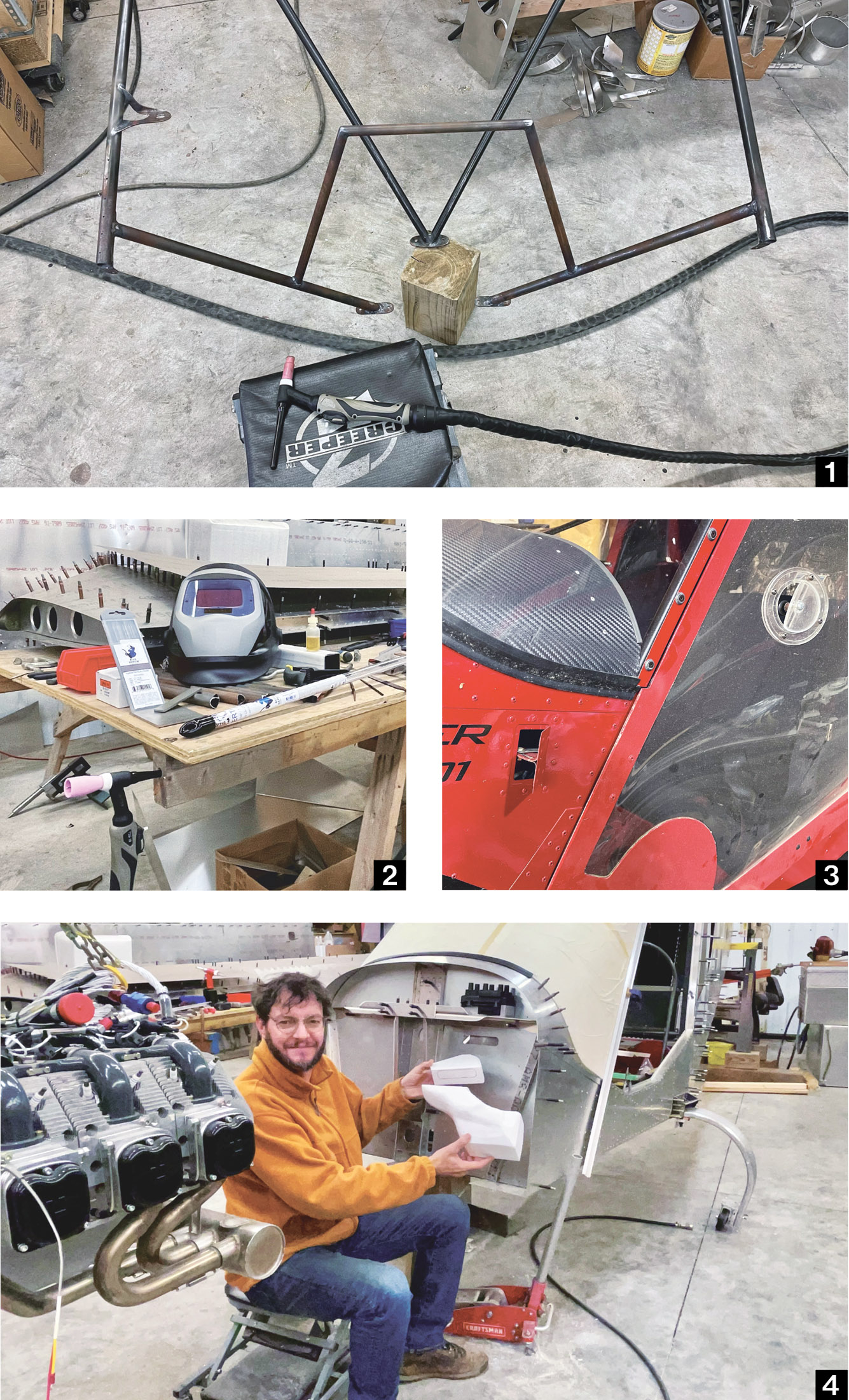

To trek even further into the never-ending pursuit of lightweight performance, it is now official that I am going to try out my abilities on fabricating and welding some titanium parts. I have been around titanium before, but I have never personally tried welding or fabricating this specialized metal. If my math is correct, with the small list of components that I intend to build and replace with titanium, the weight savings should easily add up to around 5 pounds. I know this really isn’t needed or necessary because the 750 SD already has a generous load capacity, but titanium is something that I have wanted to try my hand at for quite a few years.
Several titanium parts are currently on the way and I’ll keep you posted. Anyway, with these latest pieces being placed on a diet like all the previous pieces, I feel like I am slowly finding a nice balance between what is necessary and what is desired while still keeping performance at a maximum.

In the Super701, I also incorporated two other simple and lightweight vents into the aluminum cabin side skins. When open, they create an exposed flap that catches a lot of air and when they are closed they seal well and go nearly completely unnoticed. I have been very happy with these and decided to also use them in this build (I already have the small rectangular holes cut into the side skins for the rear seating in the 750 SDX).

1 Final welding of all the cabin frame’s custom modifications and additions comes after a lot of measuring and testing. 2 New skills alert! Preparing to weld titanium by outfitting with a new torch cup and titanium welding rods. 3 Both styles of the custom cabin vents opened on the Super701; something similar is planned for the 750 SDX. 4 Jon showing the early stages of the foam forms that will be used to make composite ducting to fit the slot in the firewall.

Here’s the reinstalled “completed” cabin frame with the Garmin G3X mocked up in its final position. This is getting exciting.

I have measured and studied and measured and studied and finally marked and cut out a rectangular slot into the firewall in the very tight area between some of the firewall bracing. To get air through this slot, I will have to build two custom shrouds. These will be attached to the firewall as a pass-through (one for the engine side and one for the cabin side) that will ultimately mate up and allow me to connect to the two eyeball vents with two SCAT tubes that will remain hidden behind the instrument panel.
It’s not an easy task. This area is getting “busy.” As am I. Shaping the foam molds is time-consuming because you don’t want to trim too much and restrict the duct volume. However, you also want the shape to be smooth and formed in such a way that it will flow nicely. The eyeball vents are ordered and I will continue this ducting process once I have figured out exactly how and where to install them in the center console. Finalizing the firewall-side mold and duct will probably be put on hold until the cowl is built so I can be sure it will tie into the cowl design properly.
