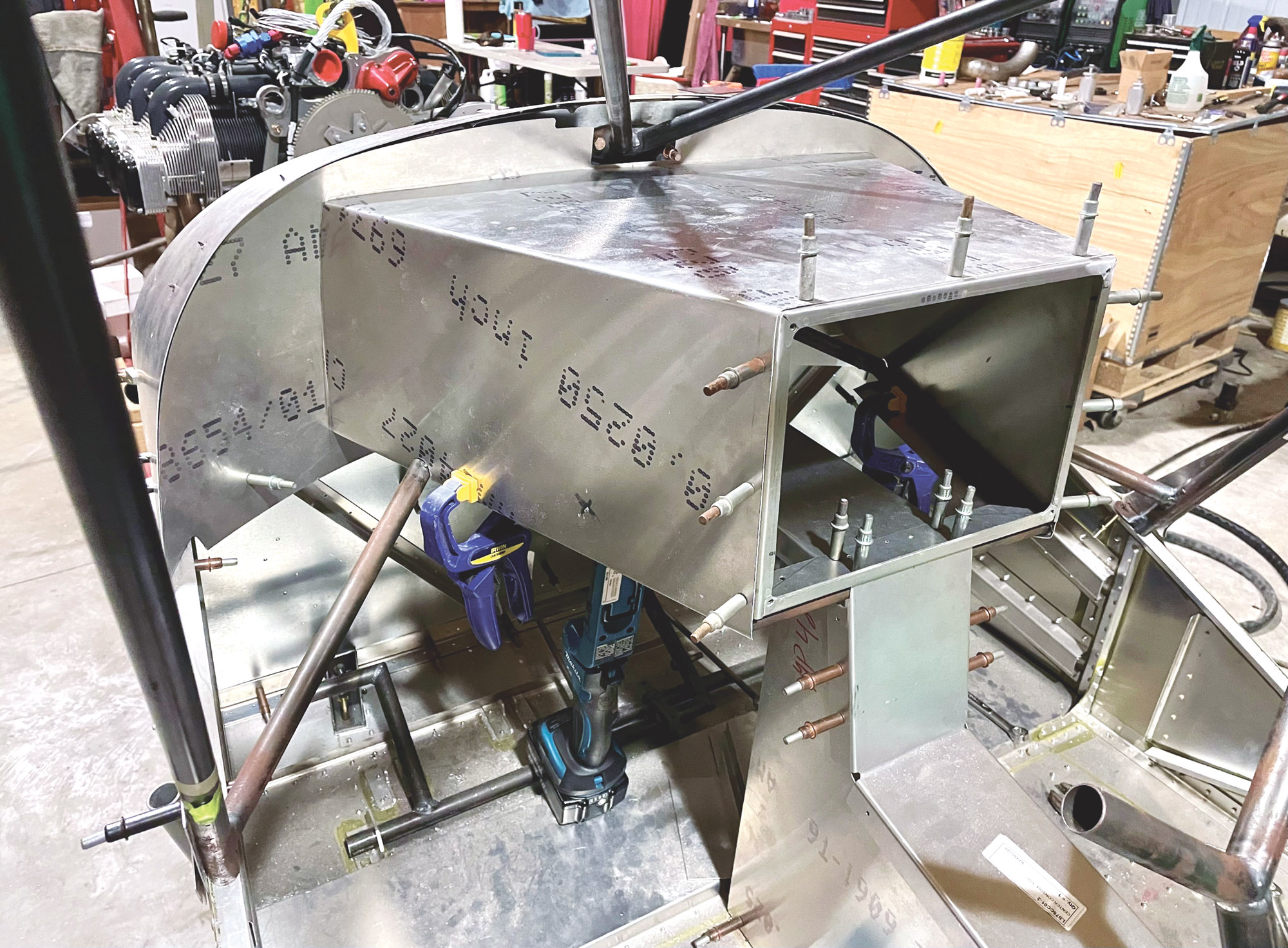

For now, with the seat frames basically complete and the door frames and windows in the works, I have also been spending some time getting the correct position for the instrument panel. Since I have the Garmin G3X Touch display in hand, it is finally time to put some of my ideas for this unique instrument pod/panel to the test.
I have been staring at cardboard mockups for months, considering exactly how I wanted it. The instrument panel is one area where the builder’s creativity and uniqueness shines. You can walk by a whole line of kit airplanes and not see too many differences on the outside, besides paint, of course. But when you look at their instrument panels, it is usually difficult to find two that are similar. I really enjoyed building the super-clean and nearly switchless panel for my Super701 and I am now determined that all the cabin area inside this Zenith CH 750 SD will put even the Super701 to shame.
While most Zeniths are built using one of the available instrument panel blanks from the factory (Zenith also offers some precut packages), I have decided to do this one differently. The common instrument panel is formed with flanges around the sides for mounting into the plane and a large flat face that can be cut out for instruments of various sizes so the builder can install almost any combination of instruments they desire.
With my 750 SDX goals, I do not need all the extra real estate for instrumentation because I am going to depend on the single Garmin G3X for practically everything. So instead of having to fit all the instruments into the panel, I will be building a frame around the G3X.
Although these one-off pieces are very time-consuming to fabricate and build, they are still some of my favorite parts of constructing the 750 SDX. Starting with pieces of the standard L angles that come with the kit (I ordered several extra when I got the kit), I trimmed/crafted them into what is basically a small profile picture frame around the G3X, with a wider flange on the bottom for mounting and a special brace for the back to keep the G3X where it needs to be when the panel cover is removed.
The panel cover is just a flat piece of the same aluminum skin used by the factory that I carefully marked and bent to fit around the G3X frame. I have to admit that trimming the back of the panel cover to match the rounded firewall cover was incredibly time-consuming. It is now all mocked up and mostly trimmed to fit, but there is still a little tweaking left to do to make everything exactly how I want it, so I will show more of the pod/panel next time.
