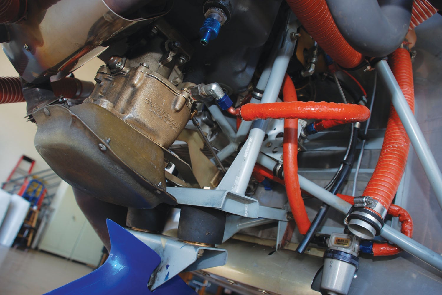

Landing Gear
annual inspection II 01
These rubber bushings act as springs for the nose gear. Special items like this need to be added to any generic checklist you start with.
(1) All units—for poor condition and insecurity of attachment. For fixed-gear airplanes this is pretty simple. Just check the gear for any damage or corrosion and repair or replace items as needed. When in doubt, consult with the kit manufacturer for what may be repaired versus what must be replaced. Include things like tailwheel springs and nosewheel struts here.
(2) Shock absorbing devices—for improper oleo fluid level. These are not too common on Experimental airplanes, but if they’re present be sure to inspect and service them. Bungees or springs for Cub-type gear get covered here.
(3) Linkages, trusses, and members—for undue or excessive wear fatigue and distortion. Steering parts for nose or tail need to be inspected, serviced and repaired as necessary. Cabanes for Cub-type gear should be inspected for cracks or other damage, as would safety cables if present.
