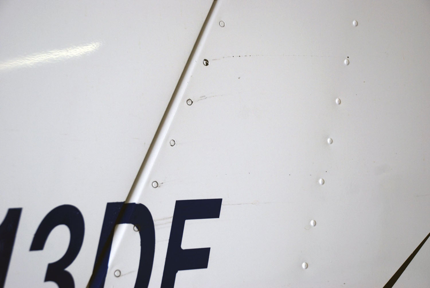

Fuselage and Hull
(1) Inspect the fabric and skin for signs of deterioration, distortion, other evidence of failure and defective or insecure attachment of fittings. With fabric aircraft, this means a thorough inspection of all fabric-covered surfaces with further testing in any questionable areas. Expect to see the first signs of trouble on the tops of wings and fuselage—areas exposed to the sun. For metal, cracking and corrosion will get most of your attention, but also be on the lookout for missing fasteners or smoking rivets. Composite airplanes need to be checked for cracking and delamination.
condition inspection 01
The black rings around these rivets mean that they are loose. This is what is meant by smoking rivets. Often, they will also leave a black trail extending rearward.
