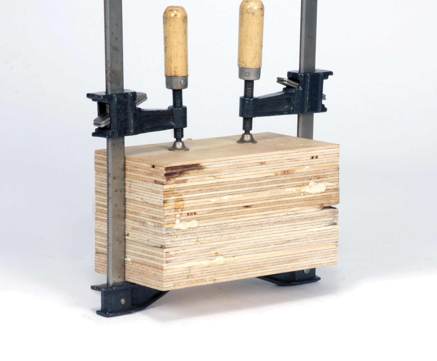

Photo 9 clamped up glue block
The sacrificial dowel was made by gluing up six layers of ¾-inch plywood.

The plywood glue-block was turned into a 3.8-inch diameter dowel on the wood lathe. A roughing gouge was used from square block (left) to finished diameter (right). Power sanding on the lathe with 120-grit sandpaper smoothed out the tool marks.

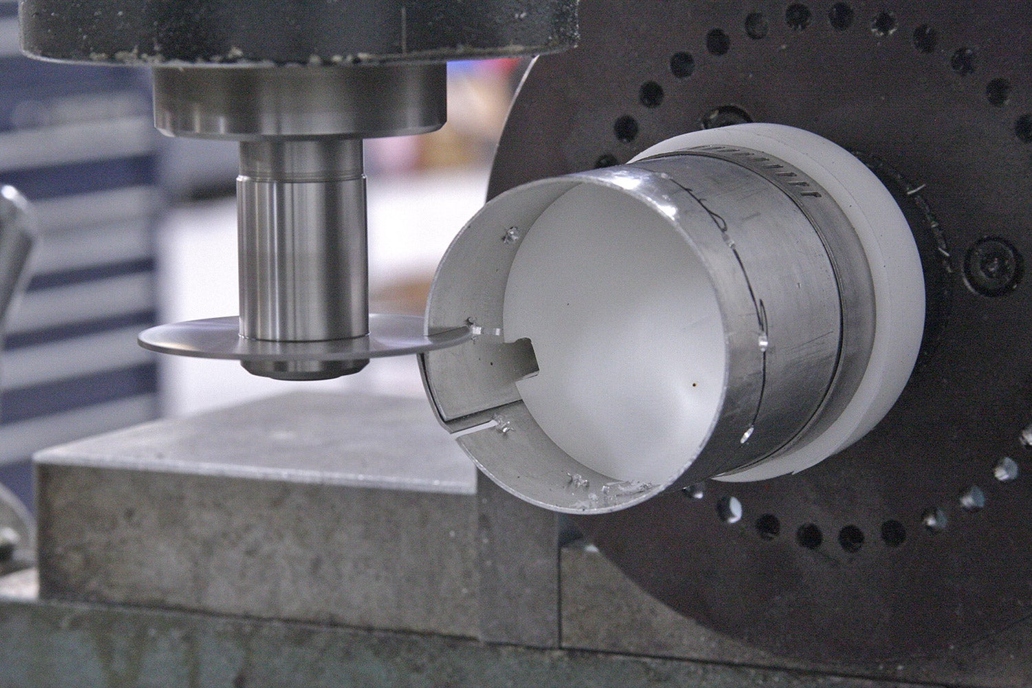

Photo 17 drilling for flange bends
With the outlet tube clamped to the Delrin plastic arbor and mounted in the indexer, a series of stop holes were drilled (left) along the scribe line at 36° intervals. A 0.040-inch slitting saw was used to cut fingers from each stop hole (right).

To prevent the cuff from collapsing and snagging on the hole saw, I made a large dowel to provide sacrificial support for drilling the cuff in the mill. I used a similar idea to hold the outlet tube in the indexer for drilling and slitting. But instead of wood and a wood lathe, I used my metal lathe and some 2-1/2-inch diameter Delrin rod.

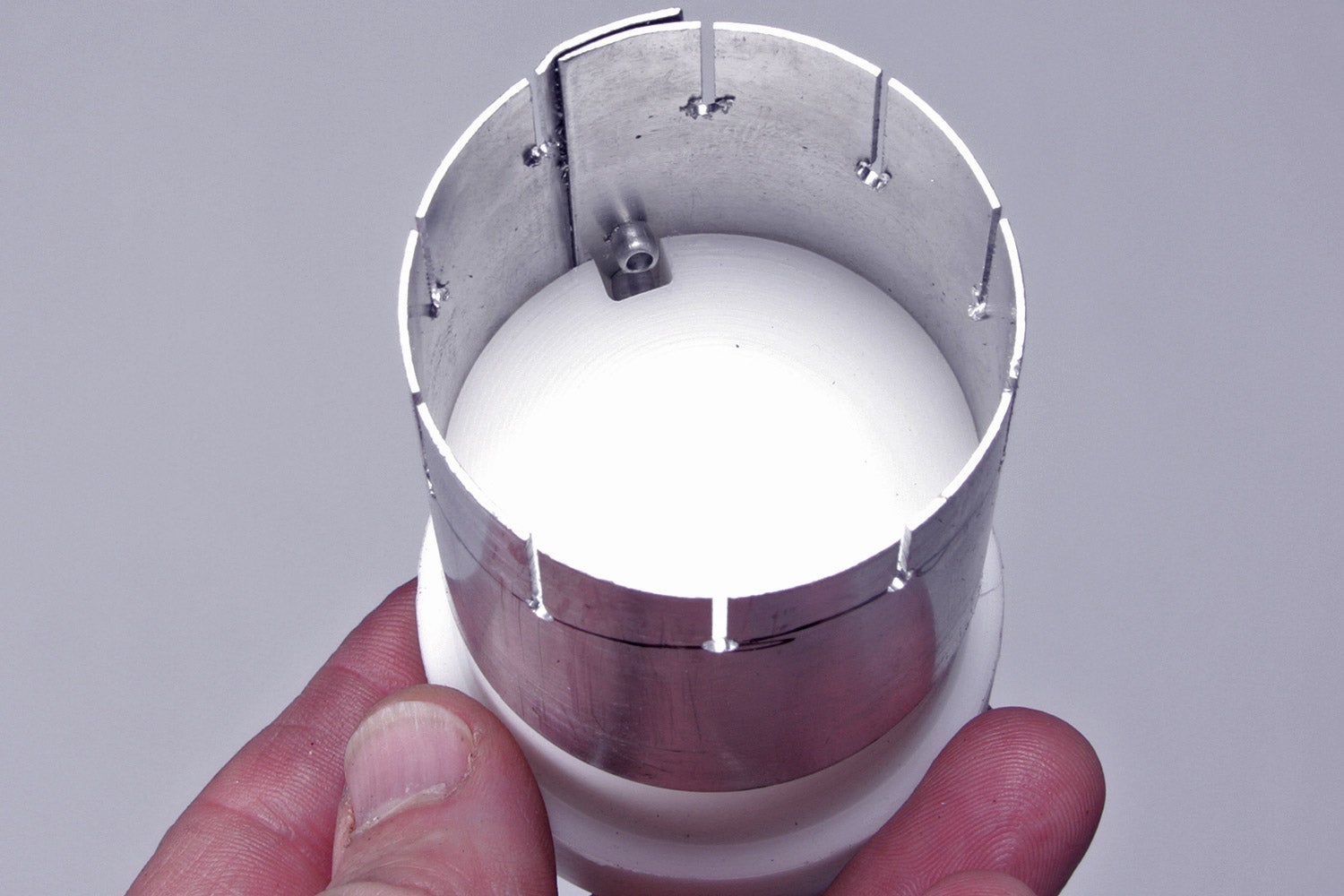

Photo 19 test fit flange1
Using the scribe mark as a reference to line up the outlet coupling, the fingers were carefully bent to conform to the ID of the cuff. The finger position was then transferred to the outside of the cuff to locate the position of the holes for the rivets.
