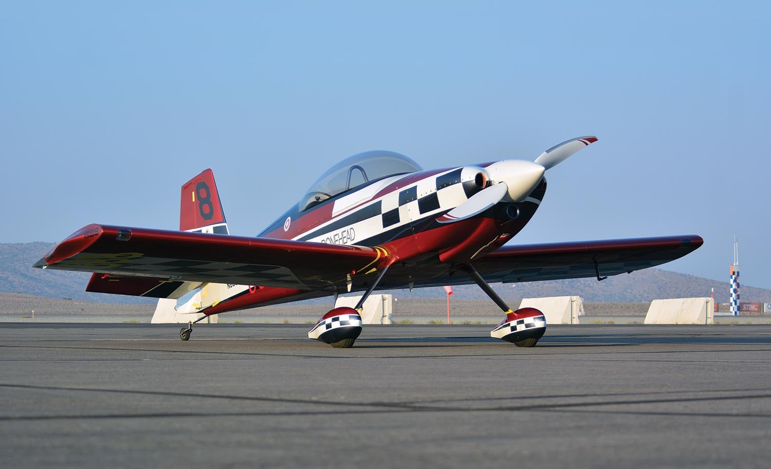

Electrons and nitrous put Neil Wischer’s RV-8 into the 270-mph club.
Wischer RV 8 01We don’t normally think of hydropower as a path to Experimental aviation, but in Neil Wischer’s case, it was definitely the enabler. Starting with his grandparents’ and parents’ spinner-over-tail group for model airplanes, the youthful Neil found he was “the worst RC pilot ever” and ended up in the Navy where he got into the steam side of nuclear propulsion.

Race 8 is an essentially stock RV-8 airframe. Neil says he will not cut the canopy down or any other “crazy rework. It’s still a cross-country airplane. I do formation flying the rest of the year, and it has to be able to go back to a normal RV” after racing at Reno in September.

In naturally aspirated trim Neil’s RV-8 runs pretty much like any other RV-8, as the airframe is near stock and the 390 engine is otherwise standard stuff. Neil figures his -8 yields about 205 knots down low at full throttle. That’s sea level at 19 to 20 gallons an hour fuel burn, running full rich at wide-open throttle. He’s not ironclad on those numbers because “I’m rarely there” running so hard, so low.
The fastest lap he’s turned around the Reno racecourse, which is nominally 5000 feet elevation, is 272 mph (Reno gives lap times in mph, not knots) with the nitrous engaged and the 100LL flowing well over 30 gph. For all-out speed, running straight and level, Neil figures he can wring 250 knots (287 mph) out of his combination. That’s fast enough for the airframe and as Neil understands, about as much as he’ll get from engine power as he reasonably can’t carry more nitrous. Any faster is going to require aerodynamic mods that aren’t likely, given his RV-8 needs to function normally in the real world 50 weeks out of the year, and it’s up against its structural limits anyway.
