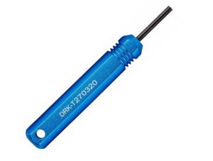

Like many builders, I have a love/hate relationship with Molex’s lightweight plastic connector series. Truth is, I find the lightweight versions really useful. When I installed my new Garmin GTR 200 com radio, I didn’t have everything to connect to it, but I stubbed out four audio sources (two in, plus music in and recorded audio out) and the RS-232 data. The smaller Molex connectors (with the 0.062-inch pins) are perfect for this, especially since you can order the pins and sockets for exactly the wire gauge you’re using. The trick to happiness here is the right crimper tool, which I bought from B&C Specialty Products many years ago. The BCT-2 ($39) works wonderfully on these smaller Molex pins and sockets. molex extractorI’d tried several “off the shelf” crimpers but this is the only one that performs consistently well, making the double-inverted-U crimps accurately, even on the thinner insulator found with Tefzel wire.
Incidentally, the official Molex extraction tool is good but fairly expensive. These have worked well for me.
