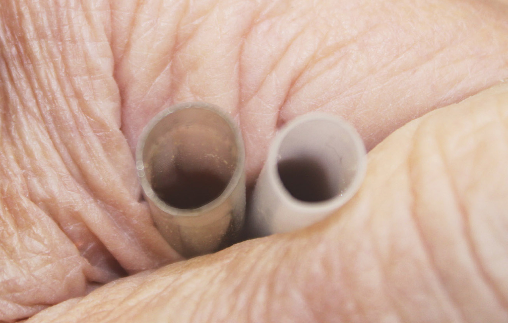

Two ¼-inch shrink-sleeve samples. On the left is the window-clear version and on the right is the wax-paper-clear version. Window-clear is about 4 mm over ¼ inch and wax-paper-clear is as close to exactly ¼ inch as my drill and vernier caliper can measure.

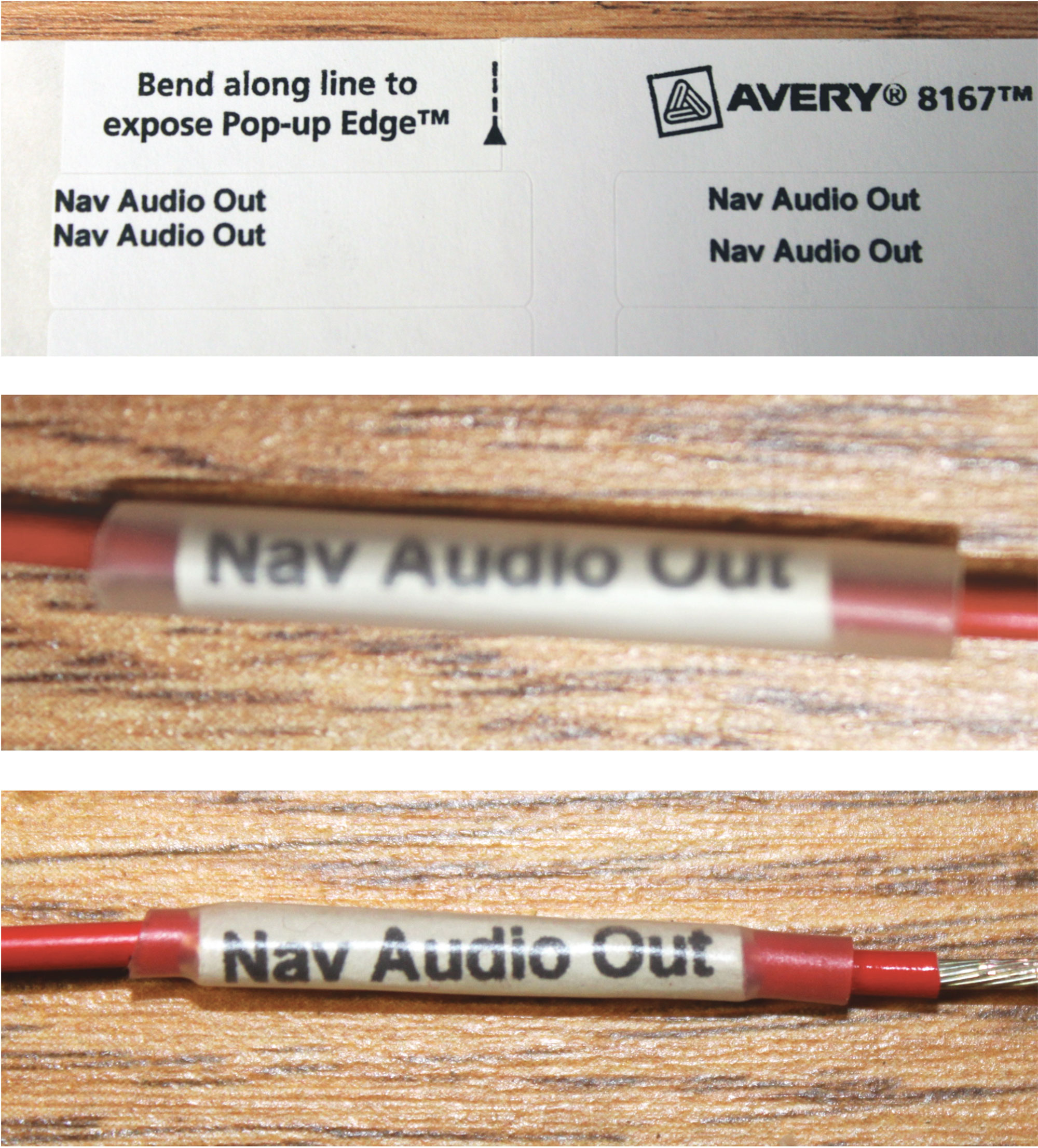

This brings us back to a paper label under clear shrink sleeving. Simply print the number or verbal description of the wire onto a cheap, very small return-address label, with the same number or description repeated on the label as many times as it will fit. After printing, be sure to apply a label at both ends of each wire.
Printing can be done on an inexpensive laser or inkjet printer for fractions of a cent. It doesn’t really matter whether you use a laser printer that actually heat-fuses the ink onto the label or an inkjet that prints cold ink onto the label. Although my personal belt-and-suspenders preference is for the laser, I’ve had 100% success with both. And if you mess up a label, you can crank out duplicates quickly and cheaply. For reference, look up Avery 5167/8167 Return Address Labels. You get 2000 individual labels for about $12.
wire labels weir
Two ways of printing the label (top). The one on the left will just barely fit on the wire without overlapping, and the one on the right will easily fit on both sides if you carefully use a hobby knife to cut off the backing. Your choice. One of the labels with the un-shrunk sleeve fitted over the label and ready to shrink (middle). Note that the sleeve has a good 0.1 inch on each end beyond the label. The same wire but the sleeve has been shrunk to form a hermetic seal over the label on both ends (above). Don’t forget to leave enough of the wire to solder it to the connector or to fit a crimp terminal.

The real secret to the success of this method is to cover the label on the wire with clear shrink sleeving. This hermetically seals the label from solvents to the label ink as well as abrasion from chafing over the life of the airplane. The devil is in the details, as I found down one of the aforementioned rabbit holes. In this case, it is the definition of “clear” as applied to shrink sleeving.
To most people “clear” means window-glass clear—optically free from any impediment to sight. Unfortunately, clear in the shrink-sleeving world usually means waxed-paper clear. You can read a printed sheet directly under the wax paper, but if you get some distance between the wax paper and the sheet, the printing becomes fuzzy. Fortunately for our purposes, we shrink the sleeving tightly to the printed label, so one type of sleeving works as well as the other.

  1. The window-clear sleeving is not as flexible as the wax-paper-clear sleeving. I fear that in the installation and vibration worlds, the window-clear sleeving will have a propensity to crack and peel over time.
  2. The window-clear sleeving is not as dimensionally reliable as the wax-paper-clear sleeving. I took a few samples of window-clear sleeving and measured them. It seems that the manufacturing tolerance of the window-clear sleeving is wider than the wax-paper-clear sleeving. I took several samples of ¼-inch window-clear sleeving and they came out a couple of millimeters both above and below a true ¼ inch. The wax-paper-clear ¼-inch samples were indistinguishable from my measurement tools: a ¼-inch drill bit and a digital caliper accurate to one mil.
  3. Finally, the wax-paper-clear sleeving all shrunk to exactly the same dimension. Some of the window-clear sleeving shrank 40%, some shrank 60% and there was no way of telling from examining the samples how much they were going to shrink. That may or may not be a problem in your application.
