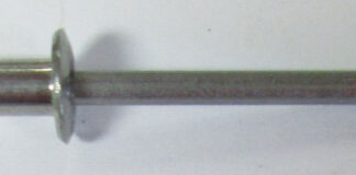

There are some types of hardware which should never be used in safety-critical or load-bearing aircraft applications. One such is the hollow blind rivet, or “pop rivet.” There are several kinds of blind rivets, which tend to all get lumped together as pop rivets. Some are aircraft quality, or at least useable as aircraft fasteners, and some are not.
All blind rivets work essentially the same way. The rivet body has a hole down in its center. There is a mandrel in the hole, with a stem which protrudes from the rivet head. After the rivet is inserted in the hole, the mandrel is pulled up with a rivet puller, causing the end of the rivet to expand and hold the rivet in the hole. The mandrel stem breaks off near the head, leaving the rivet in the hole.
The critical difference between the different types of blind rivets lies in what happens to the mandrel after the rivet is set. On aircraft-quality blind rivets such as the Cherrymax, there is a locking collar inside the rivet body which holds the mandrel permanently in place. Such a rivet is essentially equivalent to a solid rivet and is safe to use.
Some industrial blind rivets also have a positive mandrel-retention feature, and these are the types which are commonly found on all-metal homebuilts. They are usually used in areas where a component is held in place by many rivets, so that the failure of a single rivet is not immediately threatening to the integrity of the airplane.
Some blind rivets do not have positive mandrel retention. On these, the mandrel is held in by nothing more than friction with the inside of the rivet body. This is the case for almost all hardware-store rivets. The danger with these rivets is that the mandrels often fall out after the rivet has been in place for some time. This is particularly true if the rivet is used in a high-vibration environment, such as the structure of a metal airplane.
With the mandrel gone, all that is left of the rivet is a thin-walled tube. This has very little crush strength, and will shear, deform, or pull out under relatively low loads. Such rivets are fundamentally unreliable and should never be a part of any flight-critical structure or component. Unfortunately, it appears that not all designers understand this. I have recently seen a light homebuilt with hollow “dime-store” rivets holding the end fitting into the main wing lift strut at both ends. On the same airplane, the same type of rivets were used to attach a tang to the aft fuselage. The tail brace wires were attached to this tang. Use of hollow blind rivets without positive mandrel retention in these safety-critical situations is inherently dangerous, and should be avoided.
There are a few types of industrial blind rivets that are in common use in the homebuilt world. They are used on several popular and successful kit airplanes. A designer seeking to save cost by using industrial rivets rather than certified aircraft-quality rivets would be wise to learn from the experience gained by these successes, and use the same types of rivets.
wt 002 2
There’s nothing wrong with blind or pop rivets, as long as they’re used in the right application where loads aren’t too high.
