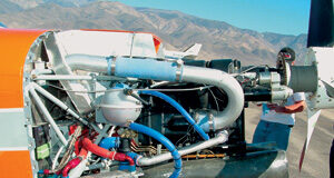

At the front end of the cabin there are several things a designer can do to reduce crash impact forces on the crew space. The most important is to provide some effective crush space forward of the rudder pedals. In a frontal impact, the structure in this crush space can crumple and absorb energy without invading the crew space. The length of the crush space adds to the overall stopping distance of the crew and seats, and reduces the overall force on the rest of the airplane.
Crush space is only useful for safety if there is energy-absorbing structure within it to crumple. This is a problem on typical tractor-engine singles, as the cowling is too light to absorb much energy. Most of the crushing in an impact happens from the firewall aft. This is bad, because the people also are located just aft of the firewall. Some recent tests have shown that a properly designed bed-type engine mount can absorb a significant amount of energy in an impact without compromising the cabin space.
