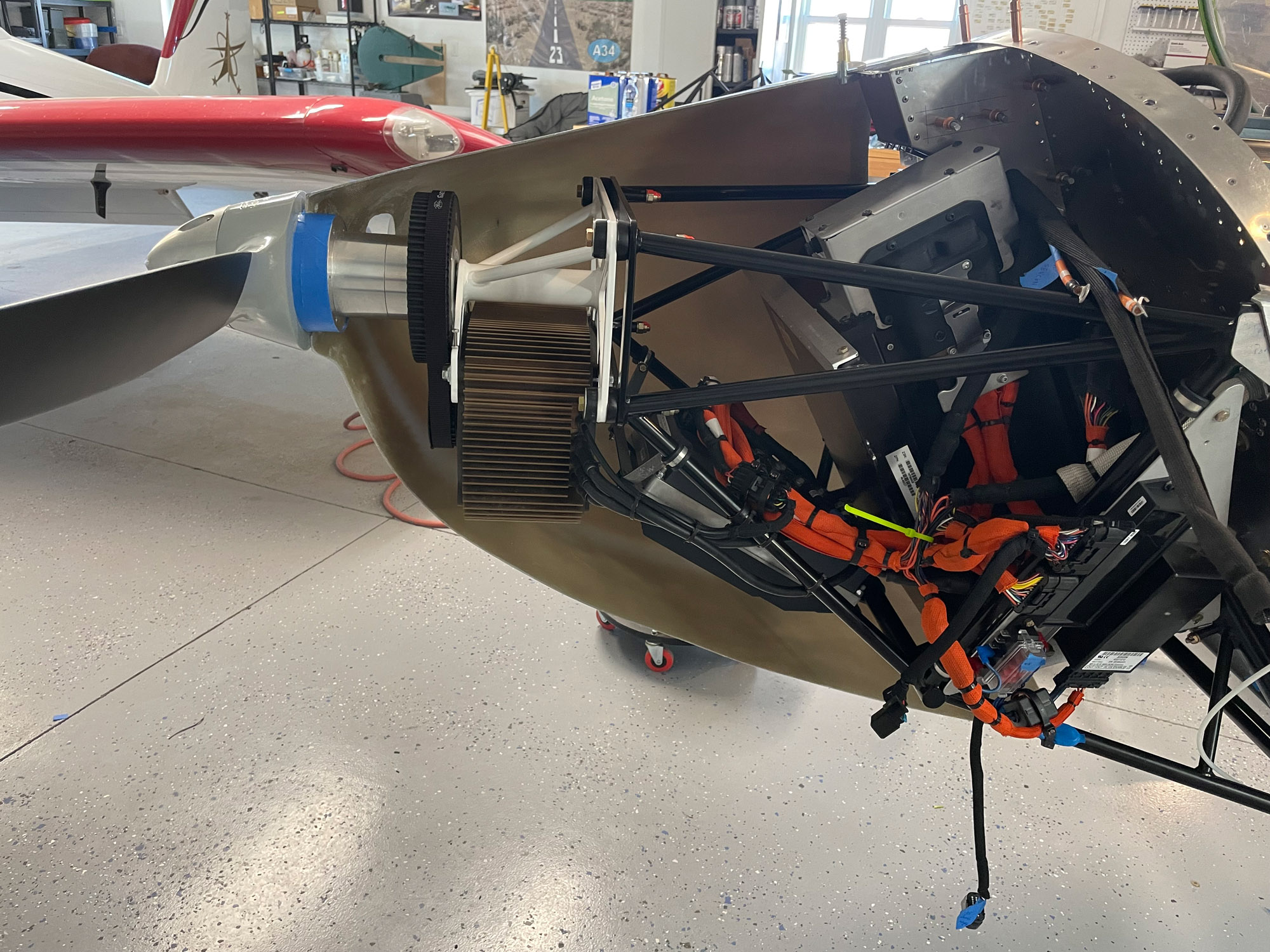

When it comes to engines, there are aircraft engines, automotive engines—and then some completely new forms of powerplant, like electric…or small turbines. Let’s pass on the electrics and turbines for today’s discussion—and by the way, I have built and own examples of each—so I am far from agnostic on the topic of “alternatives.” But let’s look at the choice between traditional aircraft engines and automotive engines converted to aircraft use. I have flown many examples of the latter and am still here to talk about it—and while quirky, they can be done safely. How efficient and how well they match airframes…well, that is another matter.

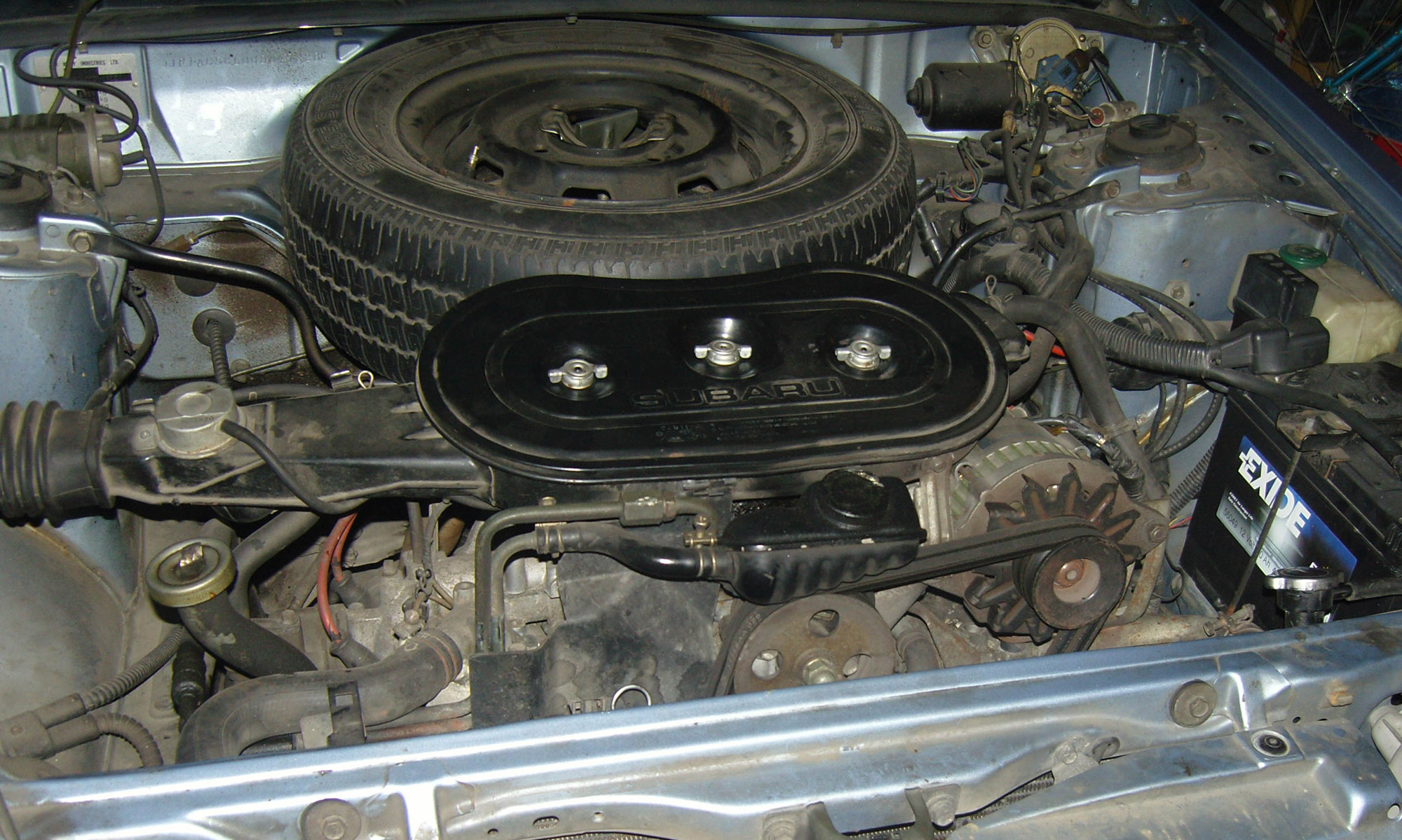

Automotive conversions are frequently marketed as far cheaper than their aircraft counterparts, and generally speaking, the bare engines are just that—far, far cheaper than their aviation equivalents. But the devil is in the details—and the details are where the idea that automotive options are a cheap way to get in the air comes off the rails.

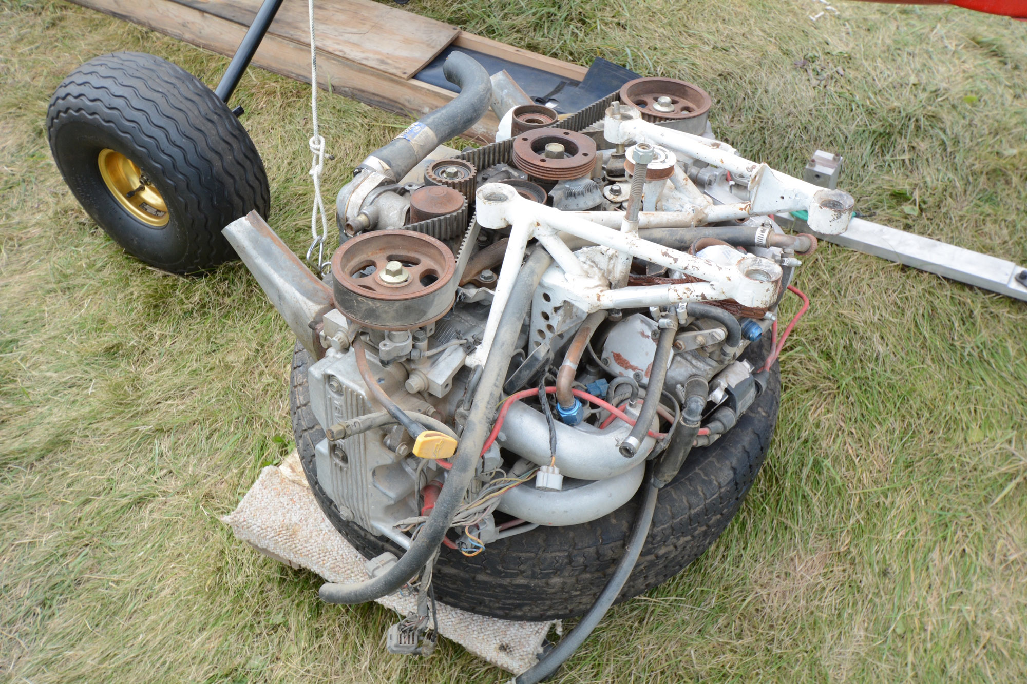

I have known many people who have gone the alternative route, and well more than half have eventually ripped the powerplant off at the firewall and replaced it with a traditional aircraft engine to make their airplanes reliable and usable.
Automotive conversions are rarely failures because of the core powerplant. They fail because of accessories—reduction drives, cooling systems, ignition or induction systems. There are lots of things that are designed into car engines because they are designed for cars. You can overcome these deficiencies with lots of time, effort, and money—all while your friends are flying off to pancake breakfasts and lunch runs while you’re sweating away trying to figure out why your exhaust keeps cracking.
The truth is that automotive conversions start out cheap but often cost a great deal in upgrades and modifications—and they rarely seem to come up with the same horsepower for a given weight as aircraft engines. And you know what—that makes sense! They were designed for cars, not for airplanes!
