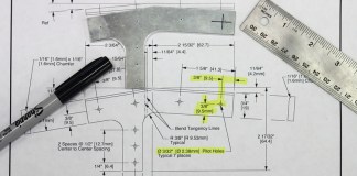

One of these parts may look more complicated but both can be made from the same angle stock using a drill and bandsaw.
Most of us won’t machine a complicated part, but homebuilders with three-axis machining capability, like followers of KITPLANES contributing editor Bob Hadley, might. Other parts would be expensive and time-consuming for most builders to build, like a blown canopy, which requires a large oven and the right temperature. A fiberglass cowling could be made by hand, though few would consider that option. Yet, it can be done. If it gets your one-of-a-kind Huxley Hovermobile flying again the time and effort may well be worth it. For an RV-6, probably not.
