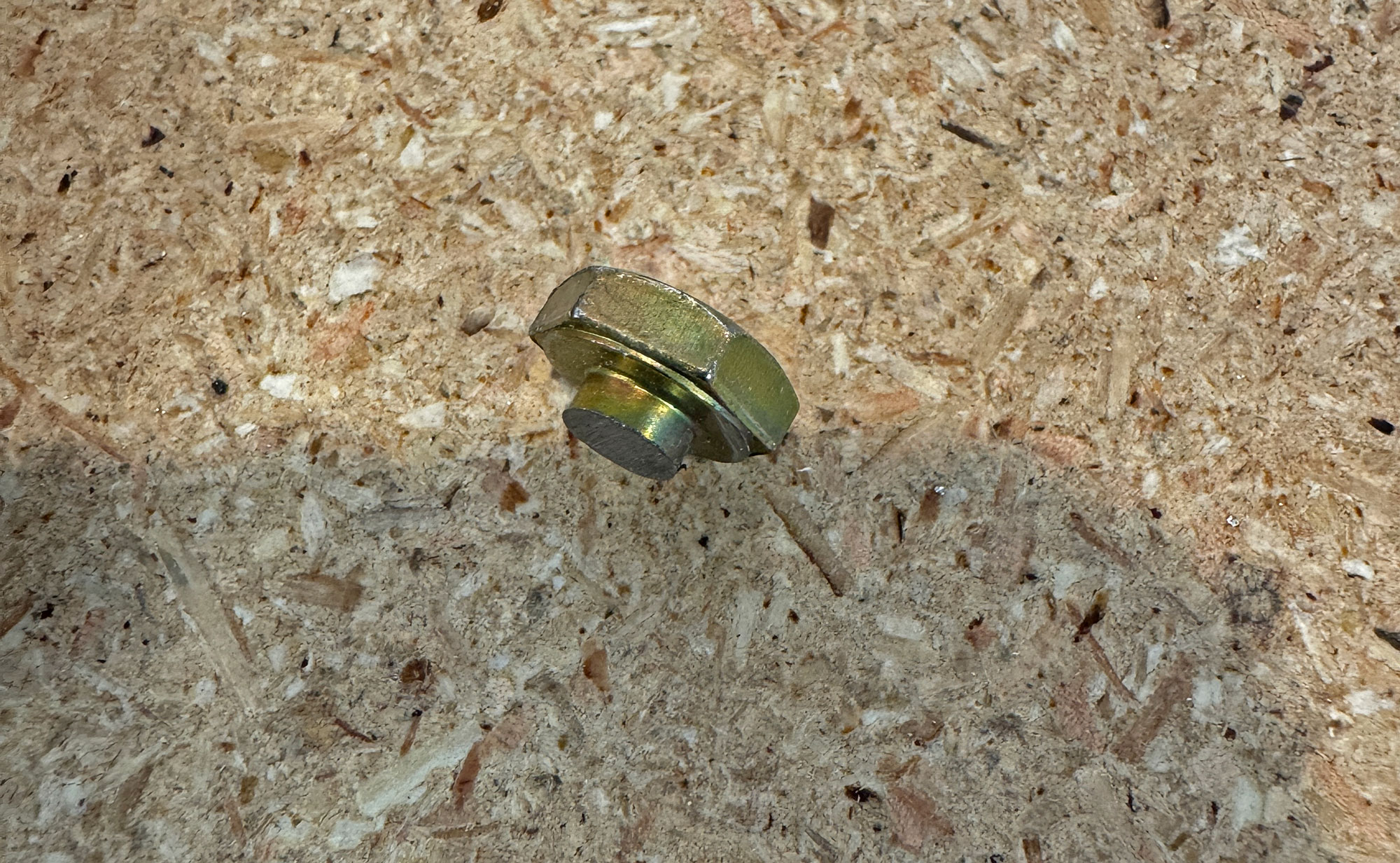

modified yoke IMG 5565
You can just see the tiny AN3 Bolt shank stick through the hole in the duct tape – it requires precision in lining it up on the rivet tail of course. I did polish the face of the bolt shank stub before using it – I’m not a complete heathen!
Yesterday I was squeezing a couple of rivets in a very narrow spot inside the rear spar of the F1 Rocket left elevator – the part that is immediately ahead of the trim tab. A No—Hole yoke is mandatory because you have very little room (1” maybe) between the spar flanges. But you also have a hinge “loop” to get over, so you need just a little rise to prevent smashing that. I could have drilled a hole in my No-Hole and using a thin flat die – but then I wouldn’t have a no-hole anymore!
modified yoke IMG 5568
That’s a nice, thin rivet die – and I found it on the shop floor!
The solution – I needed a thin flat die taped to the no-hole – but I didn’t want tape between the yoke face and the tail of the rivet. So I looked on the floor and found the head of an AN-3 I had cut off for some reason. I flattened and polished the stub of the bolt shank. Then I took a piece of duct tape and drilled a hole in it, allowing the bolt shank (now a squeezer die!) to stick through, then taped that to the no-hole. This effectively gave me an extremely shallow Longeron Yoke that fit in the narrow space but gave me an offset.
