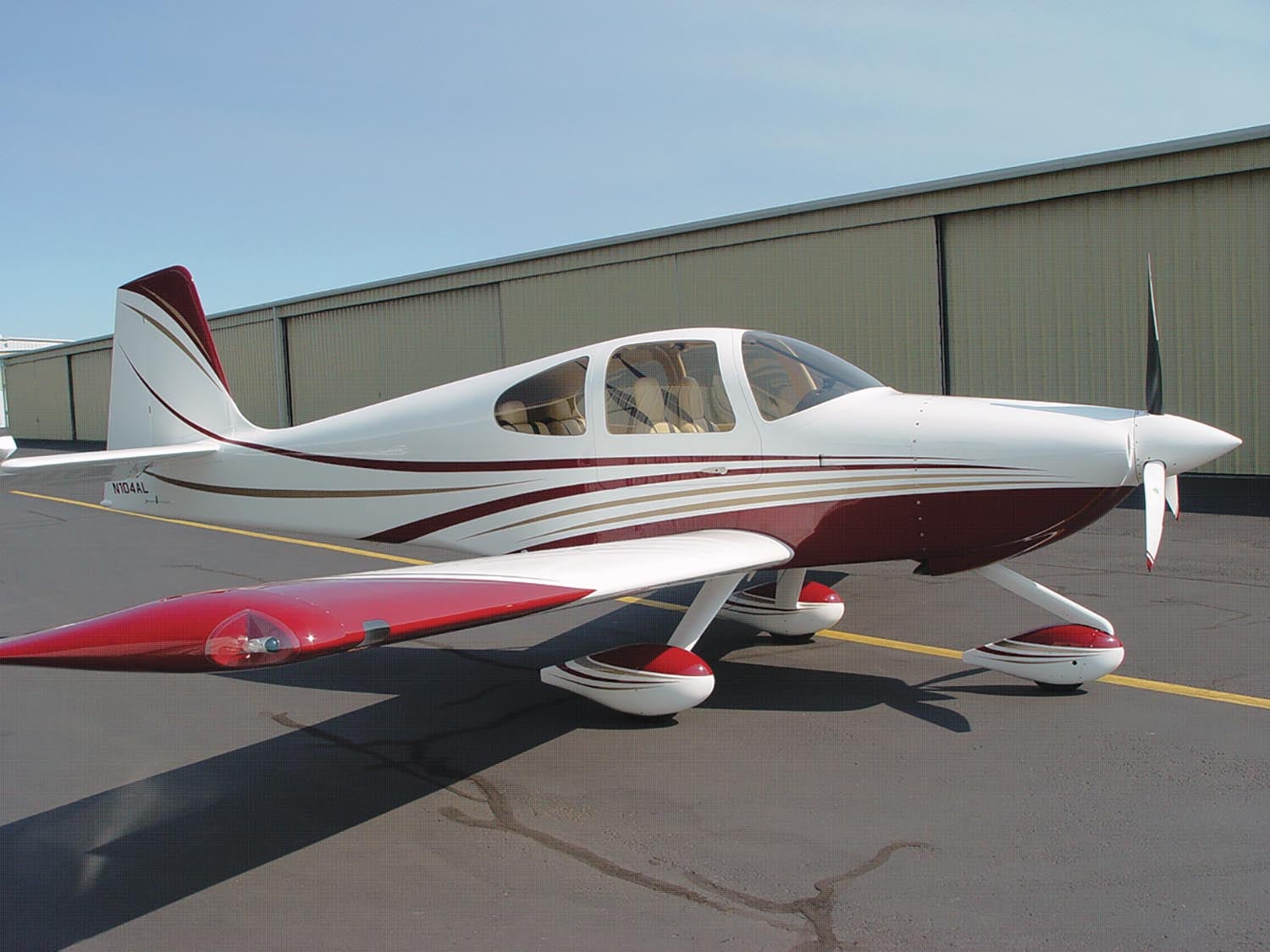

The fastback modification for RV-8s (left) raises the turtledeck and swaps a slider canopy with a prominent windshield structure for a tip-over canopy and a rollover structure mounted between the pilot and passenger. The components in the kit (right).
It’s less a knock on the stock RV-8 as it is a nod toward customization. As one veteran RV builder noted, “It’s P-51A or P-51D, which do you like better?” Milani notes that the composites are lightweight prepreg epoxy and the aluminum parts are precut and formed to simplify installation. The tilt-over canopy uses the standard Plexiglas from the RV-8 kit, though it’s obviously cut differently so this project, as a retrofit, will require a new bubble. The basic kit is $4100 currently.

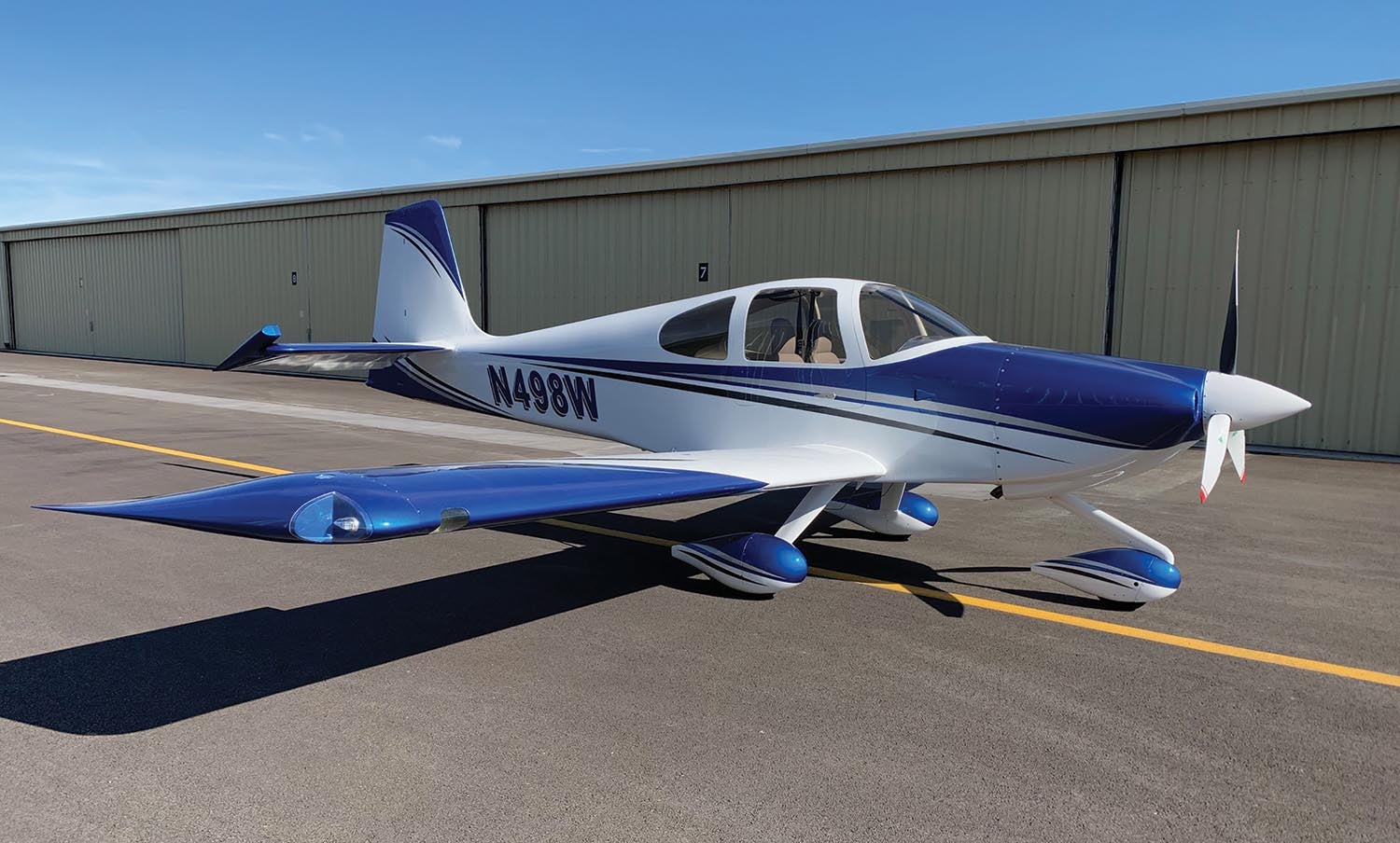

Following much the same concept is Show Planes’ RV-10 composite tail cone skin. If you know your RV-10s, you know that the upper cabin is a fiberglass shell that tapers down to meet an aluminum upper deck that forms part of the tail cone. There is a noticeable kink as the cabin transitions to the tail cone.
With the Show Planes modification, the top of the airplane has a constant taper from cabin top to the base of the vertical stabilizer, all made in composite (for structural reasons there are aluminum reinforcements under the skin).
