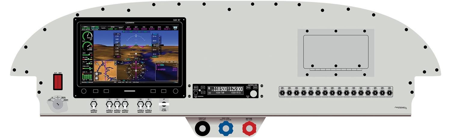

A light-VFR pre-wired panel will typically run somewhere in the low $20,000 range. The example came in at just under $22,000. It includes a single-screen Garmin G3X touch, a GTR 200 com radio with built-in intercom, a GPS 20A WAAS GPS receiver (VFR only for navigation purposes), a GTX 23 transponder with extended squitter (ADS-B compliant), and a 406 MHz ELT. In addition to the big items, it includes all related switches and circuit breakers, engine sensors, required antennas, and panel fabrication. The panel would come with all items programmed and ready to use.
To install this panel, you would need to bring your wires and antenna leads back to the panel to cannon plugs. Aerotronics includes pin-out diagrams to facilitate the wiring connections but no traditional schematics. This price includes a little over $7000 for wiring, fabrication, and testing of the panel. Thus, you could duplicate the panel yourself with your own labor and about $16,700 worth of equipment and other parts and material, based on current list prices. The difference in the cost numbers, besides the labor cost, is the $1700 worth of discounts passed on by Aerotronics. You may or may not be able to duplicate those on your own.

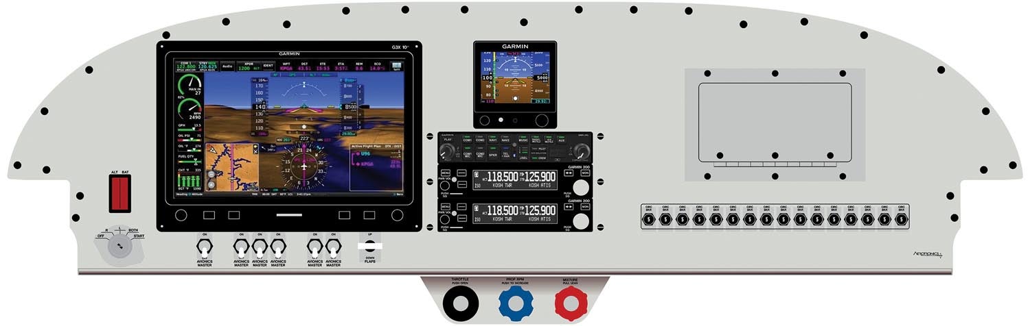

A standard-VFR panel as shown in the example will run a little over $28,000 complete. Admittedly, the idea of a “standard” VFR panel is a little hard to get your arms around because there is really no such thing as a standard panel in Experimental amateur-built aviation, but let’s just call this standard for the sake of this article. Our standard panel includes all items from the light-VFR panel plus the following: a second com radio, an audio panel, a Garmin G5 backup primary flight display (PFD), and a two-axis autopilot. Aerotronics has included about $2200 in discounts in this price.
For about $2500 more, the G5 could be dropped and replaced with a second G3X screen, giving you a dual-screen G3X VFR panel ready to install in your plane for about $31,000. This panel would have a lot of capability, but it would not be legal to fly IFR with it because of the non-approved GPS receiver.

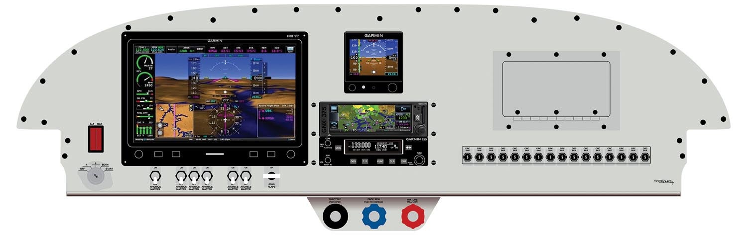

A light-IFR panel, one that meets all of the legal requirements but is not exactly loaded with the latest goodies, will come in somewhere in the mid-$30,000 range for a pre-wired panel. The example shown was priced out at $35,500. It includes a single-screen Garmin G3X and a single com radio. Backup instruments are provided by a Garmin G5. A transponder meeting upcoming ADS-B requirements, one GTR 20 remote com radio, one GNC 255A nav/com, heated pitot tube, a 406 ELT, two-axis autopilot, engine sensors, and the usual switches and circuit breakers round out the package with one important addition, a Garmin GNX 375 IFR-approved GPS navigator. This $8000 item makes this panel IFR legal. If you deducted Aerotronics’ labor and paid list price for all of the components, you could build this panel yourself for about $31,000. You may be able to beat that price if you can get some discounts on the equipment you buy. Of course, you can always save money by substituting some less expensive items in some cases or simply eliminating things like the nav/com or the autopilot.

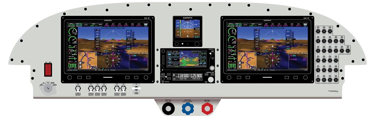

For the standard-IFR panel, we will upgrade to a dual-screen G3X and we replace the GNC 255A nav/com and the GNX 375 with a GTN 650 nav/com/GPS. We keep the G5 as a backup in this example. This panel pre-wired comes in at just under $43,000. Wiring and fabrication contributes $11,000 to the cost of building this panel, but that is partly offset by $5000 in discounts on equipment, leaving you with a cost to build the panel yourself, assuming you paid list price for the equipment, of $37,000. You could substitute the big-screen GTN 750 for the GTN 650 at an added cost of around $5000. On the other hand, there are ample opportunities to reduce the price with substitutions or deletions.
To be fair, it is not hard to save money off the list price of most of this equipment, especially on the pricey items such as the GTN 650 and 750. However, achieving all of the discounts offered in a pre-wired panel package may not be possible. There is also the matter of doing the work yourself. If you have experience with electronic assembly and fabrication, this may not be that hard; but if you have never done this before, expect to encounter a significant learning curve as you work your way through the process.
