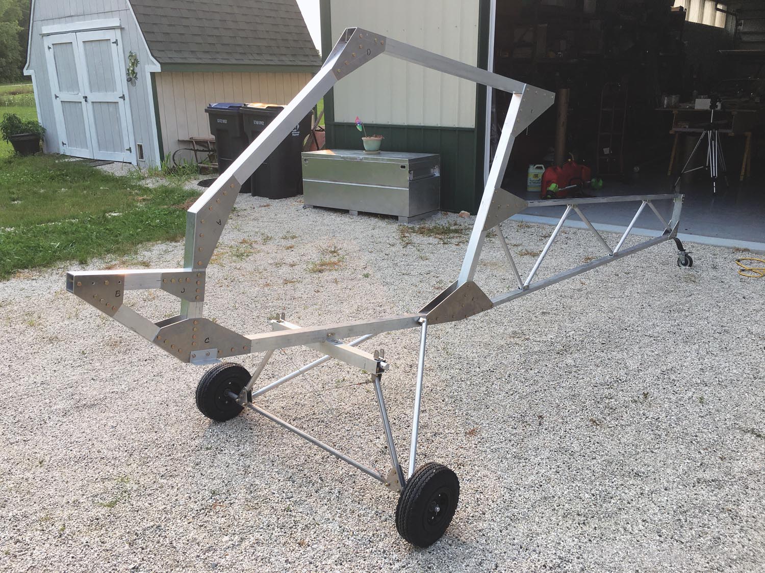

Gussets are bolted together on both sides of a 2×2-inch square aluminum tube.

The fuselage is constructed on a table.
A full-size layout is drawn on the table prior to assembly.
