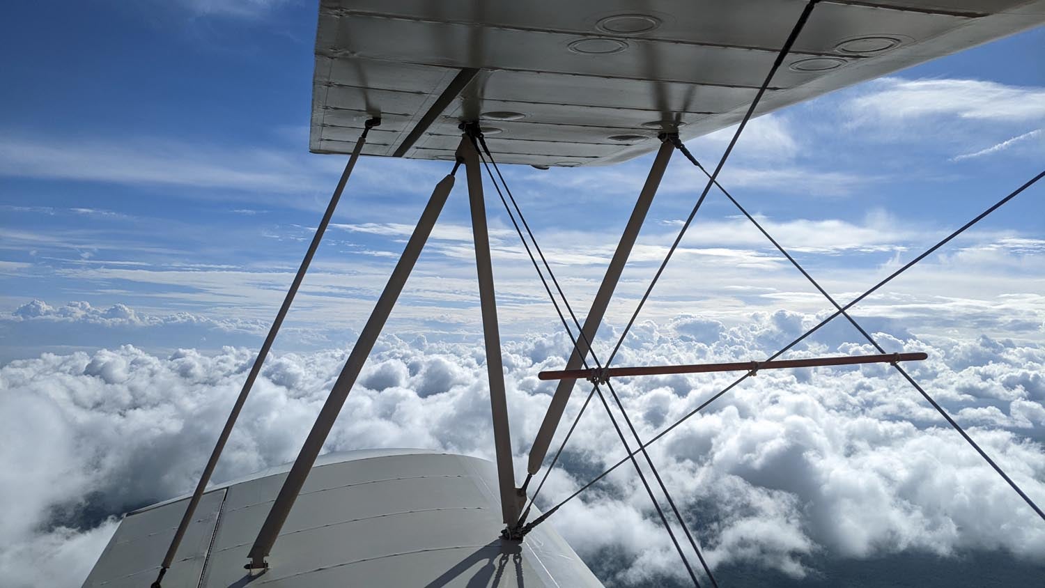

It is likely that the cost of streamline wires was what led Gus Mihlebach, the builder of my Hatz biplane, to use cables (properly called “wire rope”) with swaged eyes and turnbuckles instead of streamline wires (which are properly termed “tie-rods”). Today’s turnbuckle prices might change the equation somewhat compared to 1987 when my plane was built and surplus hardware was more available, but still, cost-conscious builders are always looking for alternatives.
When I bought the plane a few years ago, people said the extra drag of round cables would cost me anywhere from 5 to 15 mph airspeed at any particular power setting, though nobody had any real data to back it up. I didn’t really care. Certainly my plane is no speed demon, but for a pilot whose goal is to go fast, a biplane probably isn’t the best choice anyway. When the question of cables versus streamline wires came up again recently on the Homebuilt Airplanes Forum, I was motivated to look into the details. The first thing to consider was the strength of the substituted wires. I had never done any analysis, trusting that Gus (who was an engineer like myself) had done the appropriate analysis when making the substitution, and the hundreds of hours of flight time the plane had accumulated tended to bear that out.

There is some question about the use of swaged (Nicopress) sleeves on 1×19 cable, and the MS51844 spec for the sleeves only mentions their use on the 84320 flexible cable. Some say to use two sleeves on 1×19 cable. In the old days Nicopress sleeves didn’t exist, and my 1940 book on aircraft maintenance details how to make eyes by wrapping with soft steel wire and soldering (flexible cables were normally terminated with a five-tuck woven splice covered with shellacked thread). On my plane, Gus used a single Nicopress sleeve on each cable end and followed them up with wire wrap and solder in the old way, so I’m not too concerned about the strength.
PXL 20230906 211342333
A combination of old and new: modern Nicopress sleeves on the author’s Hatz backed up with traditional wire wrap and solder splices. Turnbuckles provide the required adjustability. Some touch-up painting of the lug is on the “to do” list.”

Streamline wires certainly reduce drag, but because of their higher cost, many Experimental biplanes have been built with less expensive round cables. (Photo: Theresa Press)
