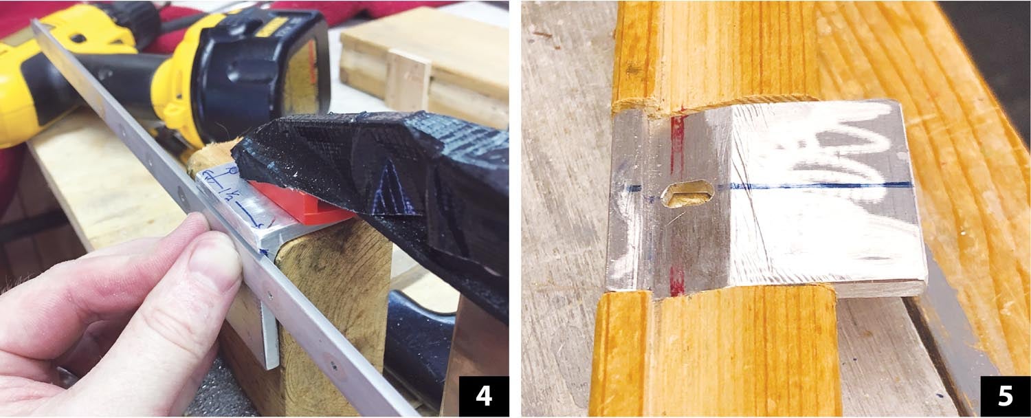

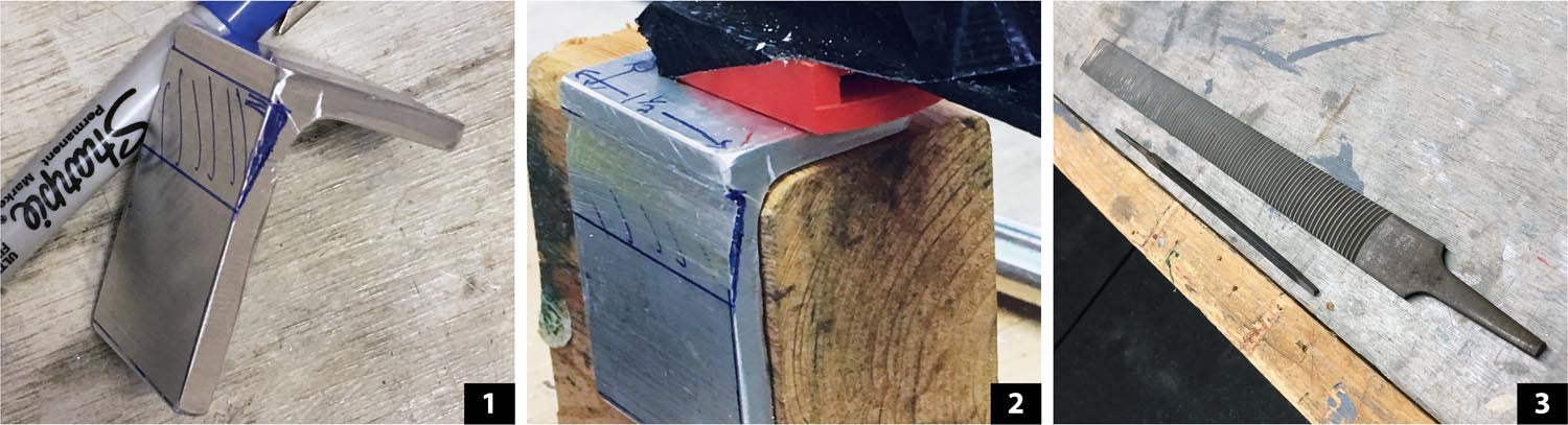

Using the AEX wedge as a guide, start off by marking the wedge outline on your scrap piece of aluminum angle (Image 1).wedge issue 02
Secure the workpiece and then begin working the shape with a set of files (Image 2). I used a small Nicholson triangular file and a Vixen file (Image 3). Be sure to check the AEX against the piece of angle (Image 4). After about an hour and a half, you’ll get the desired shape.wedge issue 03
Since I used scrap angle, I needed some way to make the plate sit perpendicular to the drill press. I decided to mount it to a wood block. I ripped a 2×4 lengthwise and routed a channel that matched the wedge profile (Image 5).
I created the channel in the wood using a router and router table. If you use this method, know that I also supported the back of the wood with some AEX wedge to keep the angle correct during the cut (Image 6 and 7). If you don’t have access to a router, I’m sure the task can be accomplished using a variety of wood tools (chisel, Dremel, wood rasps, sandpaper, etc.). It’s not important that this channel is hyper-accurate; it’s just there to keep the AEX wedge aligned.wedge issue 04

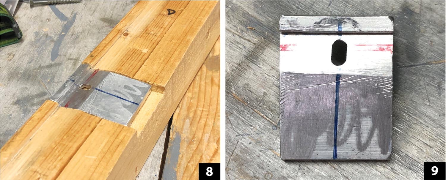

Next, notch out a recess for the metal jig in the wood so that the jig top is flush to the wood face and the channel on the jig lines up with the channel on the wood (Image 8). Additionally, the countersink point requires a recess in the jig, so I fashioned that in both the jig and the wood.wedge issue 05

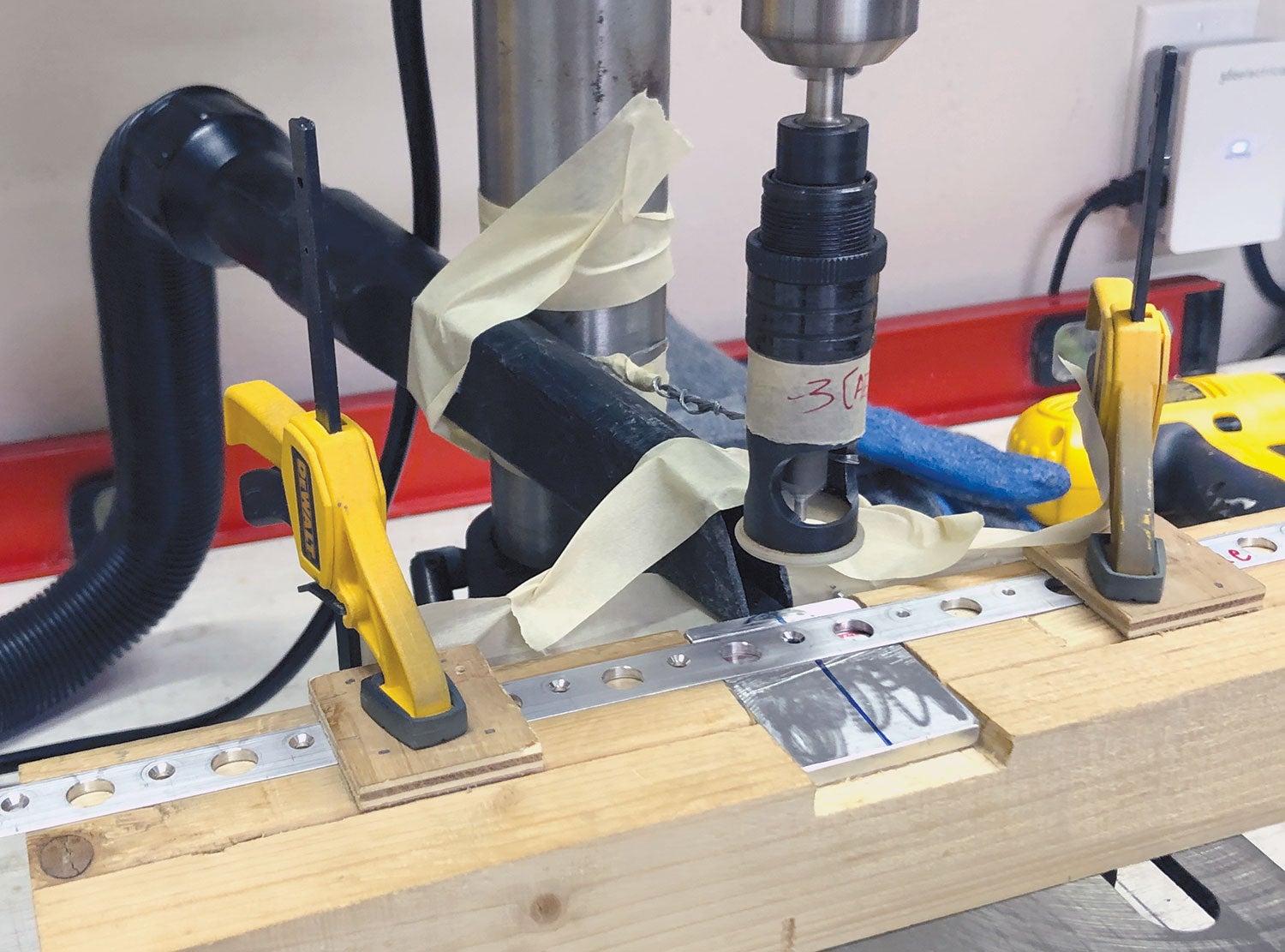

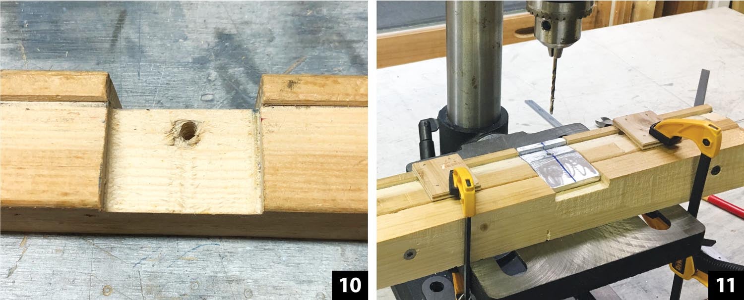

You can also see in Image 8 that, after flattening some of the surfaces on a belt sander, I attached the second half of the 2×4 back with screws. I then drilled a few holes in the jig and mounted it with screws to the wood (Image 9 and 10).wedge issue 06
Finally, I attached two small pieces of wood to help hold the wedge in the channel. I was then ready to begin drilling holes in the AEX wedge (Image 11), followed by countersinking.
