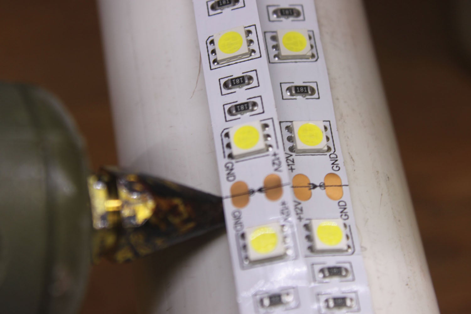

After my success in lighting the parts cabinets and shipping bench, I had a spare roll of strip lights and decided that the back part of my bench was very poorly lit and that it might just be necessary to light it up. This is where the versatility of strip lighting connections comes into play. Strip lights can be cut at 2-inch intervals, and the remaining part of the strip is usable because copper pads are placed every 2 inches. Cut in half, they are very solderable. The workbench now has very adequate lighting.

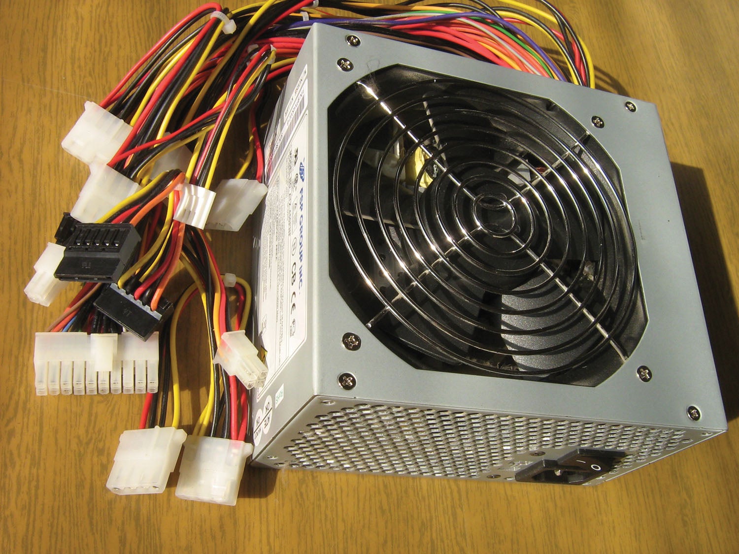

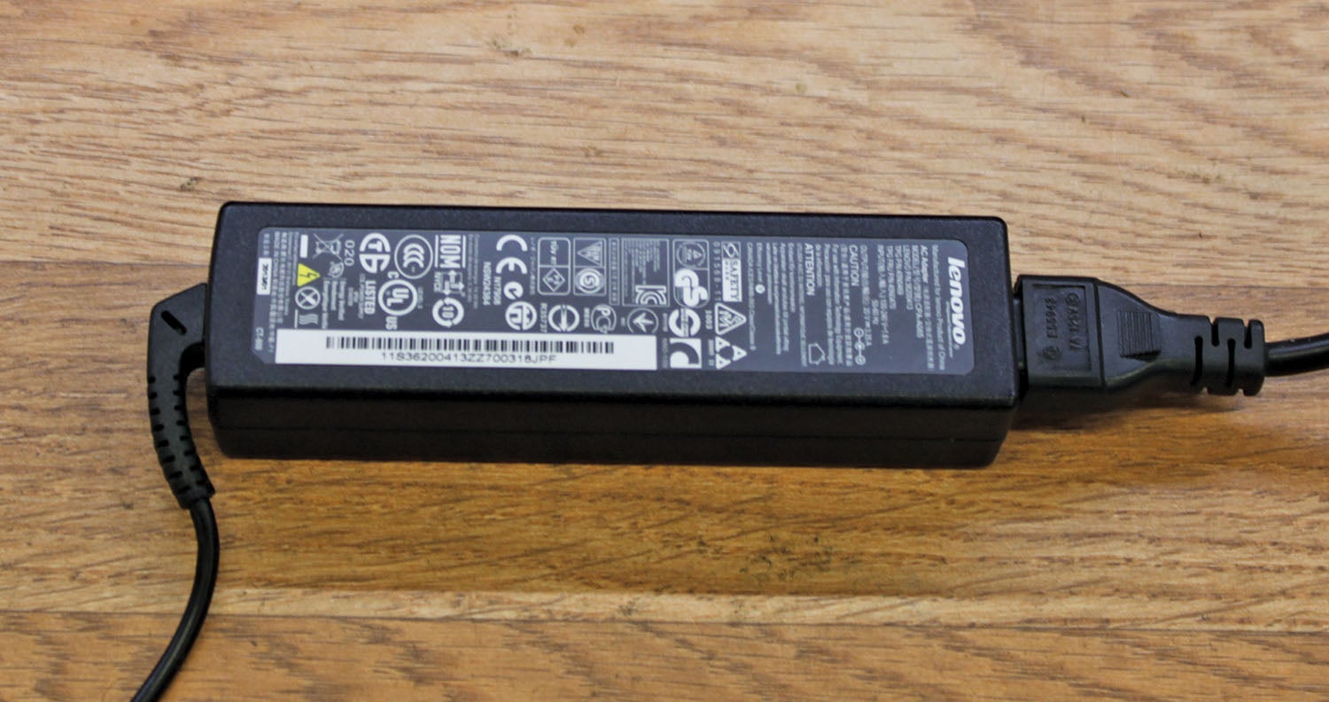

Now let’s turn our attention to a power source for these strips. Certainly the little wall warts I used are available, but for a whole shop/hangar you might want to consider the little enclosed regulated supplies.
Something else to consider are these little laptop computer power supplies that are a dime a dozen on the used “surplus” market. You might also want to consider finding a 12-volt junked desktop computer supply and modifying it like this:
These strip lights have a glue backing, but the glue is horrible—no stick whatsoever to either PVC or wood. Get out the hot glue gun and glue them down every couple of inches.
