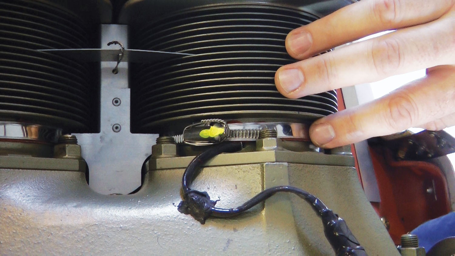

A better strategy is to use the small electric heat pads that attach directly to your engine’s oil sump and block. Browsing your favorite aviation accessory catalog will show products designed for this purpose. This method of heating transfers just the right amount of heat energy directly to your engine’s block and oil system. Typical energy usage with this type of heating is just a few hundred watts (rather than the 1000 watts of a typical space heater). The longer these preheaters are left on, the higher the engine’s temperature is raised—up to a point. By taking temperature measurements after installation on your engine, you can predict how many hours are needed for a given temperature rise.HeaterO200
A popular preheater design (www.reiffpreheat.com) has heating elements embedded in long hose clamps that wrap around each of the engine’s cylinders. This makes installation easy and heat is distributed exactly where it is needed. Another heating strip gets epoxied to the oil sump. This is an example of a preheater design that does not require disassembly of engine components like some designs require.
