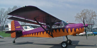

The volunteers planned to build a Zenith 701 during the six days of Sun ‘n Fun, from a kit purchased by one of the workshop members. DSC00431 1When the aircraft is completed (and dubbed Angel 1), it will be donated to a missionary organization. Several tool companies, including Avery, provided some metal-working tools, but the construction is being undertaken by the workshop volunteers and the folks who come to learn basic metal skills—no company participation. The plan is to build as much as possible during the show, and then complete it at the owner’s home airport in Mississippi.
The 701 was well underway by the time I wandered into the air-conditioned workshop this morning, with a good portion of the fuselage having been riveted, and with a wing and a horizontal stabilizer laid out on the other tables. Under Hoak’s supervision, the horizontal stab has been reworked several times until the measurements were as called out in Zenith’s plans—a copy of which was prominent at each work station.
