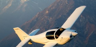

It looks like an airplane, it wins NASA airplane efficiency contests, and it’s a sweet-flying machine. But it’s not an airplane—it’s a self-launching glider. And even if your medical has been revoked or denied—something that would disqualify you from flying as a Sport Pilot under Light Sport Aircraft rules—you can still cruise at 147 knots. Do I have your attention yet?
The aircraft from Pipistrel is called the Virus, and it is carbon fiber, high wing, with full-span flaperons, optional speed brakes (spoilers, if you will) and an 80-horsepower Rotax 912 up front. The Virus comes with either a 40-foot wingspan or a 36-foot span, but the 100-hp Rotax 912S is optional only on the short-wing (SW) version. The SW fuselage looks the same, but has more internal structure for the higher speeds.
pipi sleeklines
Look at those sleek lines, stem to stern. Add an 11.3:1 high-aspect-ratio wing, and high efficiency must be the result.
Big brother Sinus has a 49-foot (15 meter) wingspan, along with the 80-hp Rotax. All can be either nosewheel or tailwheel and can be factory-built or Experimental/Amateur-Built as either a standard airplane or a glider. Cruise speeds range from 115 knots for the 80-hp Sinus to 147 knots for the Virus SW with the 912S.
