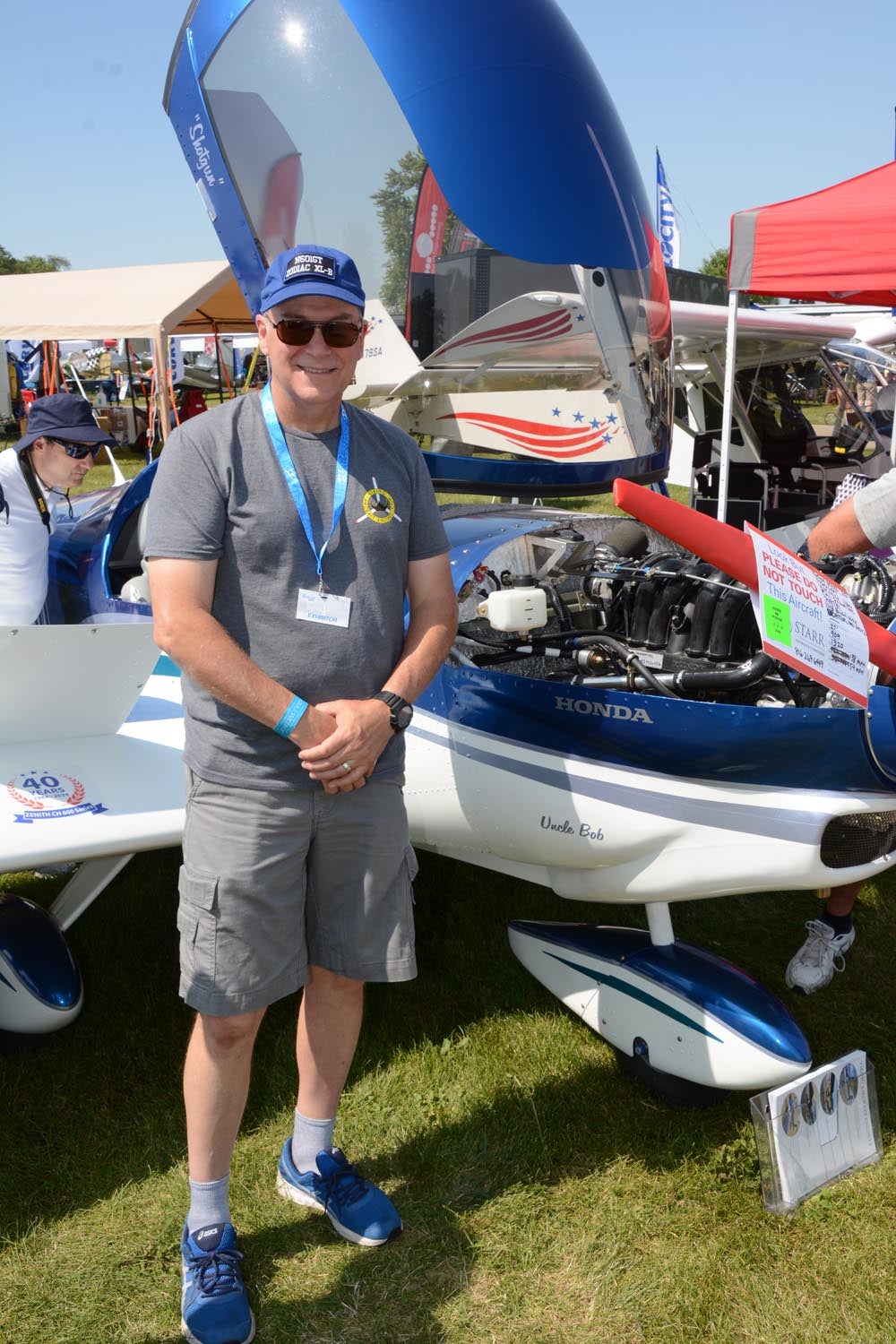

Phil Schmidt and his recently completed Zodiac 601XL.
Otherwise, given all the obsessive attention to detail and unicorn sightings at AirVenture it’s sometimes difficult to remember there are legions of great personal airplanes and their owners forming the conventions backbone. Phil Schmidt and his Zodiac 601XL are a fine example.
Phil hails from Belton, Missouri and has his spiffy Zodiac in the Viking Engines booth, the better to show off his Viking 130 installation. No points for guessing Phil is ready to gush about his Honda-based engine, noting he cruises at 138 mph at 4.5 gph of mogas, lands at just 54 mph and has had a mechanically trouble-free experience in the 120 hours so far on engine and airframe.
A retired graphic artist now specializing in aviation watercolors, Phil is not the typical gear head. “I’m not an engine guy,” he exclaims, but found the engine install easy enough using Viking’s online video tutorials. More on his own Phil taught himself vinyl wrapping while clothing his Zenith in its smart blue and white livery.

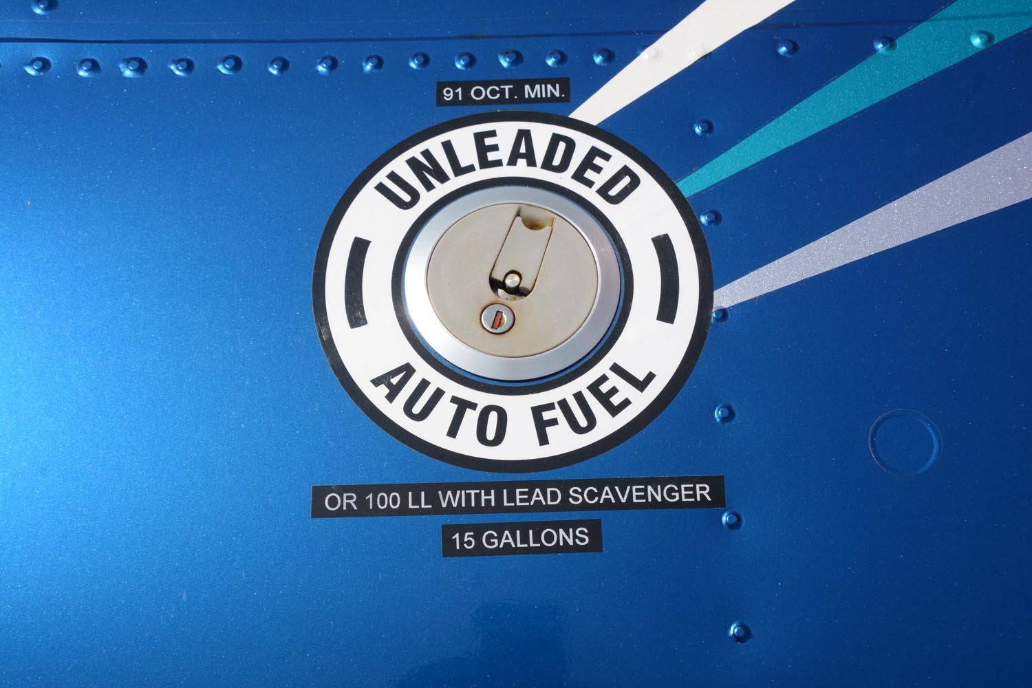

Premium mogas is a practical cost saver when flying locally; on cross countries Phil has the option of burning 100LL.
Now that Phil’s Zenith is out of phase one testing, the Viking 130 has settled into its normal maintenance regime of 50 hour oil changes (any 0-20W will do says Viking) and 25 hours oil changes in the gearbox. Mobil 1 is a preferred gearbox lube for Viking, who likes that lube’s minimal foaming qualities.
