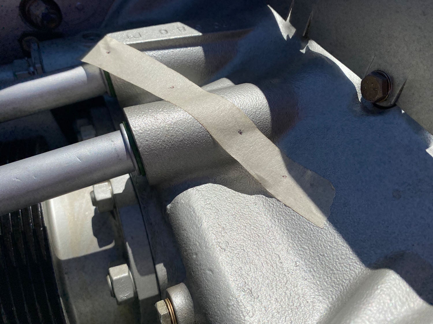

The path of the oil drops from the oil pressure regulator fitting to the forward and middle of the engine.
At this point, Vic Babyak decided that the term “Experimental” really meant something. He pulled the top cowling to investigate and noted faint oil leakage from the oil pressure regulator valve located on the top of the right side of the engine. The micro leak from this valve had nothing to do with CHTs, but the faint trace of small droplets from the point of the leak traced in an odd path. Rather than flowing to the back of the baffling, as would be expected, they traced forward and towards the centerline of the engine. Vic followed his instinct, that told him to force the airflow from the top of the engine down between the 1 and 3 cylinders. He fabricated a simple baffle wall down the centerline of the engine (right at the case split) to accomplish that goal.

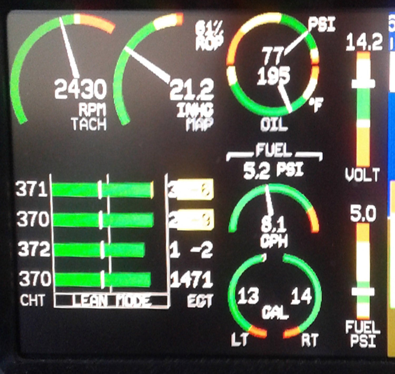

cht spread
CHTs after the fix.
It worked like a charm. The right side CHT readings are almost identical to the right side. For a couple of dollars worth of left over .035 aluminum and baffle seal, the engine is perfectly temperature balanced. Vic’s 8A is on display in front of Hangar B at the JB engines tent.
IMG 5673
The fix, an engine centerline baffle.
