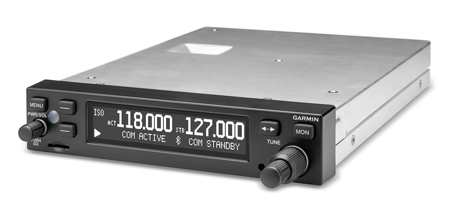

GTR 200B quarter angle
Designed specifically for Experimentals, Garmin’s Bluetooth-enabled GTR 200B com radio has 25 kHz channel spacing and includes a built-in intercom. (Photo: courtesy of Garmin)

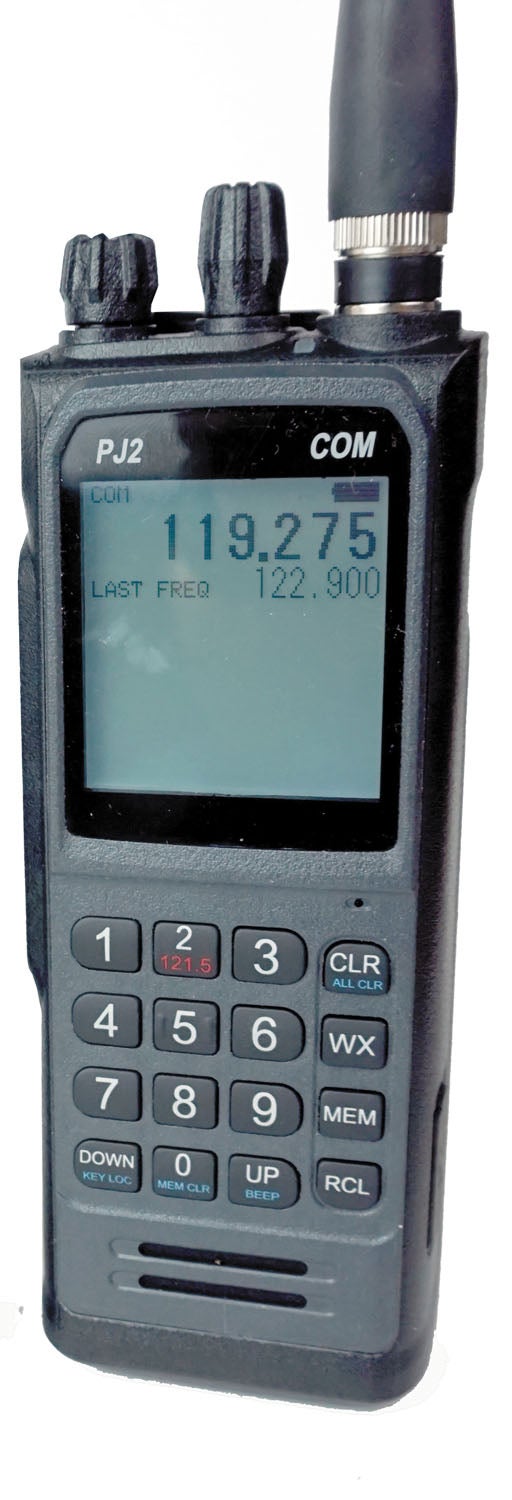

SP400PJ2
Beware of traveling with your handheld—they aren’t legal in some countries. (Photo: courtesy of Sporty’s Pilot Shop)

One last note that came to me from a newsgroup recently: Some countries prohibit even a receiver on the aircraft band to be in your possession. One fellow traveling to Greece faced 25 years in the slammer until diplomatic channels pulled him out. Beware of traveling with your handheld.
