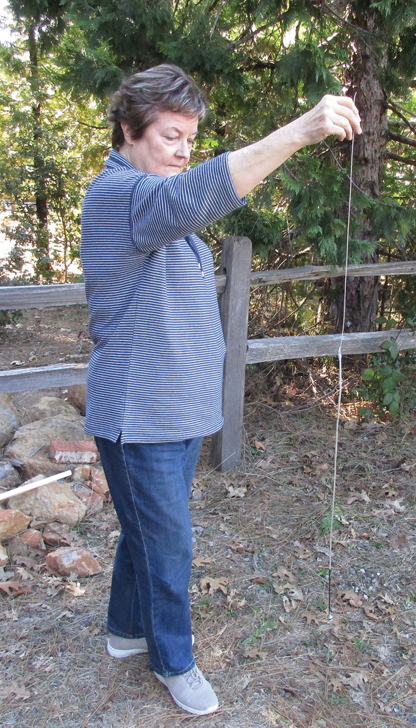

The coax vertical (right). It is nearly invisible both in the photo and in actual use. It makes a great stealth antenna.
Since this first antenna is going to be shirt-pocket small, we are going to make it out of coax cable shirt-pocket small: RG-174, my coax of choice for anything below 1000 MHz and 10 feet of run. At the com band frequencies it has a loss of 1.5 dB per 10 feet, or a power loss of about 20% for 10 feet. If this is not acceptable, you can use RG-58 with a loss of 10% for 10 feet. Same construction technique.
I’m going to take a length of RG-174 coax 72 inches long and a piece of RG-58 24 inches long. Strip 22 inches of the outer black insulation off of the RG-174. Strip all of the outer black insulation off of the RG-58. Cut all but 1 inch of the braid at the remaining black RG-174 insulation. Peel all of the braid from the RG-58, slip it over the black insulation of the RG-174 and solder it to the short 1 inch of braid remaining on the RG-174. Solder the two braids together.
Install a BNC connector onto the 2 feet of coax remaining and tune as described in the second to last paragraph. You can attach the tuned RG-58 antenna braid to the RG-174 black insulation by shrink sleeving or the homebuilder’s perennial favorite adhesive—hot glue.
The advantage to this antenna is that you don’t have to run the coax away from the antenna for a quarter of a wave like you do with a vertical dipole. The disadvantage is that it is relatively fragile and somewhat susceptible to contamination with water and other pollutants over time. It is also a bit more sensitive to being located close to the earth—it likes to be high up.

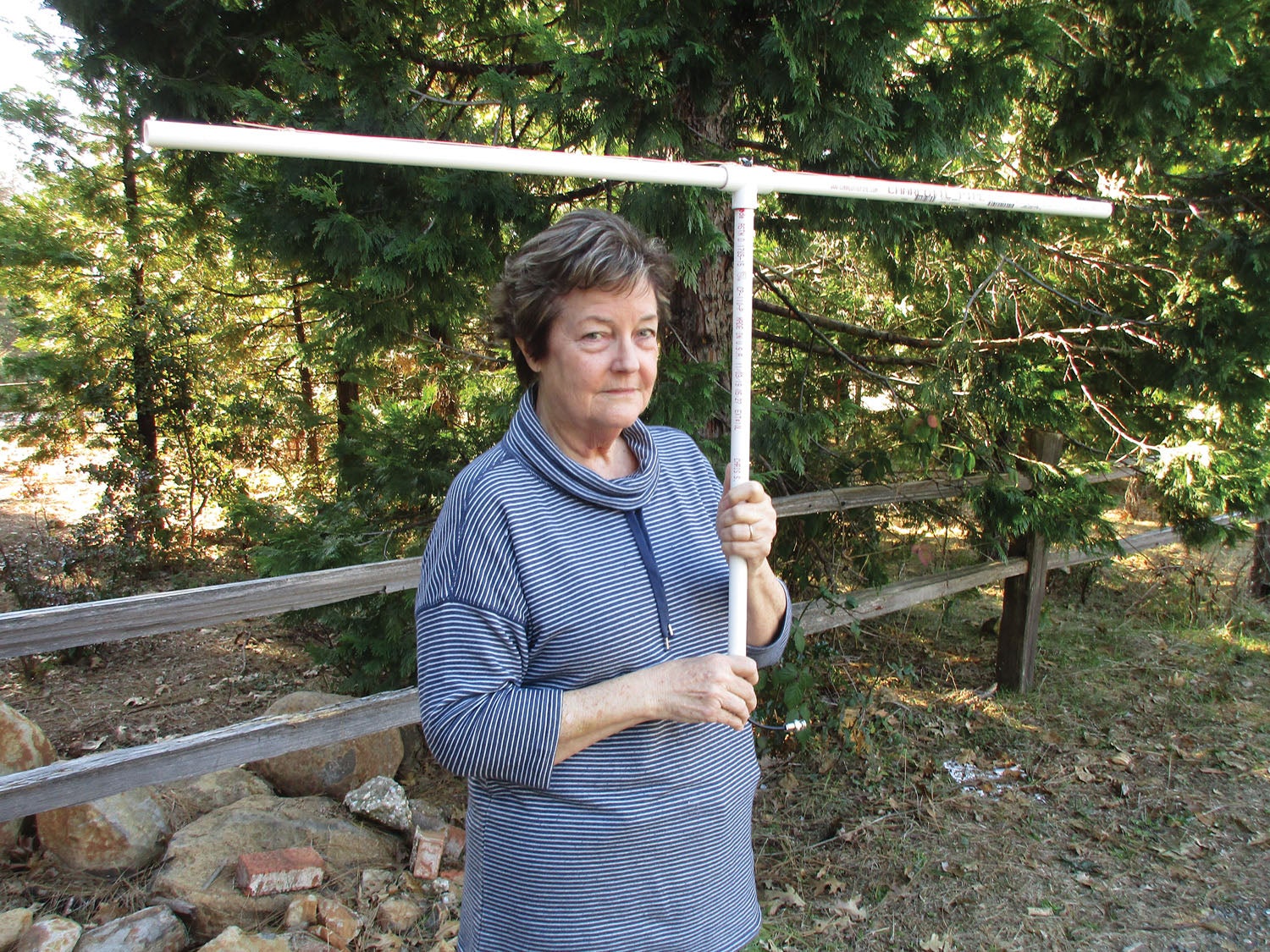

The alternative is a true vertical dipole with an arm that keeps the feed line away from the antenna. This one is made out of ¾-inch PVC water pipe and Romex house wiring for elements. The cost of making this antenna is 10 times that of the shirt-pocket antenna: $0.10 for the shirt antenna and almost (gasp) a dollar for this one.
aerolectrics 0621 03
The PVC vertical. Cyndi is holding it horizontally for the picture, but in use it must be held vertical. Note the short stub of coax coming out of the arm by Cyndi’s right hand.
Please note…I’ve shown this design on PVC water pipe, which is what I had in the lab to work with. Cardboard? Plastics? Plywood? Any insulator? Not a problem and no modification necessary.
As with the shirt-pocket antenna, the adhesive of choice to keep the wire onto the surface of the water pipe is hot glue, and the sealant to keep the coax from becoming contaminated is the same hot glue.
