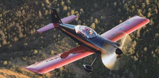

Headroom, front and back, is excellent in the RV-8, even with thick seat cushions. I settled into the back seat for the flight out of Chino, at the east end of the Los Angeles basin. Chino is certainly one of the world’s premier big boys’ toys airports, with everything imaginable on the ramp or in a hangar.
Backseat Boys
As we taxied out with the canopy half open, it was breezy in the back seat. I watched an orange-bellied hawk sit on the PAPI (precision approach path indicator), and observed a ruptured blue helium balloon slowly fluttering down from a clear sky. The canopy came closed for runup, and then we were off .
Klages’ RV-8 has a 180-hp Lycoming up front with a Hartzell constant-speed propeller. The -7 and -8 are approved for the 200-hp IO-360—and a few have been fitted with the nominally 210-hp IO-390, including Lycoming’s own RV8—but 180 hp got us moving and levitating in a most satisfactory manner. In the back seat were the optional throttle and rudder pedals. Those rudder “pedals” are about the size of silver dollars, just right for operating with your big toes. You can move your feet off the pedals into the wheel wells and be off the rudders and still comfortable, but there’s not a lot of wiggle room.
I’m a big fan of constant-speed props on RVs, because it is so satisfying to get full power anytime, whether for takeoff , climb or for fighting off induced drag when maneuvering aggressively. Not enough instruments were visible from the back seat to take climb performance measurements, but fleet experience easily validates Van’s claims of 1650 fpm at max-gross weight, 1900 fpm with the 200-hp engine.
During climbout, the RV-8 fishtailed in the light turbulence. It was obvious in the back seat, probably noticeable in the front, but not that big a deal for a short flight. An all-day flight in turbulence might be trying in the back for the weak-stomached. But this indicates a significant point about the RV-8—a major part of its mission is to be fun to fly in maneuvering flight, the celebrated yank and bank. If the RV-8 were too stable, it would be less enjoyable to fly. The -8 balances these needs better than most, providing sufficient stability that a glance down at a chart won’t result in untoward changes in attitude or altitude. Everything is a compromise; this is a good one.
Yank, Meet Bank
The only appropriate thing to do in a yank-and-bank airplane is to yank and bank. First order of business was a 3-G steep turn, and it was surprisingly easy to do from the back seat, even with obstructed views of the horizon and the instrument panel. I thought the pull on the stick was at the light end of the spectrum for this class of airplane. But to put this in perspective, this was done with two people onboard a tandem-seat aircraft . Although I didn’t get to solo the RV-8, indications are that the stick force and stability are well thought out and a solid compromise between solo and dual flight handling. It wasn’t until after the flight that I realized how much I appreciated having just a touch of pressure to work against in the gentle maneuvers, the 10, 20 and 30 banks. After all, most of the flight time in an RV will be spent, hate to say it, straight and level.
Next on the agenda was a slow build up in G forces to observe the stick force gradient. As we passed 3.5 G, there was a thump, as if we had hit something. Klages said that he seldom went to this G loading, but he had heard the thump once coming out of a loop. After the flight, I talked with Ken Krueger, chief engineer at Van’s Aircraft, who said that the thump was probably due to airflow at the root of the flap on the bottom of the fuselage, where “an underlapping >piece of skin” near the flaps and fuselage could make the noise. In any event, the thump seems to be rare in the fleet and an innocuous phenomenon.
Partial power shows interesting stall characteristics in many planes, so I tried one with 16 inches of manifold pressure. The stall was as you might expect for a sport plane—enough warning for the alert pilot, but not as benign as in, say, a Cessna. Klages’ plane liked to fall off on the left wing, but there was abundant control authority to make the plane do what you wanted it to, even lift ing the wing with aileron. Throughout all these maneuvers, and I think this is a key to the enthusiastic following that Van’s aircraft have, I seemed to have an intuitive feel for what the airplane was doing, was about to do, and what it could be made to do. Granted, I have 350 hours in the similar RV-4, but it was sold six years ago.

The RVs use Frise ailerons, hinged so that as the trailing edge of the aileron goes up, the leading edge extends down below the wing to add drag, reducing adverse aileron yaw. With full deflection, which requires putting your shoulder into it, you can get unstable airflow over the aileron and a nibbling at the control stick. Klages’ airplane showed this phenomenon, hardly a big deal, but he had never observed nor heard of this in his nearly 600 hours in the RV-8.
Another phenomenon seen on some RV-8s, especially those with aftermarket gear legs, is vibration of the horizontal tail during stalls. I’d never heard of this occurring with the stock gear legs, but it did on Klages’ aircraft . Krueger says that the factory is aware of this, but there is sufficient structure in the horizontal tail that it should not be a problem. As Krueger’s background includes work on the B-2 and F-22 structures, I’m inclined to believe him. There are aftermarket flow fences that fit on the fuselage, just above the wing leading edge and with similar curvature, which are said to resolve the situation. But as Krueger points out, the tail vibration does provide additional stall warning.
Doing stalls with full flaps and 19 inches of power, we saw everything— a ridiculously steep deck angle, a hard thump, tail vibration and falling off on the left wing. But so what? No pilot except a recent refugee from the proverbial clue-free zone should have problems with this.
With the test session completed, we returned to Chino for some landings. A big advantage of the constant-speed prop is that it allows the airplane to decelerate quickly. Add full flaps, and you can fly as steep a pattern as you like. In my old RV-4, slipping with full flaps was routine and easy. A measure of the handling was how easy it was to hold airspeed precisely, within 1 or 2 mph. I used to do that all the time in my RV-4, and Klages’ airspeed control was equally precise.
For whatever reason, Klages does not get the absolutely swerve-free landings he’d like. Maybe it was gear alignment, or maybe it was the tailwheel steering linkage. My hypothesis is that at speeds in the 40-50 mph range, when the rudder is still effective, and if the tailwheel is on the ground, there is a battle of control forces at the tail. If the rudder is deflected enough to get aerodynamic effectiveness, the solid linkage fitted to Klages’ airplane will deflect the tailwheel too much, whereas the stock springs with some slack in the chains will let you get some rudder deflection with no tailwheel deflection.
In any case, Klages’ landings were acceptable. Maybe it was because he could accomplish the rest of the flight with such great satisfaction that the minor landing anomalies were discomfiting to him.
