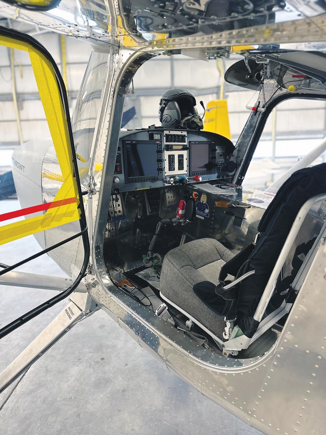

The fuselage will be “re-lofted” to widen it at the A pillars and to move the wing aft by 4 inches.

“That move of the wing changes the cabin structure and the ergonomics, which means the flap handle moves to the floor,” says Heap. He said the ceiling-mounted handle has been “performing very well” but the wing and fuselage changes will make the configuration unworkable. “The relationship of the wing and the tail is crucial for the handling and stability of the airplane. With the wing moving back, the tail follows it, which means the fuselage is going to get longer.” It has yet to be determined how much the tail cone will also be lengthened, increasing the distance from the wing trailing edge to the stabilator leading edge. Johnson told me that even with the current configuration there has been no evidence of tail blanking with flap deployment; moving the tail farther back should only make that less likely.
Moving the wing means reworking the fuselage. Van’s is taking the opportunity to “reloft” the fuse by widening it at the A pillars and moving the instrument panel up to create more knee- and legroom. “The goal is for more room for your legs and knees in the cabin,” says Heap. And depending on where the floor-mounted flap handle ends up—within easy reach, one assumes—moving the panel and engine instruments slightly makes total sense. Because the wing moves back and the firewall stays in place, the revised RV-15 will have a more sloped windscreen and raked A pillars. It will also have a standard V brace in the window, good for structural strength but crucial for anticipated float use.
While we’re still in the cabin, understand that Van’s has finalized that this will be a two-seat airplane with a large baggage hold, planned to carry 200 pounds of your stuff. Early talk about possible 2+2 configurations yielded to the realities of the fuselage taper making the back seat suitable only for the very small. Better, Van’s feels, to optimize the airplane for real-world use of carrying camping gear (including bicycles) and such rather than tiny humans.

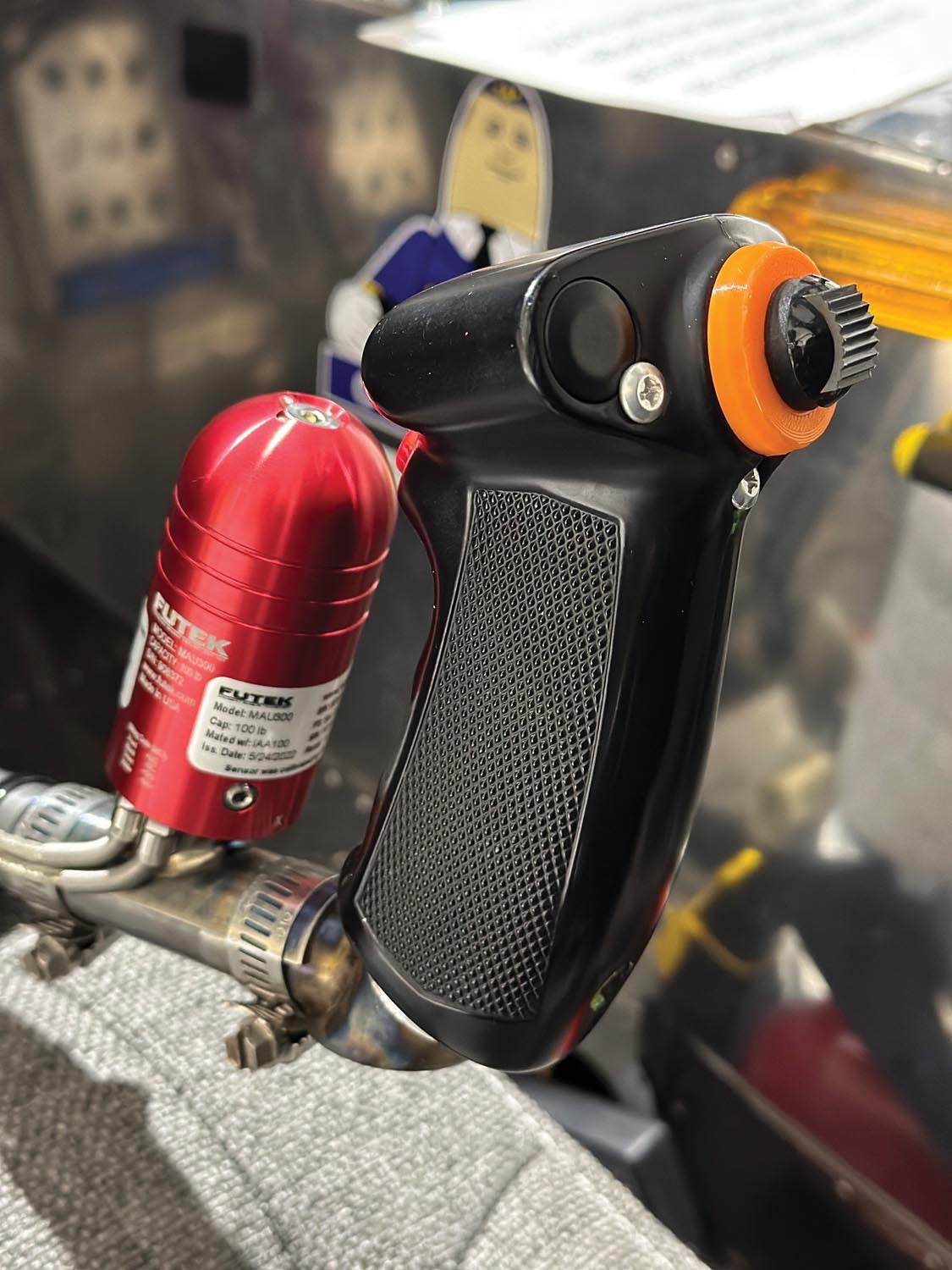

The red device is used to measure stick forces during flight test.
