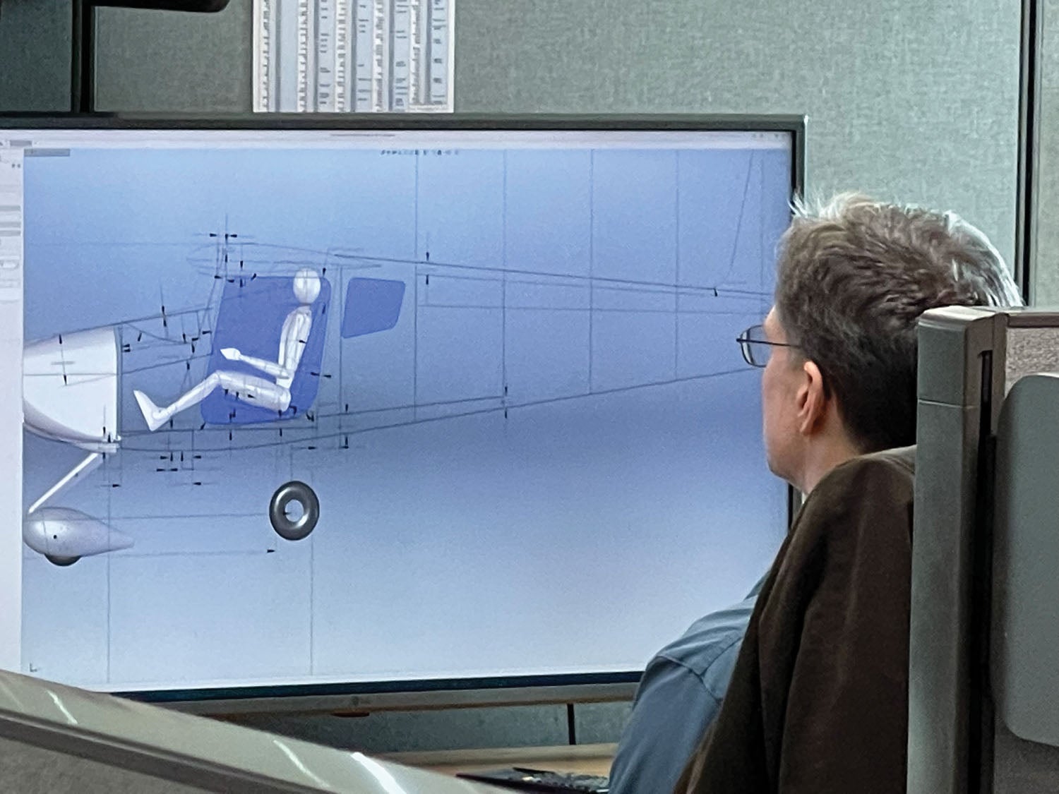

vans rv 15 kitplanes preview 01 e1658271053145
We see lots of CAD models of airplane proposals in the magazine business—it’s nice to see one with metal to back it up! The RV-15 was all designed in Van’s computers.

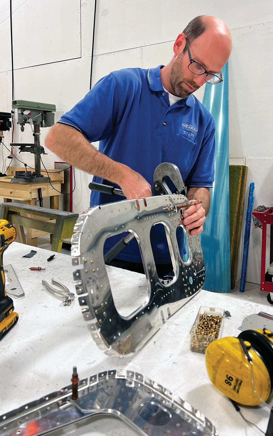

Built using CAD-designed parts and match-hole technology, the prototype was put together with parts produced from punch presses and CNC machines directly from design drawings. This was not cut and pasted by hand, as past prototypes have been—theoretically, production parts for kits can be produced from the same files that made the test article. But a lot of testing will go into the machine before the first customer receives any kit parts and Van’s is happy with the design.

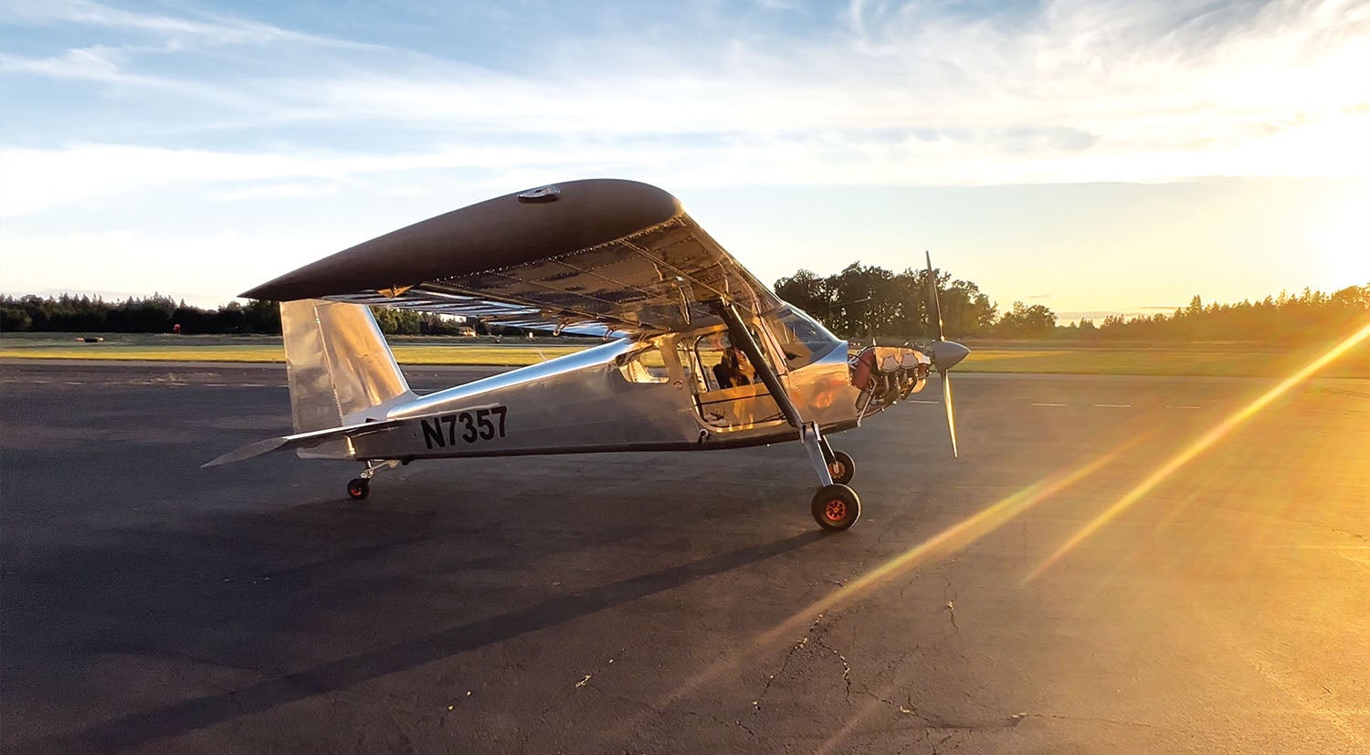

vans rv 15 kitplanes preview 21
Early in flight test, Van’s showed the RV-15 on 26-inch tires. It looks the part.

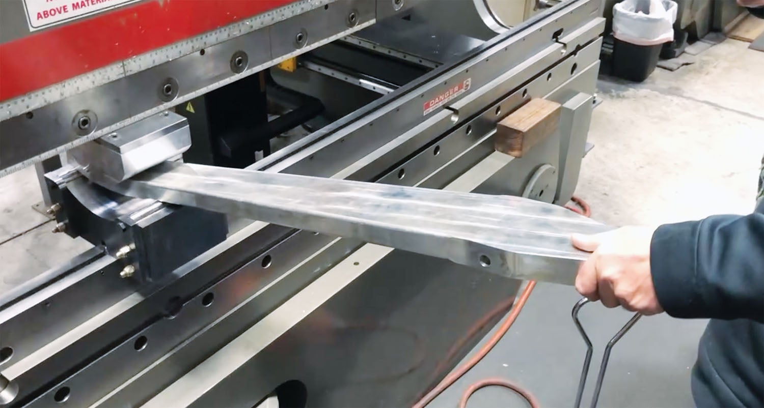

Let’s talk about the gear. Both the main gear and tailwheel are using TK 1 Shock Monster  shocks for their action—a proven brand out of Lincoln, California, that is equipping a large number of bush aircraft. The main gear is unlike anything Van’s has designed before, with two separate aluminum legs hinged at the lower corners of the fuselage. Part of the leg extends upward, above the hinge point, and is connected to the large shock absorbers that are oriented across the fuselage laterally and are sandwiched between the belly skin and the floorboards.
vans rv 15 kitplanes preview 04
The RV-15 landing gear is a clear departure for Van’s. CNC-machined legs (above) are bent in-house (below). In fact, the gear is a totally homegrown design aimed at providing long-stroke suspension and high strength but with low drag.

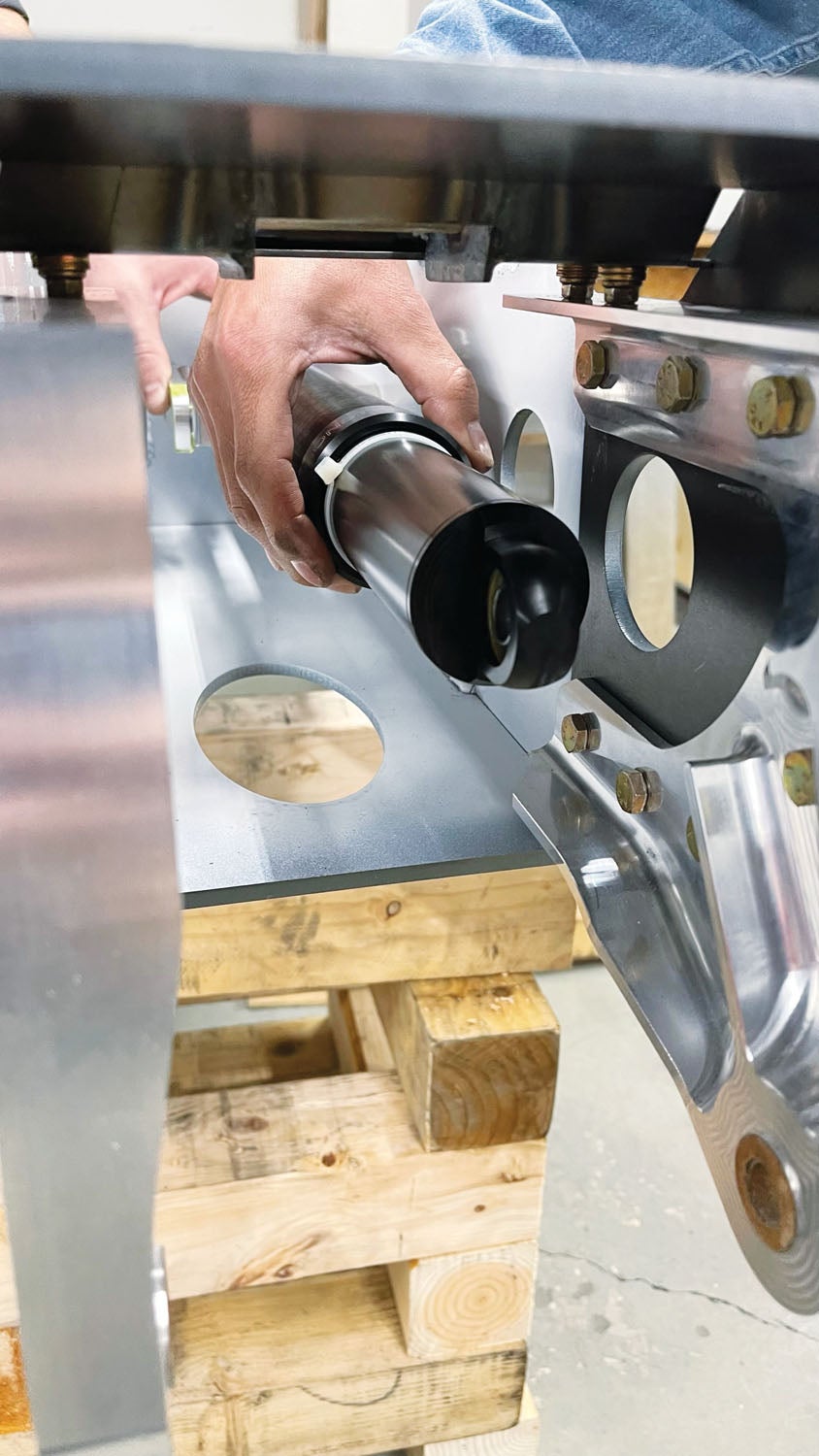

vans rv 15 kitplanes preview 20The shock absorbers will provide both spring and damper functions so that landing loads are absorbed without the plane being rebounded back into the air. The tailwheel is similarly sprung, with a vertically oriented shock absorber connected to a custom-CNC-machined pivot block that is mounted to an arm hinged to a point on the fuselage about 10 inches in front of the shock. The result is a long-travel gear that should be able to take quite a pounding, plus the linkage allows the tailwheel pivot to have constant camber even with a significant amount of travel.
vans rv 15 kitplanes preview 09
The air-shock system for the main gear is located horizontally in the belly of the airplane, allowing for long travel but with low drag.
Main gear is currently sporting 6.00×6 tires on Berringer wheels (and brakes). Current plans are to fly it on those, but they have a set of 26-inch bush wheels sitting in the shop for use on the plane—that is their default size for “bush wheels.” They have incorporated provisions for an easily installable jack point on the gear, inside of the axle, to make jacking easier.
