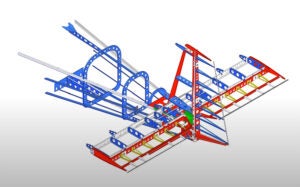

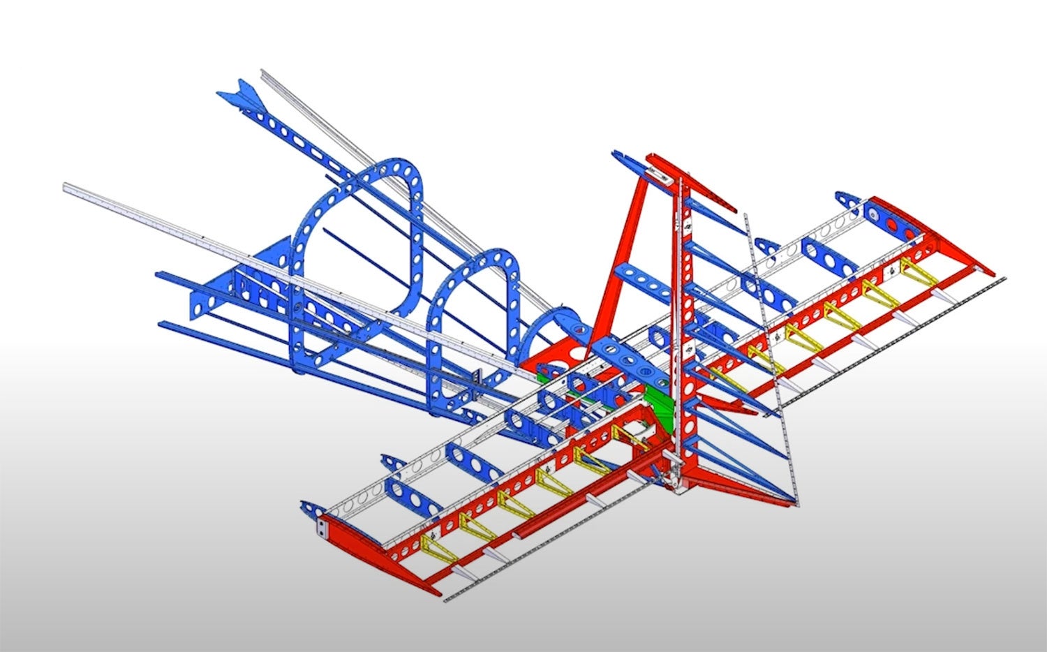

Van’s has continued to refine its listing of laser-cut parts used in various kits and has committed to replacing all “red and yellow” parts free of charge.
