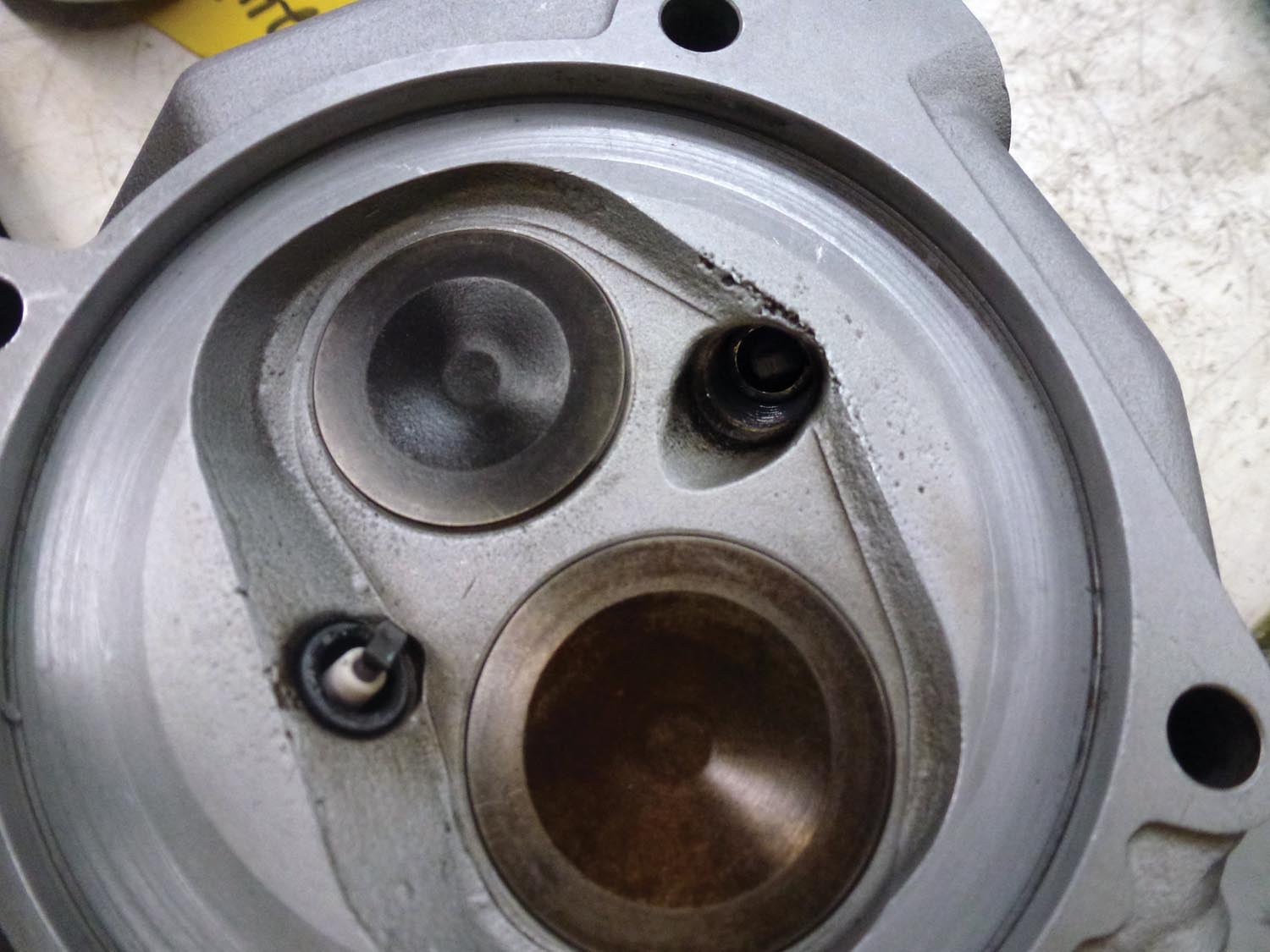

Developed for use with unleaded autogas, the Rotax four-strokes can run on 100LL but they pick up lead deposits that force a shortened oil-change interval.

One huge advantage is that the engine is designed to run on unleaded autogas. The Rotax will tolerate some use of 100LL, or you can use a fuel additive such as Decalin RunUp to help counter the lead in avgas, but this requires more frequent engine maintenance, not an ideal situation. Rotax owners are in a better place than those with high-compression legacy engines when it comes to an alternative to 100LL fuel. In fact, for the last eight years Lockwood has been running their engines exclusively on Swift’s 94-octane unleaded fuel—and the engines reportedly love it.

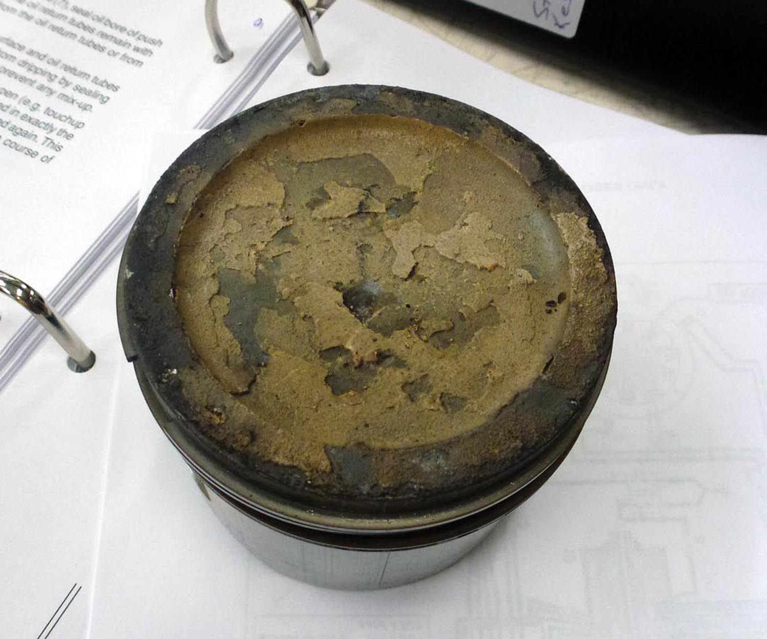

There are many damaged parts to be examined at the school. Learn from others’ mistakes.

When you don’t follow prescribed maintenance orders, bad things happen to engines. So long, Mr. Exhaust Valve.
The oil system was first, and this system was one Dean emphasized heavily and often came back to all four days. While you could suffer a complete failure of the cooling system for the cylinder heads and still fly a long time without having the engine seize, the high-revving engine and gearbox literally are bathed in and live or die by a healthy oil system. The dry-sump oil system allows a lower frontal area for the engine and a more compact installation resulting in less drag. The oil system is also one of the primary areas where the engine will be affected by running on 100LL. If used on avgas more than 30% of the time, Rotax reduces the oil-change interval from 100 hours to 50. You can see from some of the photos what lead buildup does to the engine.

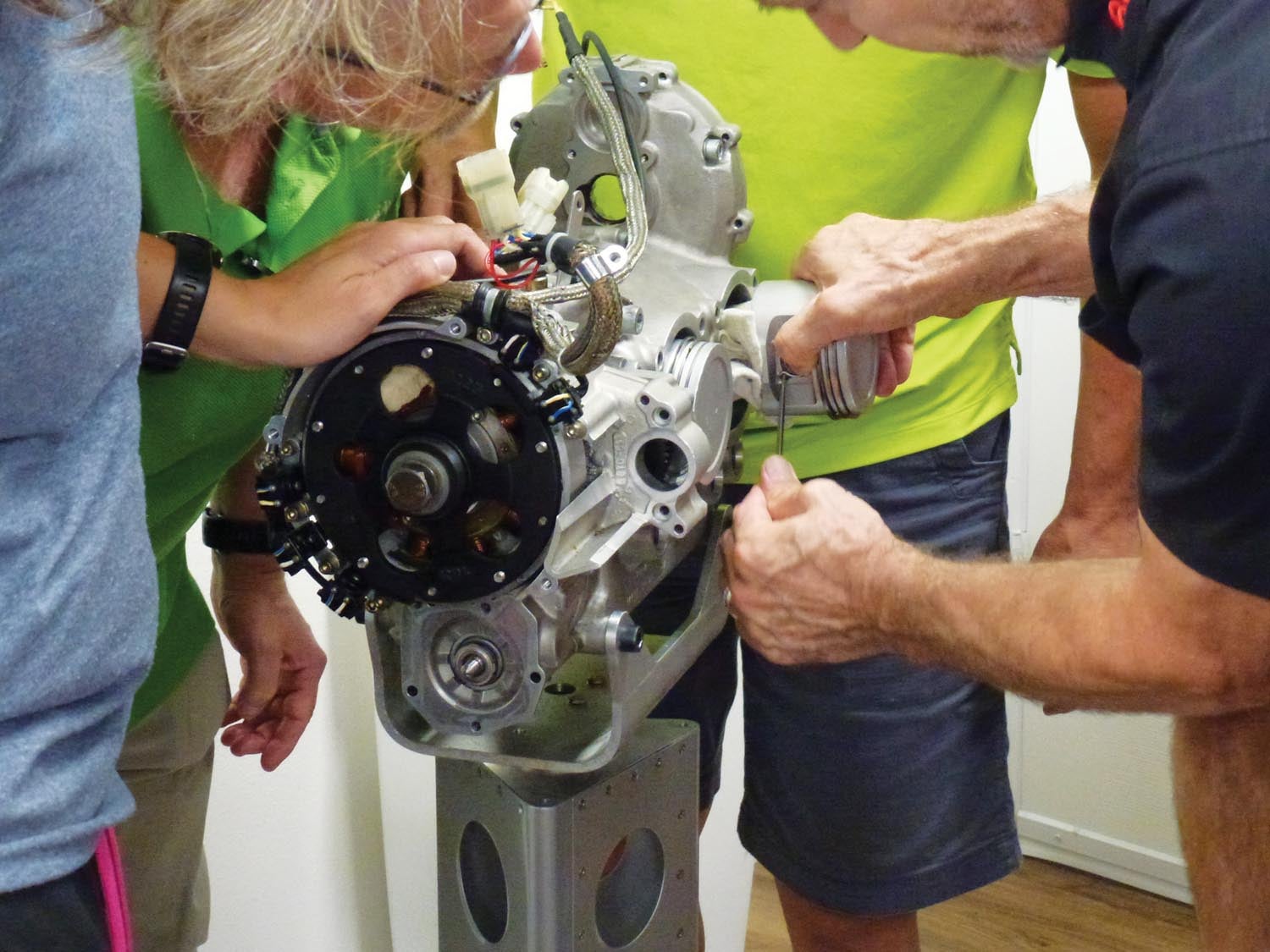

You can’t get more hands-on than tearing an engine completely apart.
Making Sparks
Another thing different about the engine is that there are no magnetos. Instead, the engine has a large flywheel that is a combination permanent-magnet generator and charging coil, and the timing is permanently set via the position of the trigger coils located just outside of the flywheel. Spark is triggered by a capacitive discharge system, and the plugs fire on what’s called a “wasted spark” system, which means they spark on every stroke, be it a compression or exhaust/intake. This may seem counterintuitive for efficiency, but it eliminates the complexity of timing of having the plug fire every other stroke. (This is also how common electronic ignitions for legacy engines work.)
The third day, as part of the maintenance course, we started off with Dean unrolling a tarp and asking us to try not to get oil on his carpeted floor. Laying out a bunch of tools, he pointed to an engine at the front of the classroom and said, “OK, you’re going to take this apart. Who’s first?” The day was spent dissecting the engine, laying the parts out on the table and giving us an intimate look at everything we had talked and read about during the first two days of the service course, with breaks as we examined the beauty of a finely designed and machined oil pump, for instance, and discussing the strengths and weakness of a particular system.
