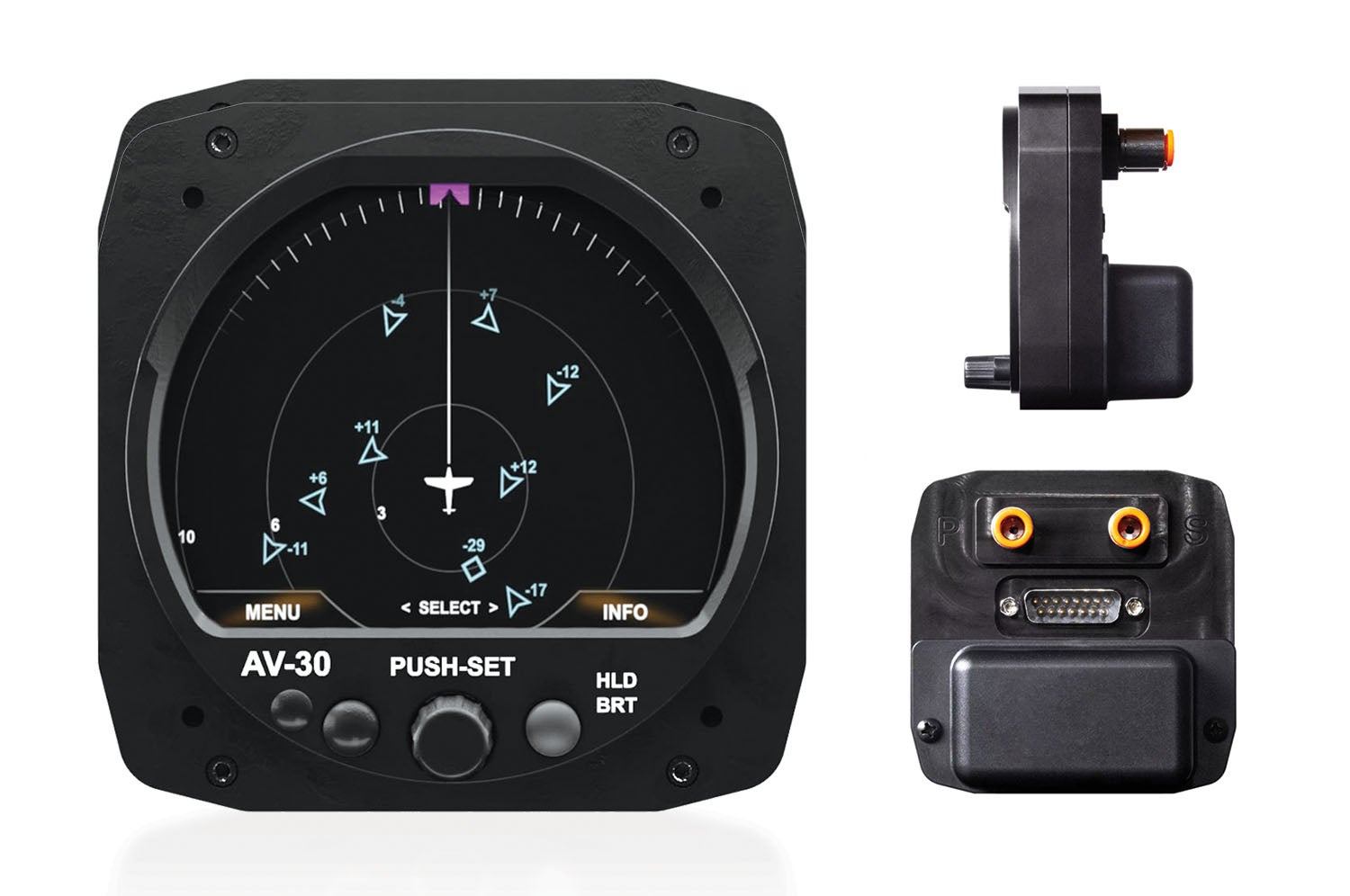

The AI and DG/HSI pages are largely unchanged with the newest software and retain their customizable data fields. The new MFD page, where traffic lives, is simpler, with one display orientation, a forward-facing arc with GPS track at the top. Traffic is displayed in cyan elongated triangles in conventional ways. The nose of the triangle is the traffic’s direction, a number indicates relative altitude—“+50” is 5000 feet above, for example—an up or down arrow indicates if the target is climbing or descending and a thin vector line tells you the relative speed of the target; the longer the line, the faster it’s moving. Pretty much standard traffic depiction.
Rotating the knob changes screen range, in eight steps from 1nm to 40nm. Pushing the knob activates the select function, which can be used to get details from traffic depicted on the screen. Turn the knob to move among the visible targets and the details will be shown along the top of the display. Under the MENU button is a filtering scheme where you can choose to limit the traffic shown on the screen. Five choices include Normal (traffic above and below no more than 2700 feet), Above, Below, Only Own (filters only your ownship marker as traffic), and None, which shows all traffic.
uAvionix AVLink
The AV-Link “dongle” connects directly to the back of the AV-30 and intercepts two RS-232 data ports as well as power and ground. It has built-in Wi-Fi.
In actual use, the AV-30 traffic option works well. It does become solely a traffic display, with no other attitude or navigation information presented, but that’s the right approach to keep screen clutter to a minimum. Since the AV-30 and AV-Link combo is taking traffic data from a Sentry module, what you see there and on your tablet running ForeFlight agree. And while the AV-30’s screen is bright, the resolution isn’t anywhere close to a modern tablet, but the presentation succeeds in giving you the big picture. One feature currently missing from the AV-30’s traffic scheme is an alert function. We’ve become accustomed to our onboard boxes or our tablet apps sending up a warning when traffic gets close; the AV-30 doesn’t yet do that, though it’s not hard to imagine this feature will come eventually.
