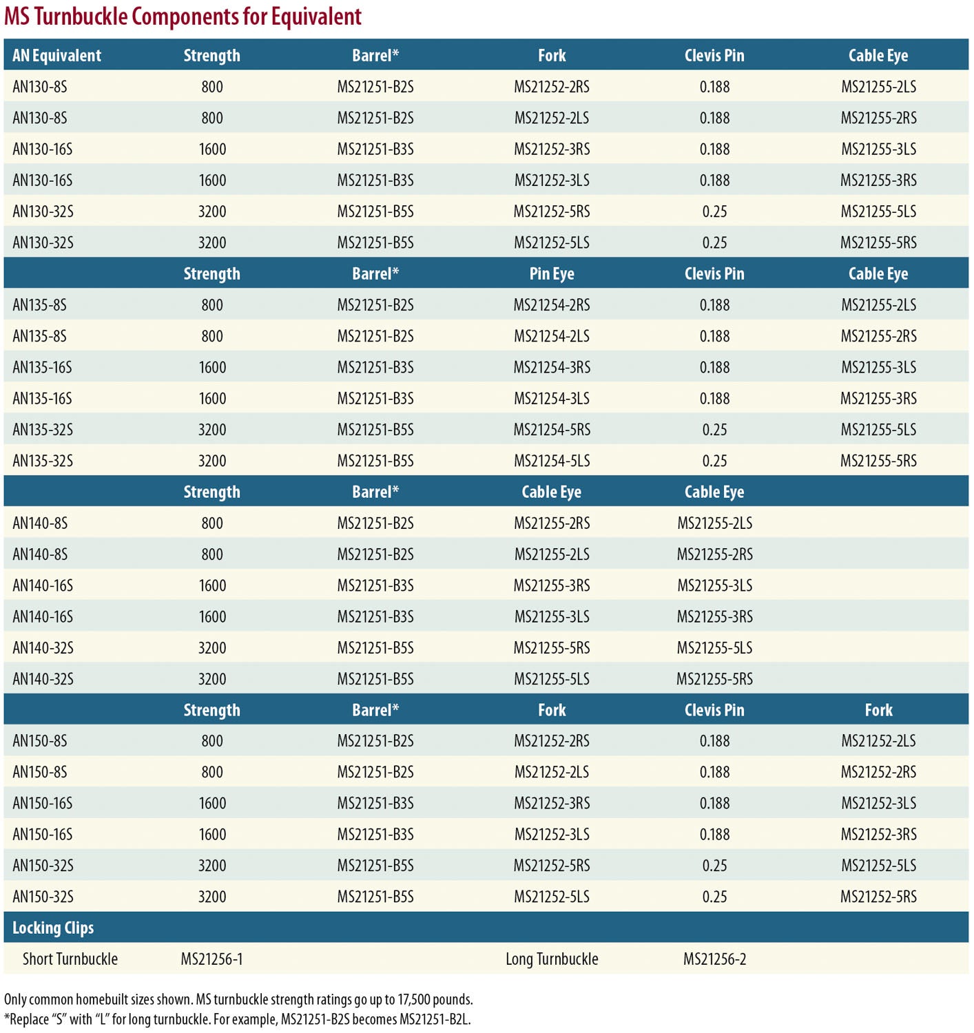

The new turnbuckles from the Military Standards (MS) system use a simple base designation (MS2125X) with the final digit identifying the specific components. (There’s also the MS21260 turnbuckle end, which is designed to have the cable swaged to it.) For instance, instead of an AN155 barrel, we have the MS21251 (the specification refers to it as a “body”). Instead of AN161 fork ends, the MS series lists MS21252.
The new system stinks in one particular way: It doesn’t have a specific MS identifier for turnbuckle assemblies. One can buy an AN130-16S turnbuckle, which comes with a compatible barrel (AN151), fork end (AN161) and cable eye end (AN170).
threads annotated v2
The clip slides into matching grooves in the turnbuckle body and turnbuckle ends.
No such luck with the new turnbuckles. You’d have to know to buy an MS21251 body, a MS21252 fork end and an MS21255 cable eye end. You’ll have to make sure the ends have compatible threads with the body and ensure that either the fork end or the cable eye end (but not both) have a left-hand thread.
The suffix (the characters after the basic MS number) that describe the individual characteristics are similar to that of the AN variety, with one key exception: the listing for the minimum breaking strength. The “16” on an AN-130-16S turnbuckle meant it was rated at 1600 pounds. In contrast, the strength for an MS unit is coded. For instance, a fork end might be an MS21252-3RS. The “3” indicates the unit was rated at 1600 pounds. Here are the code runs:

A key advantage boils down to one component: The MS21256 clip. The MS turnbuckles can be locked with a pair of these small wires instead of safety wire. MS21256-1 for short turnbuckles, MS21256-2 for long ones.

The breakdown of MS turnbuckle codes. The strength values actually go up to 17,500 pounds.
