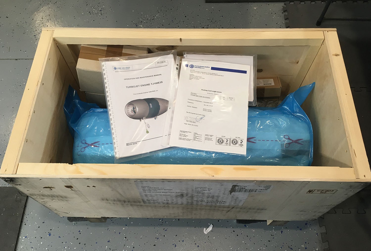

The day the beautiful wooden box arrives from the Czech Republic is a day no SubSonex builder will ever forget. I tracked mine through the FedEx system all the way from Prague and had to work the phones between FedEx, Sonex, and Customs to make sure that it arrived safely and on time—there is something about a box labeled “Turbojet Engine” coming in from the eastern block that bothers the U.S. Customs Service.
Despite lots of markings showing “This way up” on the wooden crate, mine arrived in the FedEx truck lying on its side. The driver merely shrugged when I pointed this out and asked if I wanted it or not. It looked like a reasonable risk since airplane engines are routinely operated in unusual attitudes, and the box had no damage, so we rolled it into the shop and opened it up. Aside from a little spilled oil (which I learned was common for other deliveries as well), nothing was the worse for the wear.

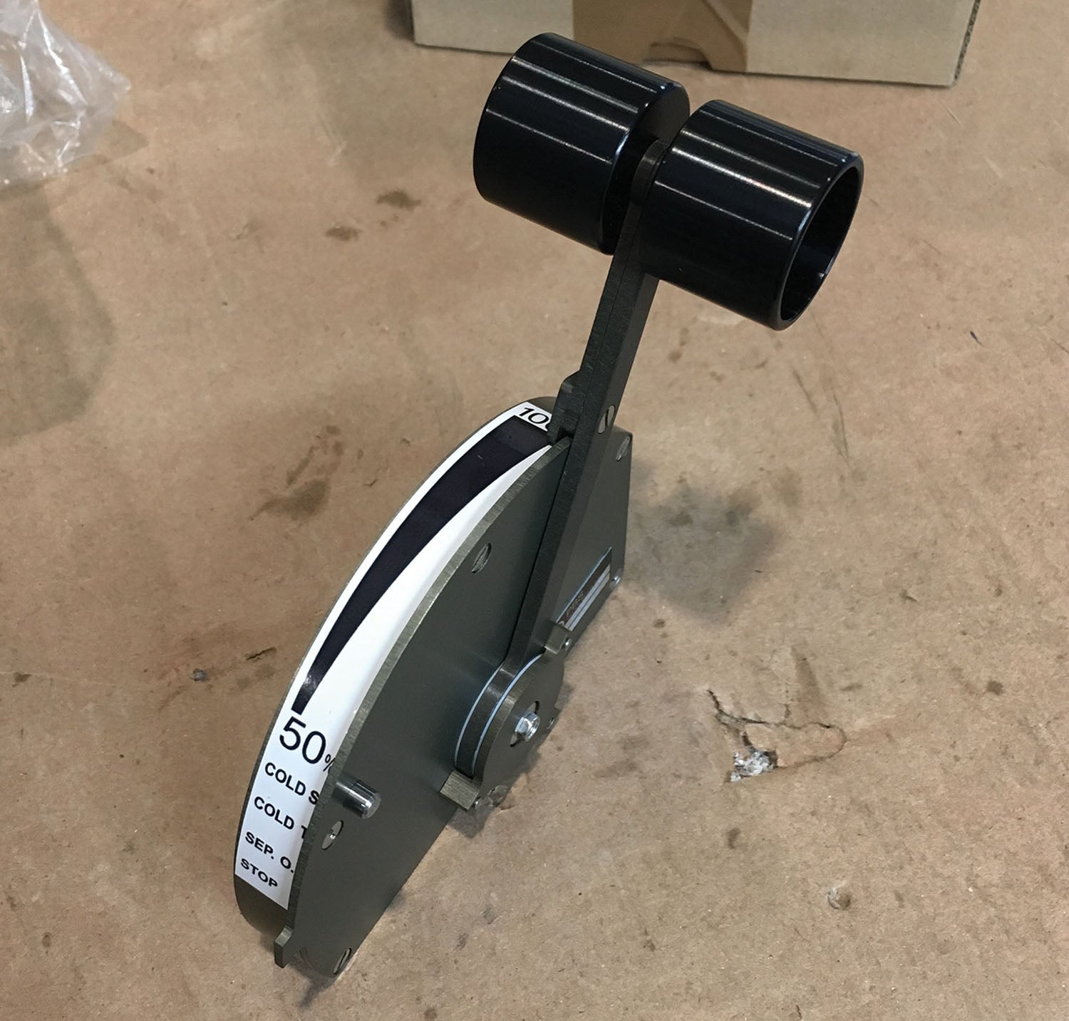

You buy the engine through Sonex, and they will take care of paying the factory and arranging shipping to your location. In the box, you’ll find the engine assembly itself, the throttle quadrant, ignition box, display panel, and two CAN bus boxes—one that is essentially a data recorder (saving engine data on an SD card), and one that converts CAN to a USB port, in case you want to build your own computer interface.
Also in the box is the documentation—a manual, logbook, and various bits of tracking paper—as well as a box of “spare parts,” which really are nothing but some O-rings and seals. Each component was carefully packaged in those ex-Soviet-state signature thin cardboard boxes and obviously hand packed. Despite all of the careful packing, at least one U.S. customer has reported that the rear engine mount tang on their engine was bent—so it pays to do a thorough inspection upon reception.

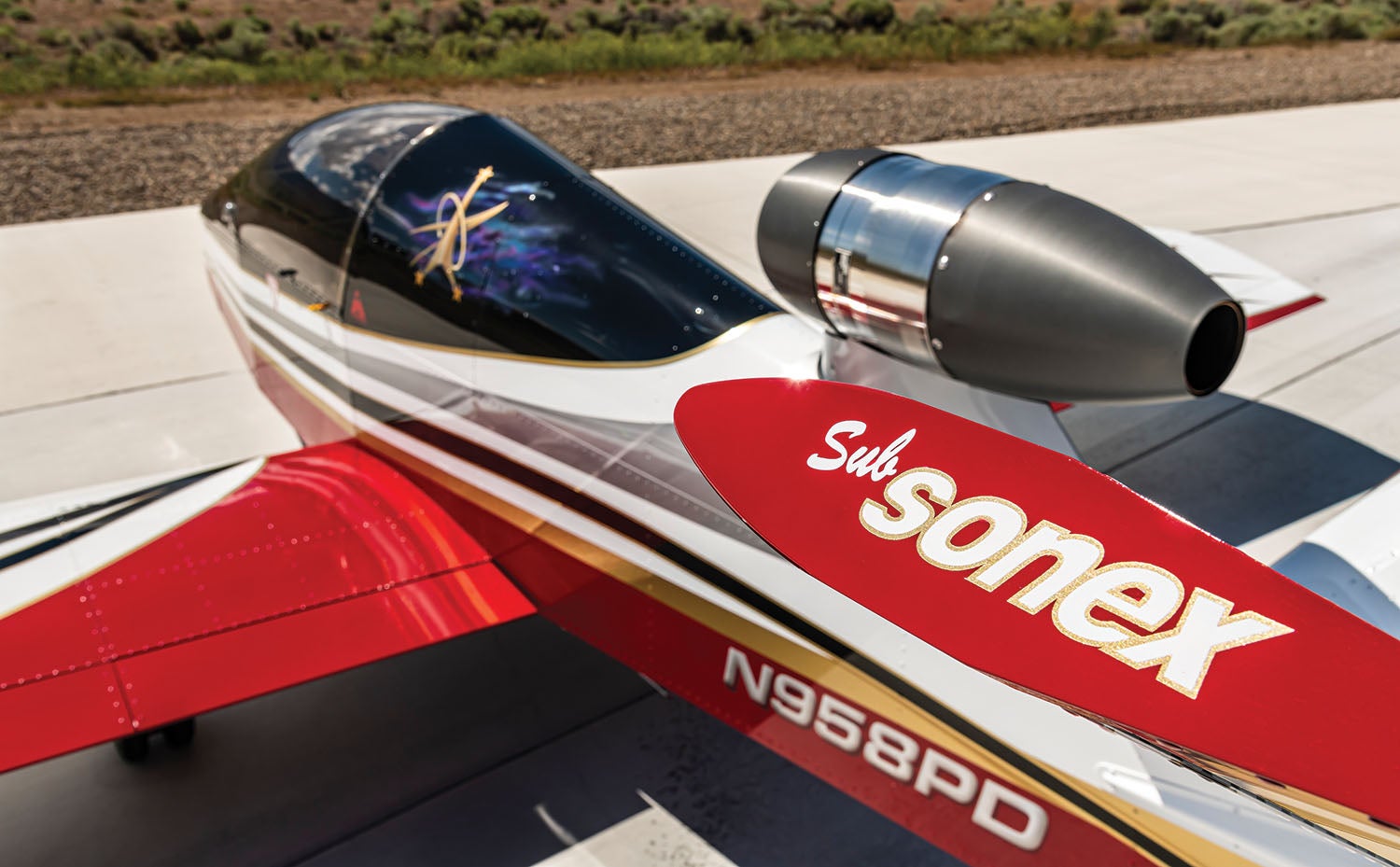

The PBS TJ100 is a simple, 257-pound-thrust turbojet with a full FADEC controller. All the pilot has to do is move the throttle lever from “Off” to the “Start” position, and the computer does the rest. You can (and should) monitor the startup sequence on the display panel, but frankly, it’s going to take care of itself whether you watch or not. The engine is simple—a compressor fan on the front is linked to a turbine wheel that is spun by the hot gases ejected from the burner cans, which are fed fuel and compressed air from the compressor fan.
To get the whole ball rolling, a starter/generator (it’s a starter if you feed it electricity to turn it, and once it is turning, it produces electricity so it’s a generator) spins the common shaft to get it up to a speed where there is sufficient compressed air to get the combustion process going. The computer then introduces fuel and a spark inside the burner cans. This ignites things and produces hot gases, which turn the turbine on their way out the tailpipe. The gases out the tailpipe are the thrust, and the turbine rotation spins the compressor, which keeps the whole reaction going. The computer monitors temperatures and pressures, and feeds the appropriate amount of fuel, based on the throttle position, to keep it all humming along. Should anything go wrong—like a drop in oil pressure or a spike in EGT, it shuts the engine down to protect itself.

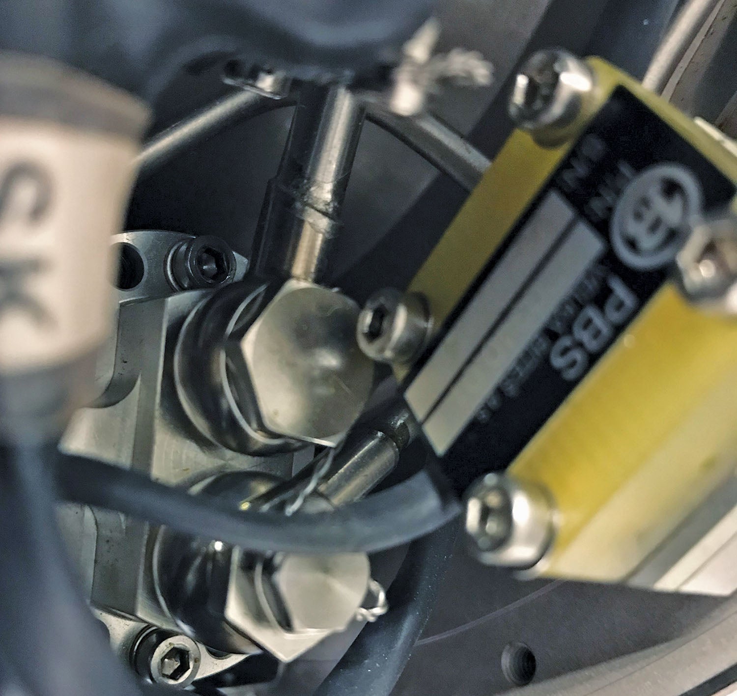

Peripherals to the engine are similarly simple. There is an ignition box, which is basically a coil, to produce high voltage for the spark plug that ignites the engine. This small box mounts inside the SubSonex fuselage, below the engine. A two-conductor wire comes from the engine to the input side, and a shielded ignition wire (that comes from the engine) attaches to the output side. You need to connect the two #10 main power wires (+24 volts and ground) to the ship’s power supply. Then there is a data cable that runs to the cockpit for the display, throttle, and a kill switch.
The data cable runs through the SD-CAN box—the data recorder we talked about earlier—but since this box has a male D-Sub on one end and a female on the other, you could actually omit it if you wanted—it is nothing but a listening device. This is probably not a good idea, however, since you want to be able to have data to show PBS in case of engine issues. If you are the industrious type that wants to build your own computer display, throttle, etc., you could also install the CAN-USB box, and this would allow you to control and monitor the engine using whatever computer you wished. This seems like too much work to me, but others might enjoy the challenge!
The final cable from the engine goes to the fuel shutoff valve—a solenoid valve supplied with the engine that you put in the fuel line just before the motor. The FADEC uses this to start or stop fuel flow to the engine, and it connects with a Cannon-type plug. An experienced person can probably install or remove the engine in minutes—it’s just really simple. No baffles, exhaust system, intake plumbing, etc.—a wonderful change from recip power.

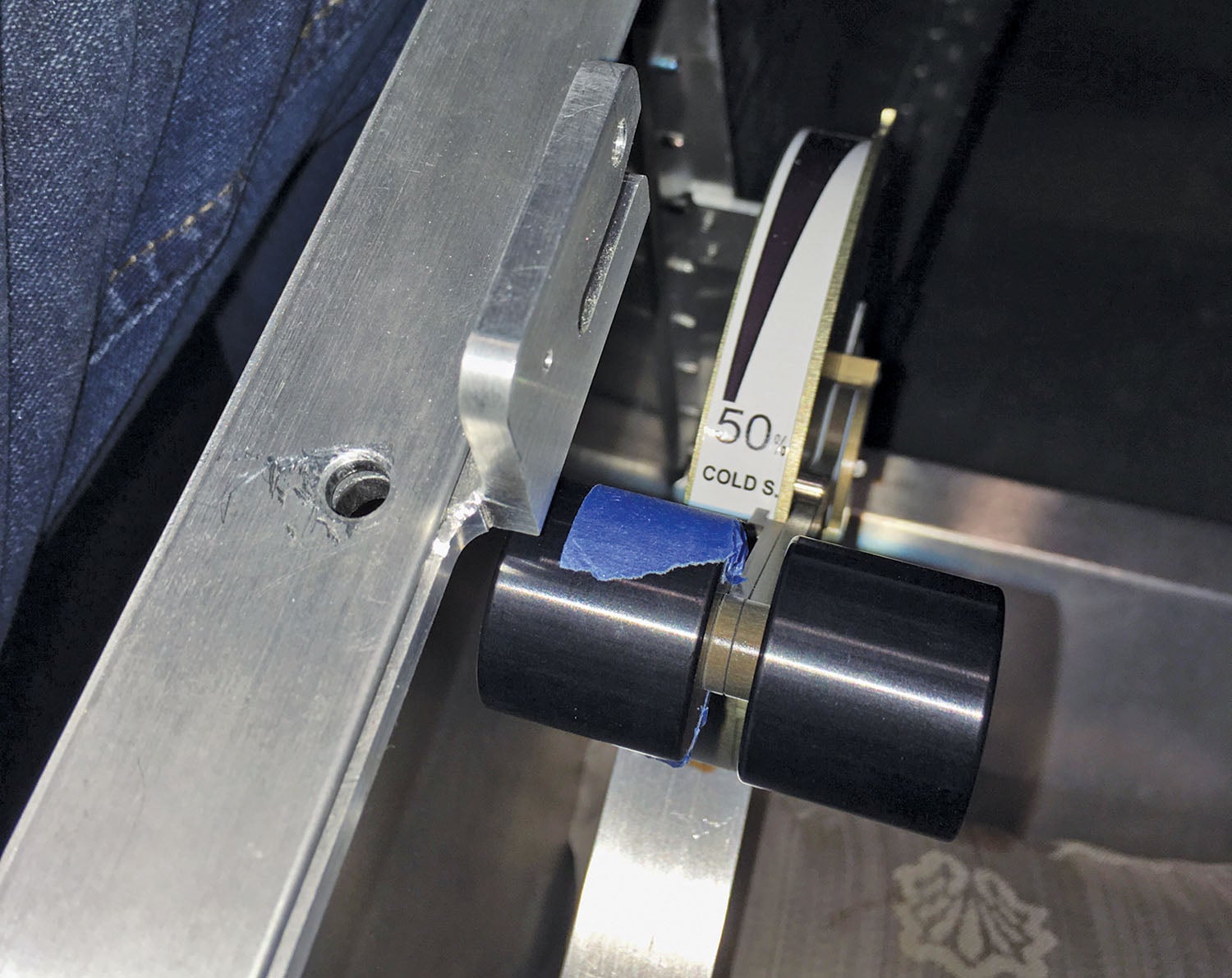

Operating the TJ100 is so easy, anyone can do it—but the FAA still believes that you need special instruction and the equivalent of a type rating to do so. Old habits die hard, and the fact is, the FAA just hasn’t caught up. With the full FADEC engine computer, the single-lever power control is much simpler than messing with three knobs on a constant-speed, fuel-injected reciprocating engine.
To run the jet on the SubSonex, you first power up the main bus, then after checking that the throttle is in the “Off” position, turn on engine power. Next come the fuel pumps—turn them on, and watch the system pressurize. Now you simply take the throttle to the “Oil Sep” position for a couple of seconds, then the “Cold Spin” position, then depress the little flight idle detent and take the throttle to 50%. Watch the spin-up, see the EGT peak and drop, then roll back the rpm—and you’re done. PBS recommends a two-minute warm-up, which—unless you are sitting ready alert on the end of the runway—you’ll get during taxi.
Once you’re ready for takeoff, push the throttle forward and go! Bring it back out of 100% before you reach the five-minute limit. You have a 30-minute limit at 98%, and below that, you’re free to operate as needed.
Stopping the engine is as simple as depressing the flight idle detent button and bringing the throttle back to “Off.” Problem at any time? Lift the “Engine Hard Stop” cover and throw the switch—you’re done. A normal shutdown allows the engine to spin cold to cool things down—the hard stop simply removes all power. Better to use a normal shutdown to preserve engine life.

If the TJ100 isn’t the easiest aircraft engine to install and operate, I don’t know what is. It is simple to hang, easy to hook up, and mind-numbingly simple to operate. Early jet engines required a lot of care and feeding by the pilot, and the kind of speeds you saw meant you really needed to be on your toes. The SubSonex application gives you an airplane that is a bit above RV speeds, with good low speed characteristics, all with a single power lever to control thrust. Yeah, you need a special rating, but if you have a level of competence and currency, passing a check ride isn’t that hard. The PBS TJ100 allows you to make jet noises and enjoy flying for a reasonable cost—and that special Jet A smell.
