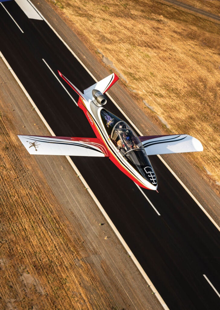

The culmination of a successful build is the first flight. Here the jet stretches its wings early in the test program with the chase plane following at a smart distance.
paul dye sonex logoThere comes a day in every airplane build where there is nothing left to do but fill it with fuel, get in and take it aloft. But between the time when you have turned the last bolt and applied the last placard and that first flight day, there are still a few things you need to get done—and most of them involve paperwork. That paperwork leads to the final licensing inspection and (hopefully) a Special Airworthiness Certificate.
