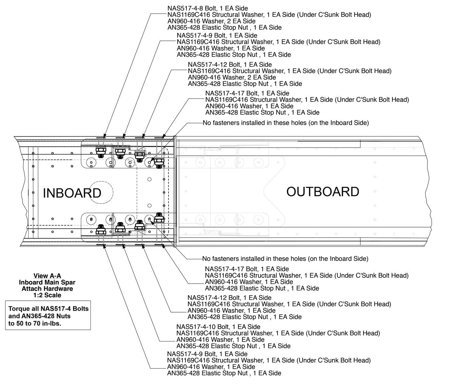

The day we installed the wings, it turned out to be a non-event. Two people, 30 minutes, and it was done. Well, except for having to pull them off again to adjust the length of the aileron pushrods. But the wings slid right in, as if they had been there before—because, of course, they had (at the Sonex factory). The main spar splice bolts are different sizes, based on location, and are different top and bottom, so we made labels out of tape near each hole to remind us which size went where—but it turned out to be fairly obvious. Lining up the outboard flap drive pins took an extra 30 seconds, but once they were in place, the wings slid into their final positions smoothly and solidly. The rear spar splice bolt goes in with the flaps fully down, and all we had left to do was torque all the bolts and connect the wires for the wing tip lights.

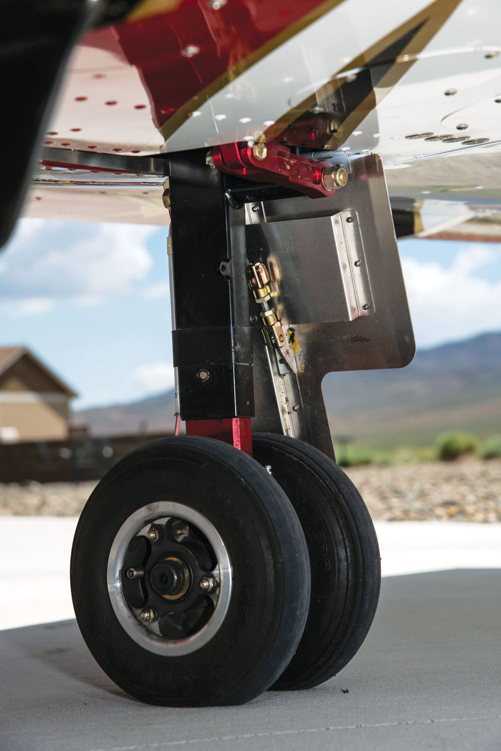

Our jet never sat on its own wheels until very near the end of the build. This was because it was so convenient to have it on the solid workstands and also because it took a handful of neighbors to lift it up and down. It was also nice to have it on the stands so that we could regularly cycle the landing gear. Let’s face it, the gear really needs to work—at least in the “down” direction—and the best way to make sure you are comfortable that this will happen is to cycle it a lot during building. It pays, of course, to not be too casual—always check to make sure some air hose or electrical cord hasn’t snagged on the gear before throwing the switch—but if you do it enough, you’ll learn that.
We left the nose gear door off until very near the end, partly because every time we looked at it, we couldn’t figure out how we were going to stretch the spring that pulls it closed. It’s a short, stout little spring, and it attaches to a bolt up in the nose wheel well, as well as to the door. The nose gear has a Delrin bumper that contacts the door and pushes it open as it deploys. The door springs close when the gear goes up. When there was little else to do on the jet, we finally tackled this little project, and it turned out to be simpler than we expected. We loosened the bolt up in the nosewheel well and hooked one end of the spring to it. Then I grabbed that big, stout safety wire—the stuff we have but rarely (if ever) use on light airplanes—and twisted several strands with a loop in one end to hook on the spring, and on the other, a loop to attach a handle (actually, a big screwdriver). Then all I had to do was pull on the handle with most of my weight to stretch the spring and hook it on the door—it turned out to be easy.
The first time you retract the gear with the nosewheel door in place, expect a surprising loud and sharp bang as it closes. I hope I get used to that in flight! The first time we deployed the gear with the door in place, we got a shocking disappointment—the nose gear hung up. Looking at the situation, it was obvious why. There needed to be a bit of a taper on the Delrin bumper attached to the nose gear. Conveniently, the deploy attempt had left a mark in exactly the right spot where it contacted the door, and this showed us where to start the taper. Problem solved.
