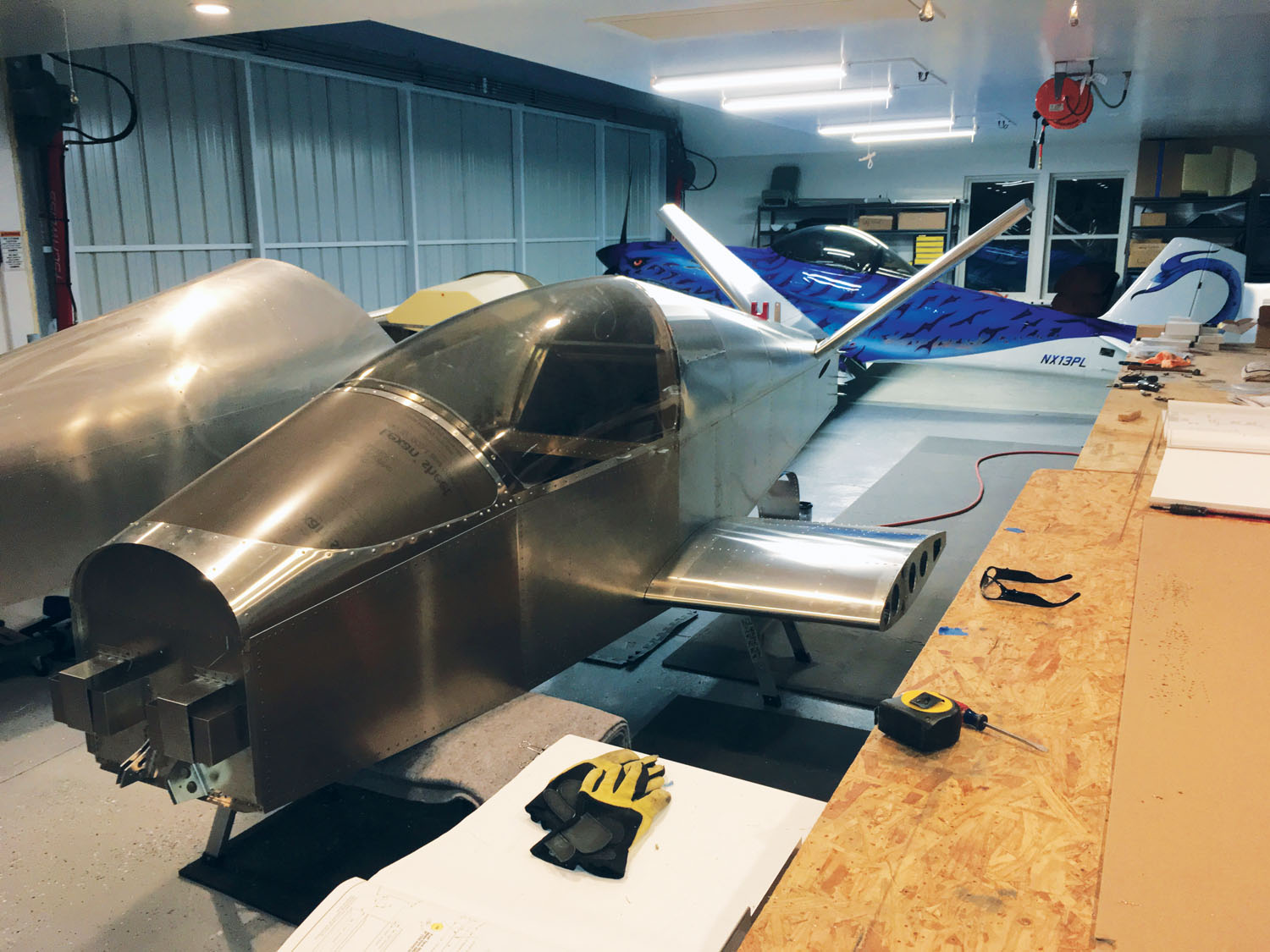

Rule number one for building the SubSonex: Build from the inside out. Rule number two: Never close anything until you have no choice but to do so—you might need to access something on the inside.
The SubSonex is small; even experienced builders who come to visit the shop remark at just how diminutive it really is. I’ve built an RV-3, a single-seat, single-engine airplane that is dwarfed by my RV-8, and even compared to the -3 the SubSonex is small. Short in stature, you will get tired bending over to work on the fuselage if you let it sit on its gear. Workstands are important, not only to stabilize the project but to get it at a height where you can work! You’re going to want the fuselage high enough so that you can work underneath it on a creeper to install—and then cycle—the landing gear. Getting the belly about 18 inches off the ground seemed to be about right for us, and once we had it there, that’s where it stayed until it was time to roll it around.

Getting Started
Airframe construction starts with the tail. You can sit in the cockpit and make airplane noises (remember to go “whoosh” instead of sounding like a prop job) any time you feel like it. Just throw a boat cushion in there. But concentrate on that tail and get it right! There are really only two stabilizers to build and two ruddervators—a third less than a standard tail. The good news is that the stabilizer assembly has all prepunched parts, which means you can Cleco the skins and ribs together right from the very start. The assembly becomes a “Y” early on in the build, and this can be just a touch unwieldy in the shop. Make sure you have a workbench where you can hang the stub spar (the part that goes vertically on the back of the fuselage) down over the edge, and it will work better.

Mounting the Tail
The last major structural construction task for the SubSonex is to mount the tail on the fuselage. Sonex provides some very nicely machined angle bracket for the top and bottom, and they fit very well—but it does take a bit of trial and error to get them in place. You will be drilling some very critical holes for AN3 bolts in the longerons, so pay attention to the dimensions when doing this. I found that in order to transfer the holes accurately, I had to make some templates using hotel key cards. These plastic cards are thin, yet stiff, and make great template material. You could use a credit card, but you still have things to buy for the jet, so don’t use them all up yet!
Sequence is important here, and you want to make sure you don’t rivet anything until you absolutely have to, for disassembly is in your future. I installed the rear bulkhead to the stub of the stabilizer spar on the workbench first, then attached the upper bracket per the drawings and prepunched holes to the tail assembly. I then match-drilled that to the fuselage longerons. The last thing I did was drill the lower angle. You have to do a little bit of prying and pulling to get things installed because of the fuselage taper, but it all goes together really nicely when you get it in place. You’ll want to rivet the aft bulkhead in place before bolting on the stabilizer spars, and this makes for some tight work with wrenches to eventually put in that forest of AN3 bolts—but it all works. Remember, as always, never put anything through the bottom longerons until you have riveted on the belly skin, which happens just before you put fuel in the airplane!
Moving on to Mechanical
Once the tail is on the airplane, you’re pretty much done with the structural building. Yeah, you’ve got some riveting to do for the flap hinges, and the bottom isn’t on (we hope—can’t emphasize that enough), but overall, it looks like an airplane! Congratulate yourself—then get out a set of wrenches and screwdrivers because the mechanical and systems work is about to begin.
First off, get the windshield out of the way. Yeah, they did a great job of installing that at the factory, but it really does need to come off. I suppose if you’re really good at building a ship in a bottle, you can work in the nose area with it in place—but I don’t have arms as long as an orangutan, and you probably don’t either. You’ll waste a bunch of time trying to work with the windshield in place, then eventually you’ll take it off and curse yourself for not doing it earlier, so do it now. Yup, there are a lot of screws and nuts; put them in a bag and set them aside. Note that there are two different length screws. It is obvious why and not hard to put them back in the right place later on.
While you’re removing things, take the canopy off and store it someplace safe. Just remove the bolt holding the cable, then pull the hinge pin. Now that it’s out of your way, you’ll have access to the cockpit from either side. Next, get that fuel tank out of the way. Unbolt the crossbeam that holds it in place and work it out of the fuselage. It’s a tight fit, and the edges of the rear cockpit bulkhead work like barbs to keep it from sliding forward, but it does come out.
Finally, it’s time to get the fuselage bottom skin out of the way. Sonex secures it with a few red-painted aluminum rivets. Drill those out and then fold it forward. It only comes loose up to the main spar, so you can’t take it all the way off. I tucked it carefully under the supports I was using for building and was successful in not crimping it. Once that and the fuel tank are up and out, everything becomes accessible.
