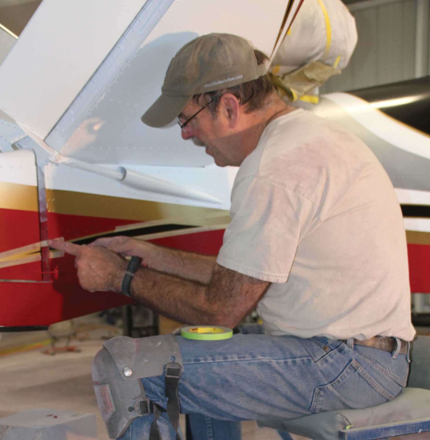

John Stahr and Paul Dye discuss how to handle painting the ailerons .
Once we had figured out the overall scheme‭, ‬John moved on to little details‭: ‬name badges‭, ‬BRS warning stickers and‭ ‬rescue arrows‭. ‬This whole design process took about a month‭, ‬with the two of us trading emails‭, ‬imagery and ideas several times a week‭. ‬At the same time‭, ‬I was finishing the airplane‭, ‬and John was firming up the hole in his schedule and coming up with a bill of materials for the project‭. ‬The‭ ‬materials turned out to be the easy part‭. ‬All of the colors he brought came in a few quart cans‭. ‬The primer was a gallon‭ (‬but he didn’t use it all‭), ‬and the final clear coat was just another gallon‭. ‬But paint is one thing‮—‬he also planned an assortment of paper‭, ‬tape and plastic for masking‭, ‬and various tools and guns‭, ‬ranging from a large pressure pot for the clear coat down to a tiny airbrush for the magic touches‭.‬

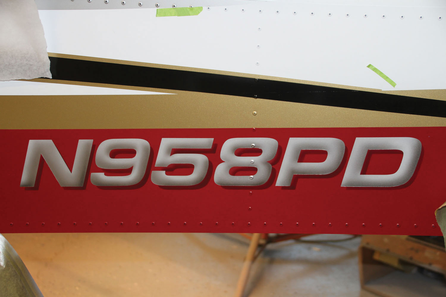

Once the gold pinstripes were covered up‭, ‬it was time to mask off everything‭ ‬that would not be silver‮—‬the design‭ ‬called for a silver swoop running down‭ ‬each side and then up to the engine‭ ‬pylon‭. ‬Since silver was easy to cover with the following colors‭, ‬the masking wasn’t too extensive and really just consisted of layers of paper laid on some part of the airframe‭. ‬John then shot the silver and waited for it to dry‭.‬
Subsonex paint
The aluminum surface after scuffing.

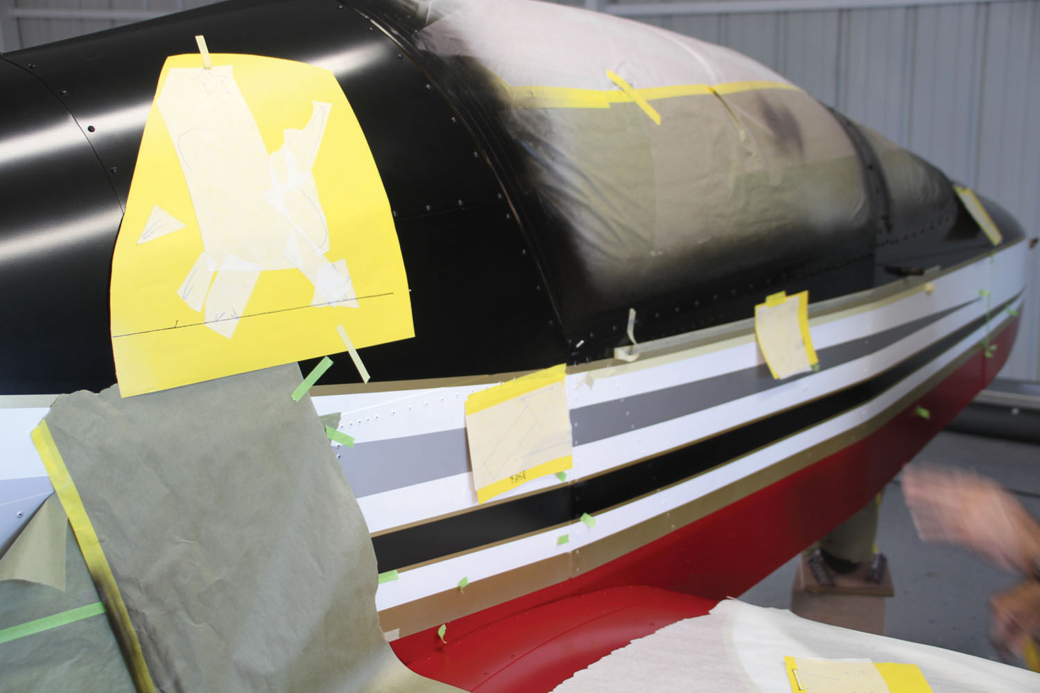

When the silver had cured‭, ‬he covered that up and then covered anything that would not be black in the final design‭. ‬His clever‭ ‬masking boxes were things he made for himself decades ago‭. ‬They hold rolls of paper and masking tape so when you pull a piece of‭ ‬paper‭, ‬it automatically comes out with tape on one edge‭. ‬These little devices saved countless hours and much frustration as they gave a fast‭, ‬easy way to apply masking paper‭.‬
The same process was followed for the airplane’s red areas and then for the white‭, ‬and by the end of the third‭ ‬day‭, ‬we had the basic airframe color‭ ‬scheme finished‭. ‬And‭, ‬amazingly‭, ‬there weren’t any spots with multiple layers of paint‮—‬the primer was covered with its final color in each spot‭. ‬Easy and light‭.‬

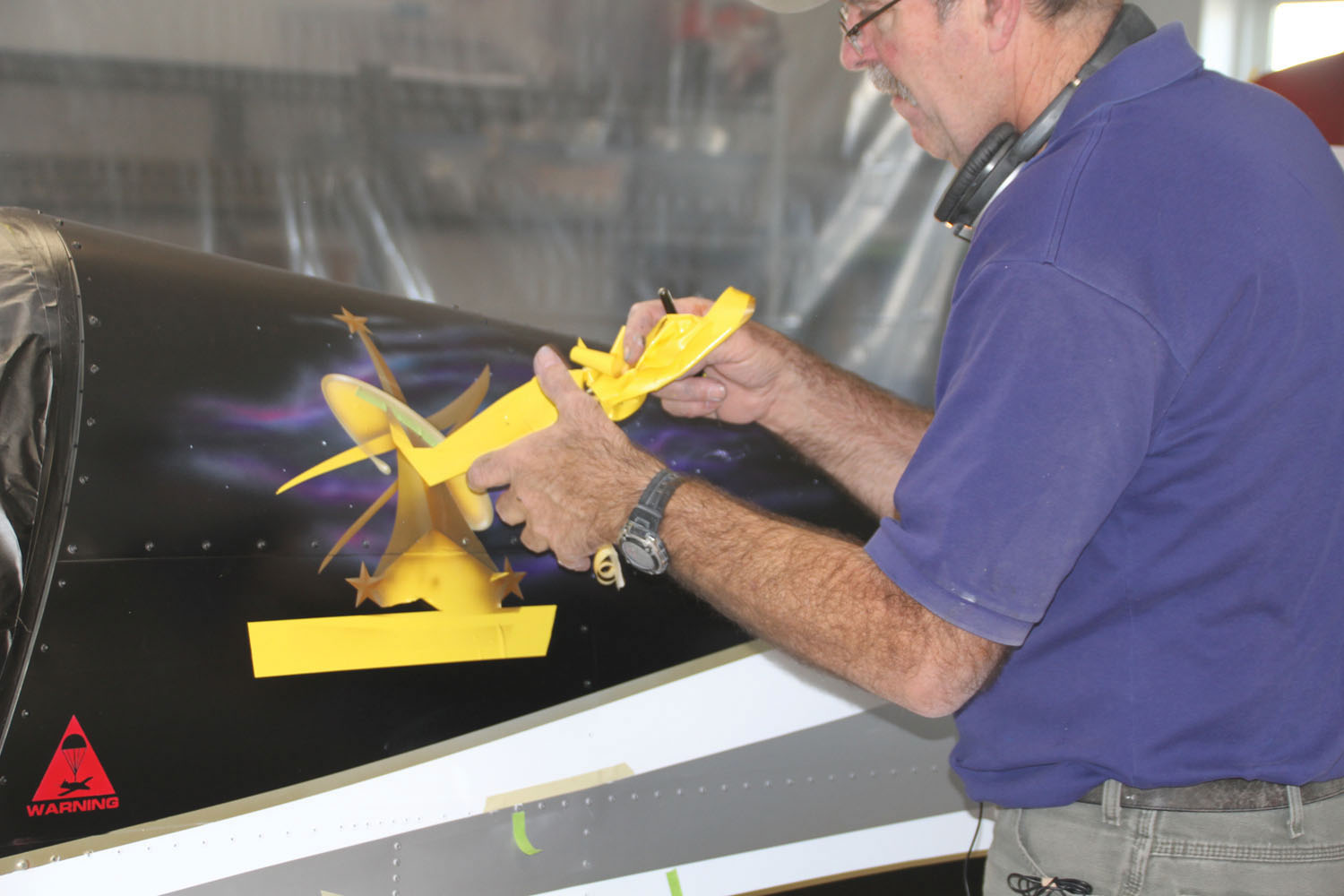

While John is an outstanding and quick‭ ‬paint applicator‭, ‬it is clear he gets the base colors down just so he can really‭ ‬get started on what he loves‮—‬the many details done with an airbrush that make his work stand out‭. ‬He had come prepared with vinyl masks‭, ‬cut at his shop to match the art that we had decided‭ ‬on for the scheme‭. ‬For our airplane‭, ‬there were several large insignias representing my former career in the space‭ ‬program‭, ‬as well as numerous warning and instruction labels that we wanted to have on the jet‭. ‬Being equipped with a rocket-propelled BRS makes one want to let others know it is there‭!‬
Subsonex paint
John applies paper tape for the various color boundaries, frequently consulting the concept drawings. No measuring, no grids—just an artist’s eye and lots of tweaking of the tape lines.
Subsonex paint
Once the pattern is satisfactorily applied to one side of the plane, he uses large sheets of cheap paper to make patterns to transfer the design to the other side, ensuring symmetry.

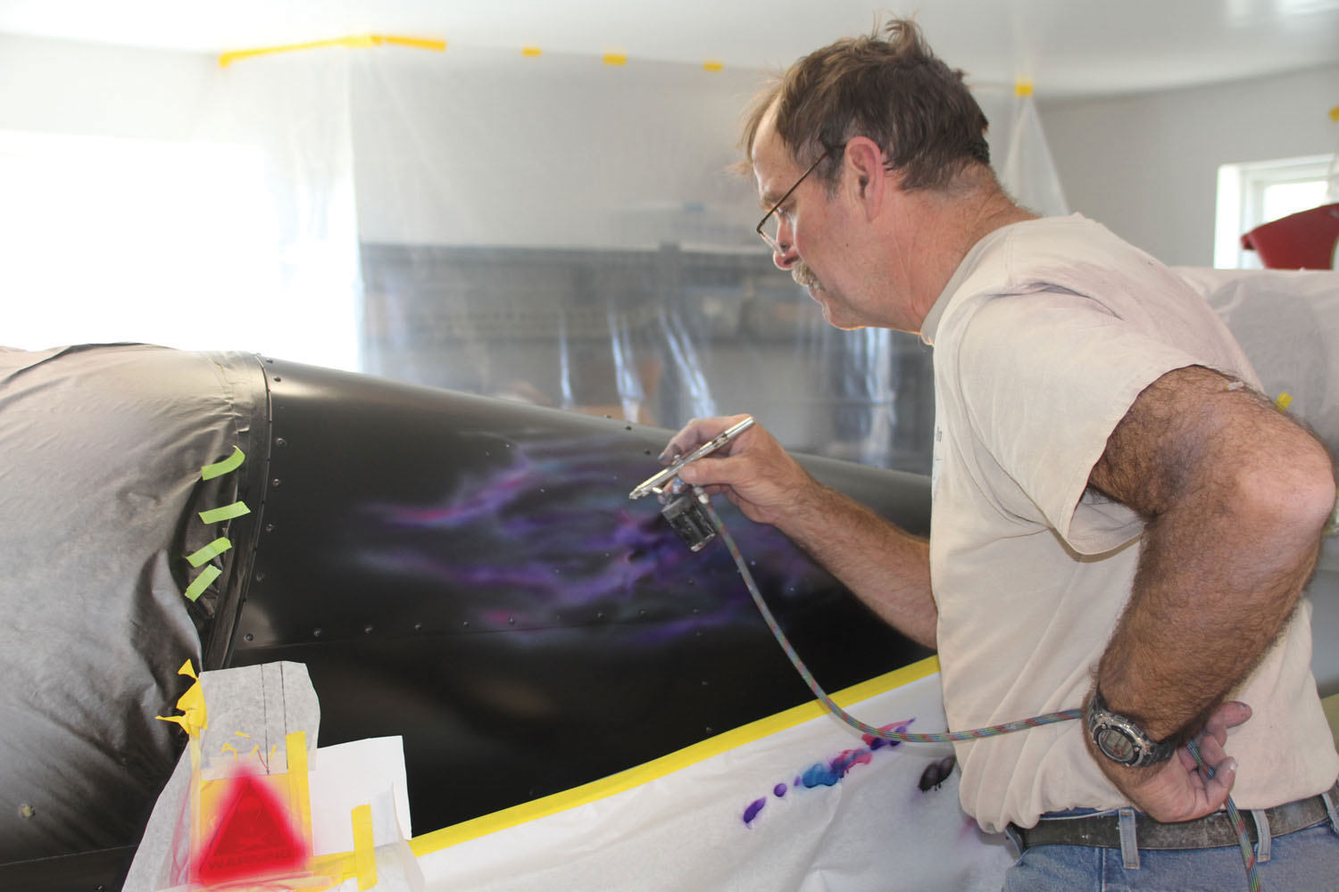

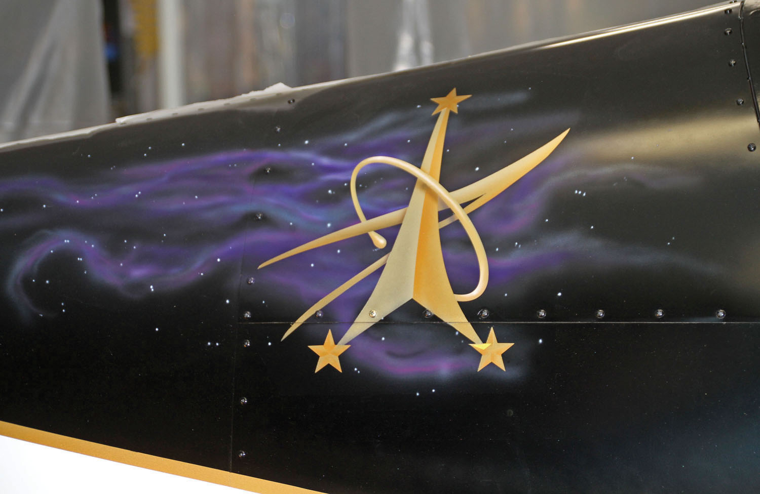

Once John settled in with the airbrush‭, ‬there was little for any of the rest of us to do except begin cleaning up the shop‭. ‬For the eventual clear-coating step‭, ‬we wanted to have all of the debris picked up and dust vacuumed and cleaned‭. ‬But while this drudge work was going on‭, ‬it was amazing to watch the transformation of the little jet from simply sporting a nice color scheme to really popping with details‭! ‬John‭ ‬uses small amounts of a few paint colors and changes them out frequently in his airbrush to create many different shades and intensities of colors‭. ‬
The jet features space-themed backgrounds to the insignias‭, ‬and in a very short time he had transformed a black space into something you’d see in a Hubble Telescope image‭. ‬This work lends a three-dimensionality to the overall art‭, ‬and even the N-numbers look like they are floating off the side of the airplane‭.‬

Masking is all about layering (right), and here the previous silver layer is covered and the spaces for black are left uncovered.

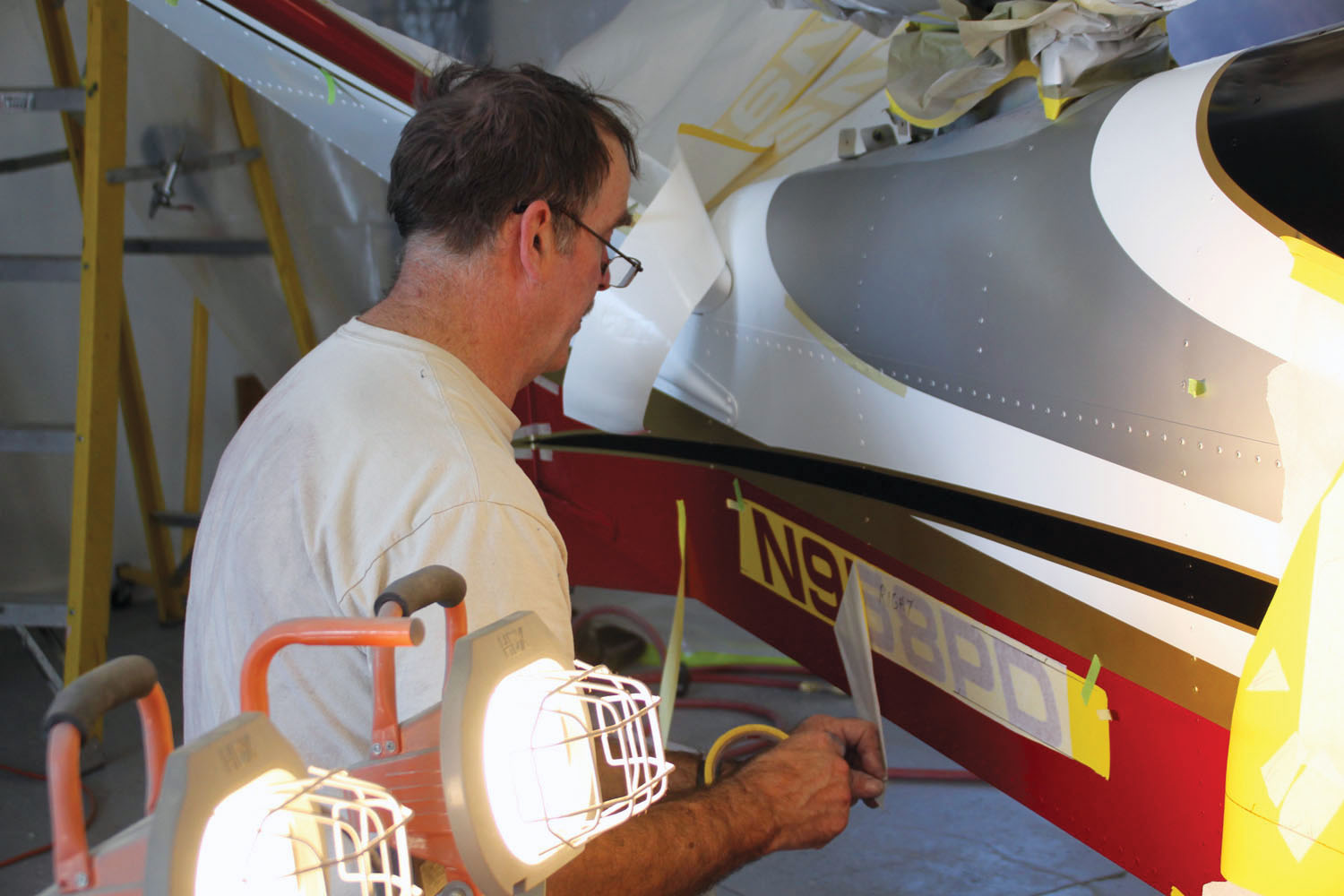

Most of the jet is masked to protect the earlier laid colors. Spraying might look easy until the belly work starts.

One small area on each side hadn’t been laid out exactly to plan, so John had to re-mask the area to correct the deviation with a little more paint.
