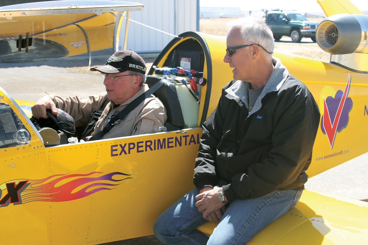

The author got last-minute instruction from high-time SubSonex pilot Bob Carlton before his first flight in the tiny jet.
The SubSonex, I knew from the previous pilot report, is a blast to fly—smooth, powerful and unique. But with a no-reserve range of about 300 nautical miles and a dry-tank endurance of two hours, cross-countries are always going to be a challenge. If you’re going to fly a multi-leg cross-country, you need to make sure that when you get to your destination there will be enough runway to get on and off, plus an assurance that there will be fuel. You also have to remember that you’re not going to be able to carry fuel funnels or anything else to make refueling easier. Oh, and remember that when you get out of the jet, it is going to settle on its tail—it needs a pilot in the cockpit to make it a nose-dragger. So plan accordingly and practice getting in and out without help before you commit to going “remote.”

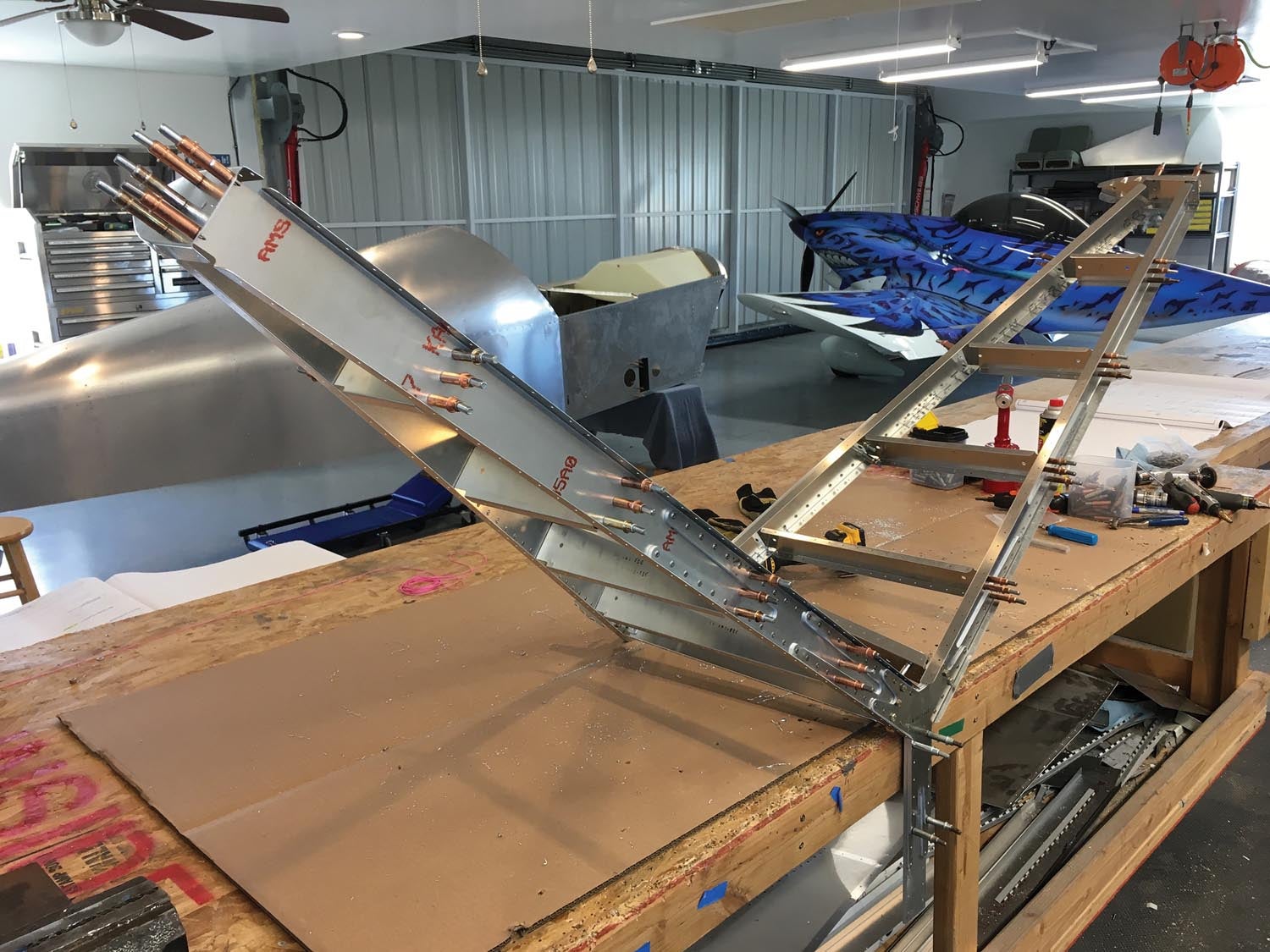

subsonex build p1 2
The skeleton of the stabilizer takes shape quickly since all of the parts are pre-punched and match perfectly. Ah, the joys of modern kit manufacturing!

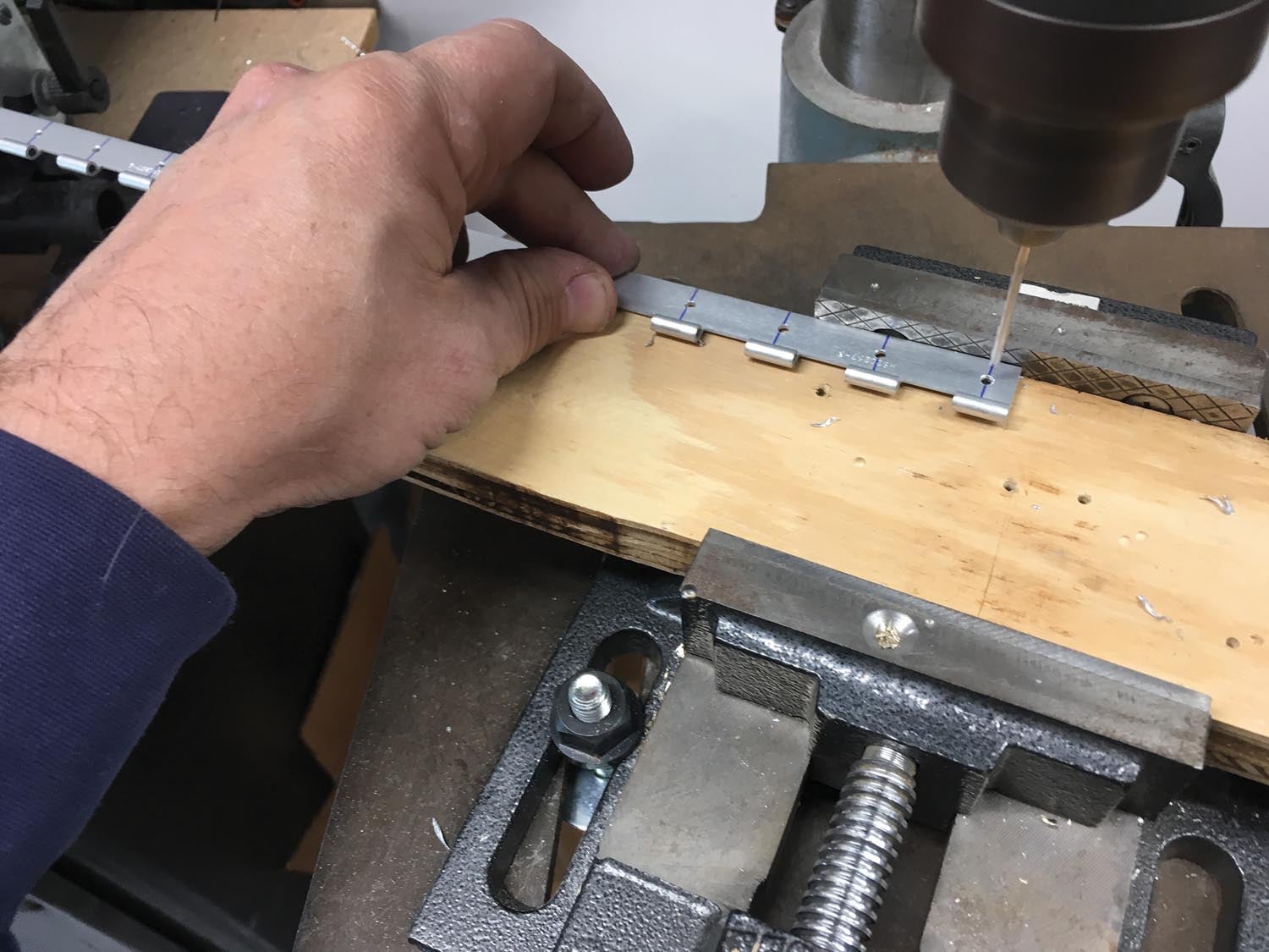

The SubSonex’s control surfaces use lots of piano hinge, so you’ll be drilling lots of mounting holes.

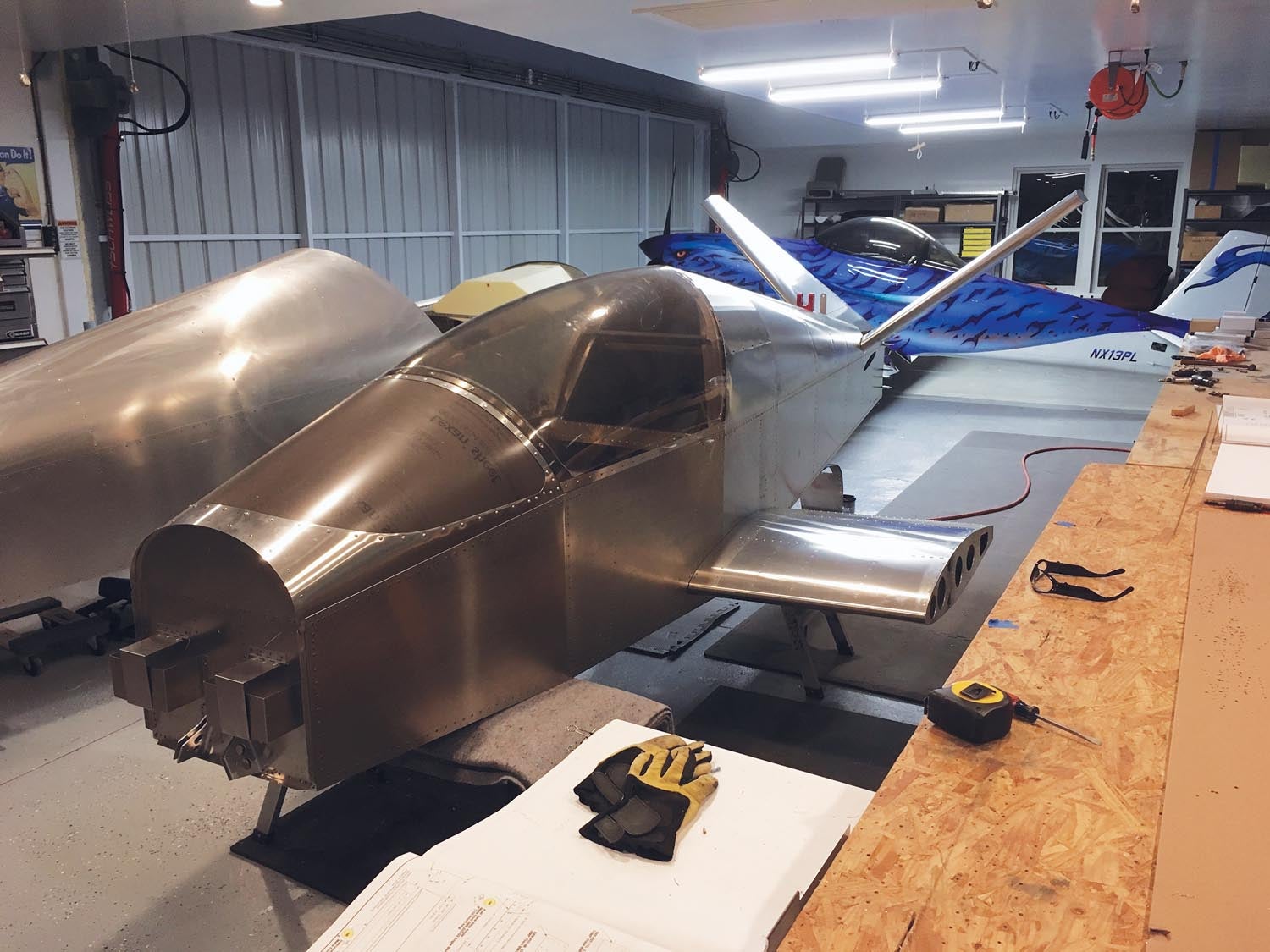

The author’s jet was sitting on its gear and had its tail on after less than a month of work.

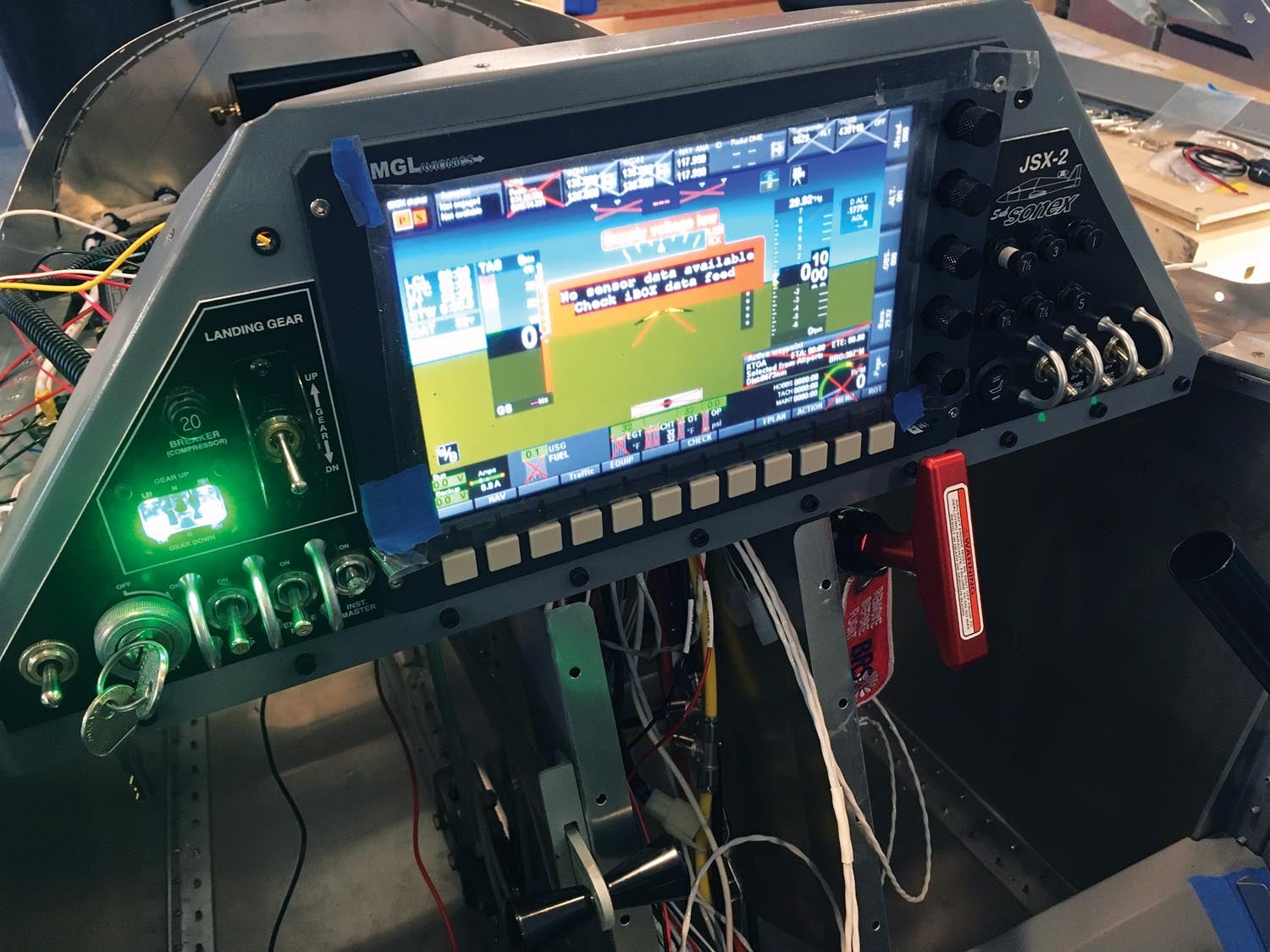

About the only place you will do some window-shopping involves avionics. Jets have flown with MGL, Garmin, GRT and Dynon equipment so far. The panel itself was designed around the MGL screen, which fills the available space and ends up looking much bigger than it is because the panel is so small. There really isn’t a lot of room for options! Necessary switches fill up the remaining panel space, and if you want to use something that takes more real estate, you’re going to be in for some real homebuilding!
At least one jet is using a full-sized Garmin G3X Touch, and it looks very nice. However, that meant modifying the panel to be deeper on the bottom, finding places for remote mounted boxes, relocating the engine monitoring panel and a few other things. All of this is doable for a homebuilder with a modicum of experience, but as anyone who has built before knows, modifications always take about five times longer than you anticipate up front. Little changes have far-reaching consequences, so know that before you start!
In my case, I did a lot of soul searching, and decided that since I already had airplanes with Garmin, GRT and Dynon packages, I’d go ahead and use the factory-preferred MGL EFIS and accessories. It would lead to a faster build and give me an opportunity to fly with a new EFIS—one that I have little experience with but which has a good reputation. One advantage of the MGL system is that they have already done some software integration for the jet, so configurations are a bit easier. Another advantage is that the remote-mounted boxes (radio, transponder, ADS-B and engine data box ) are pretty compact, which is an important consideration in the jet.
Some have designed their jets to be IFR capable, but I found that trying to shoehorn an actual IFR GPS in was just going to be too much trouble—plus the fact that the engine’s generator doesn’t really put out enough amperage to make the power budget work. Yes, you can fly IFR with a single com and a single VHF nav for VOR navigation and ILS approaches. But today’s IFR system isn’t very friendly if you don’t have a GPS, and the required reserves make this a very marginal IFR airplane anyway. The old joke with the T-38 Talon was that you took off in afterburner and declared a fuel emergency as soon as you were done with your initial climb. The SubSonex isn’t much better. If you consider that it has two hours’ endurance, lop off 45 minutes for IFR reserves, plus something to divert to an alternate, it’s clear your leg lengths are going to be less than an hour.  On the bright side, you can easily hand fly that length of mission, which is good, because you don’t have the weight or power budget for an autopilot anyway….

The author used the factory-standard MGL EFIS and avionics, which fired up (without emitting any magic smoke) after a small amount of wiring work. More about the MGL avionics platform and the installation process later in this series.
