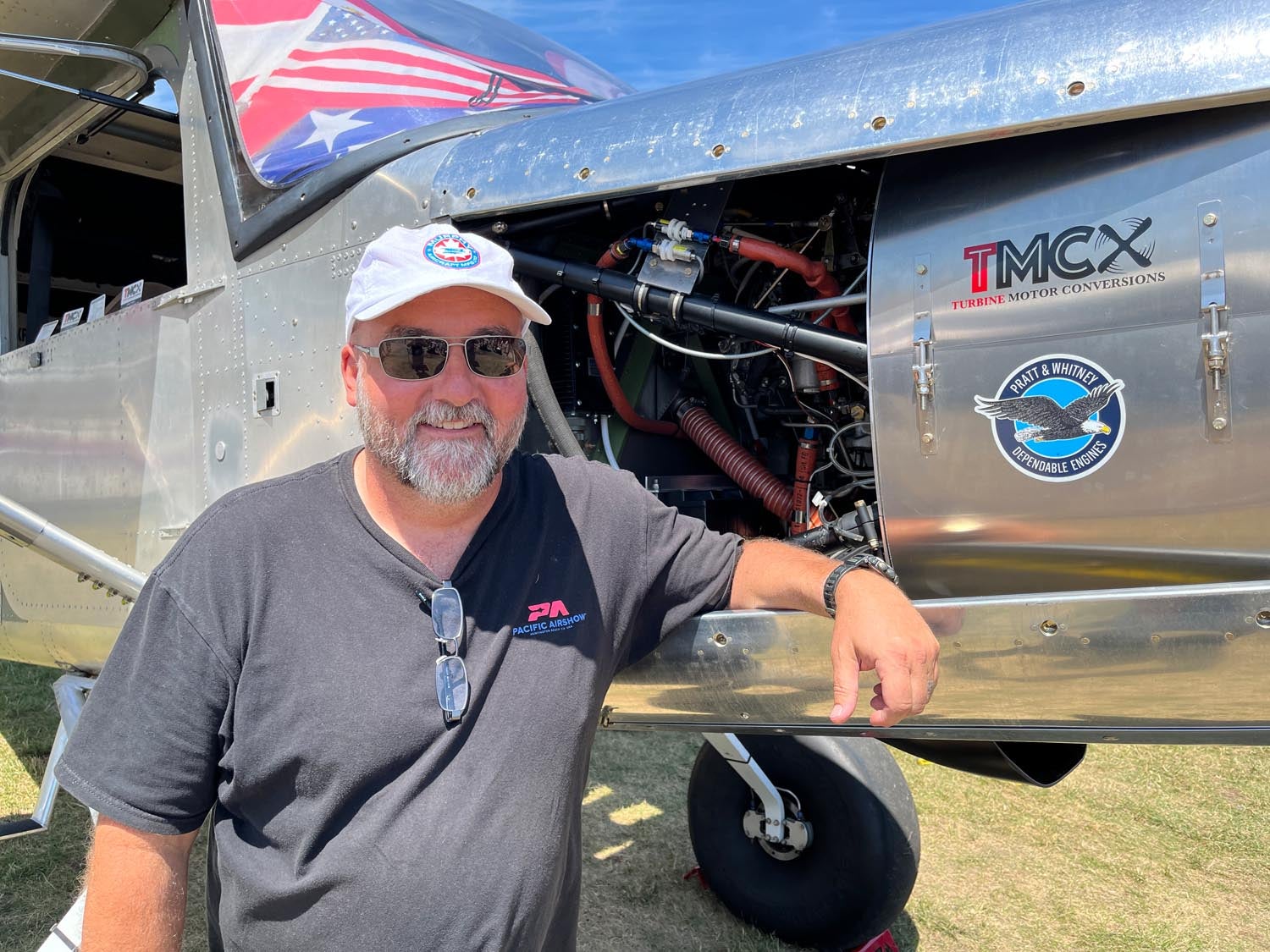

Kenny Meines, of Turbine Motor Conversions, with the Beast powerplant.
Kenny Meines, an aerial agricultural applications engineer and pilot (crop duster) from Pullman, Washington, has been in love with Murphy aircraft since 2008, when he bought a completed Murphy Rebel, promptly converted it to a 180 hp Lycoming O-360 and put it on floats. He flew it five years and then sold it, to his later regret. In 2019, Kenny bought another Murphy, this time a completed Murphy Moose with a rip-snorting M-14P radial. He and his wife loved the Moose’s rugged back-country performance and roomy cabin. However, on one cross country flight over what could only be described as inhospitable terrain, the Russian circle engine began making concerning noises. Upon landing safely at their destination, Kenny’s wife turned to him and said, “Honey, I don’t like this radial. I want you to put a turbine engine on this plane.”
Kenny’s rational response; “Yes Ma’am!”
murphy moose beast img 1674
Murphy Beast front office, complete with turbine management system.
As a crop duster, Kenny had thousands of hours behind turbines, mostly Pratt and Whitney PT6 engines. In fact, Kenny is a test pilot for Cascade Aircraft Conversions of Garfield, Washington, a firm specializing in placing the prop jets on crop dusters. Kenny conferred with Cascade Shop Manager David Price and Engineer James Zimmer. Together they designed the engine mount, cowling and engine management systems to graft a mid-time PT6A-20 (sourced from military King Airs) onto the Murphy Moose airframe. The PT6A is rated at 550 horsepower. In the air movement department, Cascade employed an Avia three-bladed prop.
On June 1, 2023, Kenny conducted the first flight of the turbine Murphy Moose. It flew hands off, with no bad characteristics, from day one. However, the performance blew Kenny’s mind. Takeoff roll with a solo pilot aboard is 151 feet (320 feet at max gross weight). Max climb solo is 3,400 feet per minute, with 2,100 fpm at max gross. The cruise speed is 160 miles per hour indicated, 204 miles per hour true. And that is at only 50% power and 25 gallons per hour fuel burn. Down low, Kenny says he burns about 30 gph.
