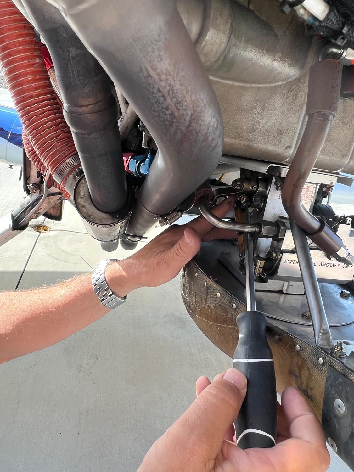

Idle speed adjustment is just like on a carb—the screw serves as a stop for the throttle lever. Get a long enough screw driver—it makes it simple.

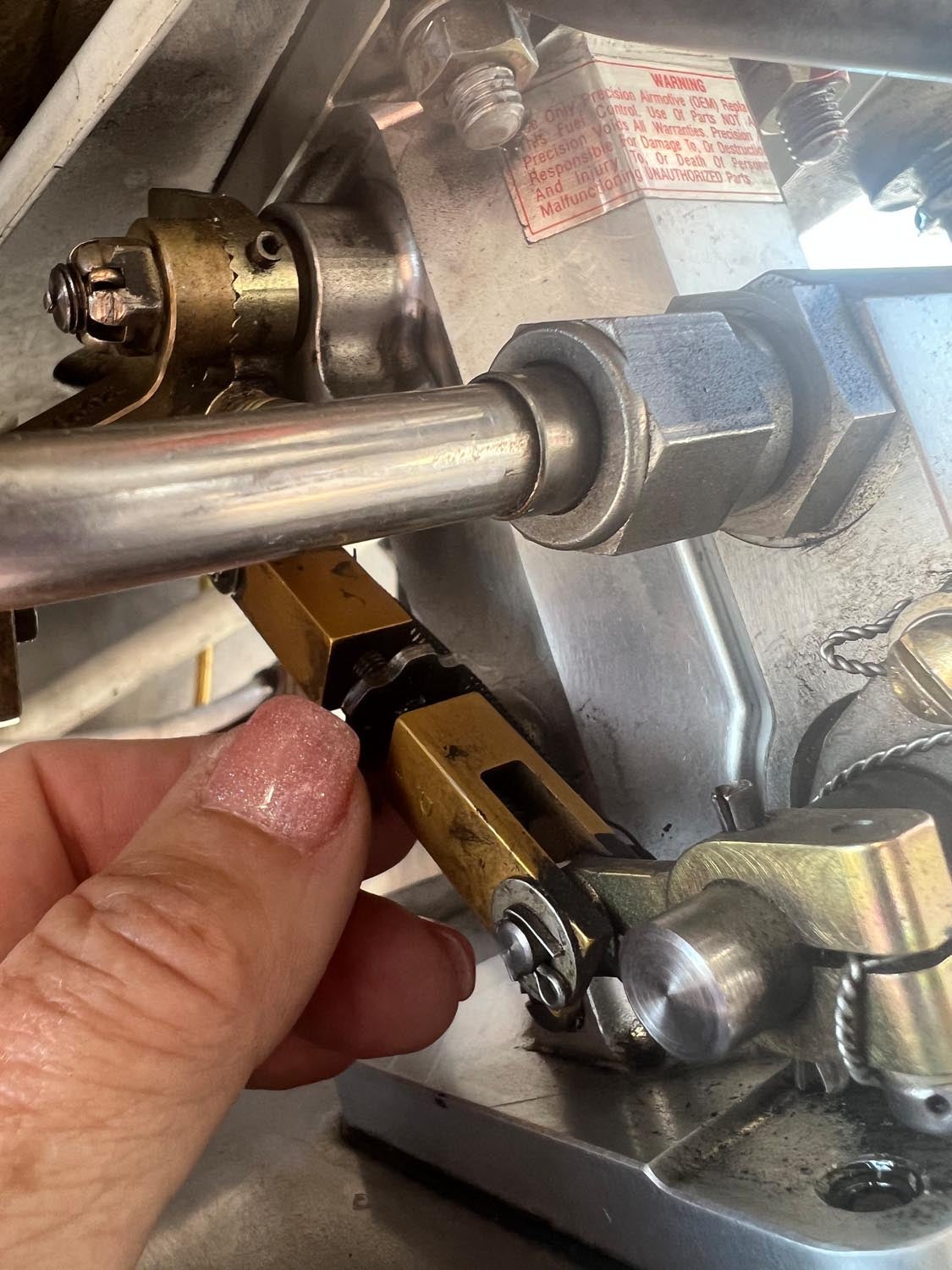

You change the idle mixture by rotating the thumbwheel between the two gold blocks. The thumbwheel has six “notches” that are held by a spring. Count the notches for each adjustment. The “R” and arrow on the lower block shows you the direction to turn the knob to richen the mixture.
Well that’s great if you can get it to idle with the existing idle mixture setting, but ours was blubberingly rich, so we had to take a WAG at leaning it out before setting the idle. How did I do that? I started with the engine running and brought the throttle back as far as I could without it quitting, then leaned the mixture back until it smoothed out. Then I brought the throttle back a bit more until it got rough, then leaned it out a bit more—leaning with the cockpit mixture lever, not the idle mixture. I did this several times until I got it to a smooth idle and noticed that, yeah, it was really leaned out, so the settings must be stupid-rich. This didn’t exactly show how much to spin the idle mixture wheel, but it told me that it wasn’t a matter of one or two notches—we’d start with something like half a turn.

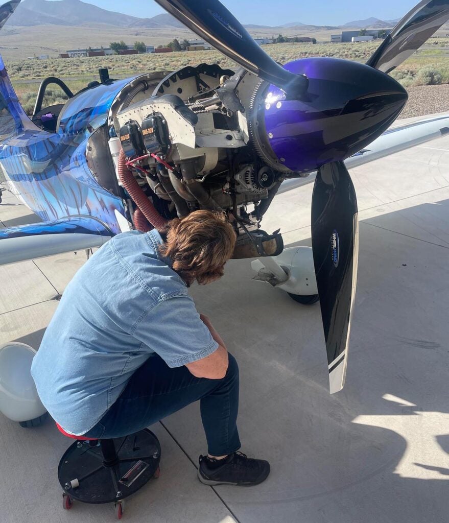

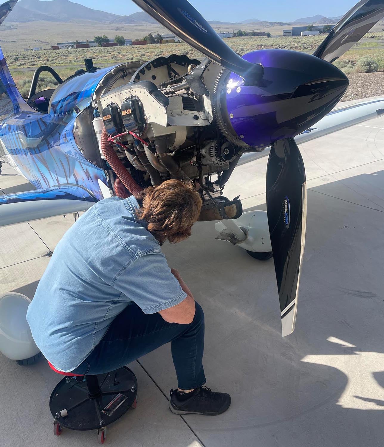

I don’t know about you, but the older I get, the less I like sitting with my arms and head just a few inches behind a spinning prop. When I think about watching professional mechanics tuning an engine “on the fly,” I realize that they were all young or had young assistants twiddling the knobs. Older and wiser, I enlisted my wife! No, not to tune it with the prop spinning, but to let me stay in the cockpit (and not climb out after every run) while she made adjustments in between. It was far quicker than climbing out each time—and easier on the body!
idle tune up 06

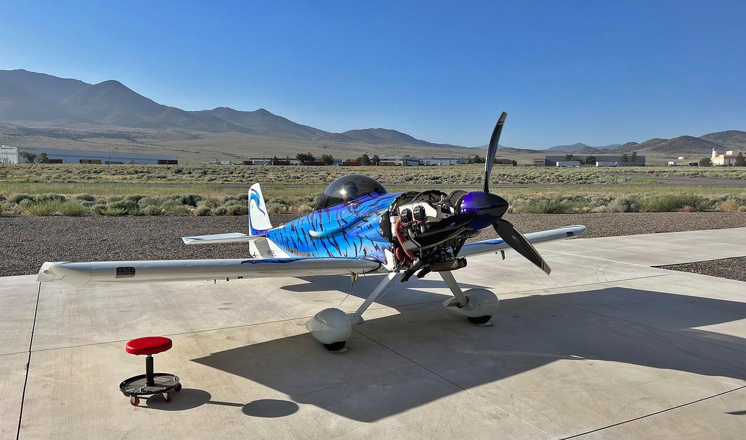

Have your assistant sit on a rolling stool so she can easily move in and out (and clear!) for each engine run. Its much more fun at our age than bending and kneeling.
I’d make a run and determine how much I wanted her to lean it, after shutting down. She’d make the adjustment and, importantly, record it. There’s nothing worse than forgetting where you are from your starting point, in case you have to return. Then I’d get her clear, start back up and see what I wanted next. For each run, we noted how much we leaned the idle mixture (in thumbwheel notches) and then could add them up to figure out how far it was off at the beginning.
I progressed with leaning while manually holding idle until it was clear that I could get it to smoothly idle at about 750 rpm, then we set the idle stop for the throttle and proceeded with the usual tweaking of idle mixture to get the 50-rpm rise at shutdown. It only took six runs, which wasn’t bad considering how far out it had drifted. Now the interesting thing will be to keep an eye on it as our local density altitude goes up and down with the seasons and see how much adjustment it wants.

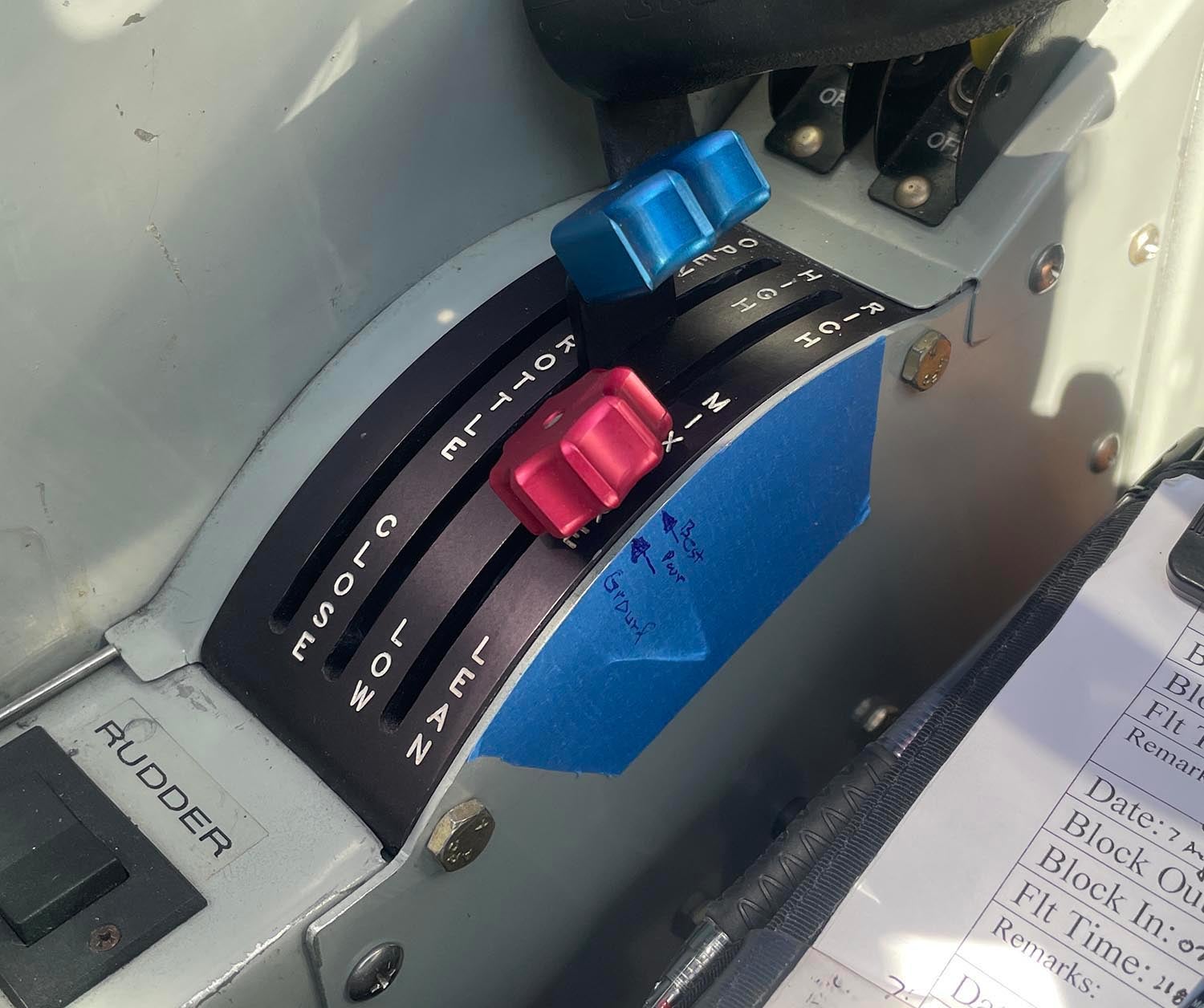

A piece of masking tape with marks on it will quickly show the pilot where to put the mixture to be “close” very quickly for Best Power and ground idling/taxiing. Yes, it changes with altitude, but most pilots tend to cruise in the same altitude band all the time.
One further thing I did was to put a piece of tape next to the mixture lever indicating where our best-power setting is for our usual altitude, as well as a mark for ground idling (which also turns out to be very close to our lean-of-peak-EGT cruise setting). It’s interesting to note just how far back this is in the mixture travel. For those of you (like us) who fly mostly in the mountain west, it shows just how far back the mixture lever should be for a high altitude take-off or go-around. That old “mixture full rich for take-off” checklist item is most definitely wrong once you start flying with density altitudes above 6000 feet!
