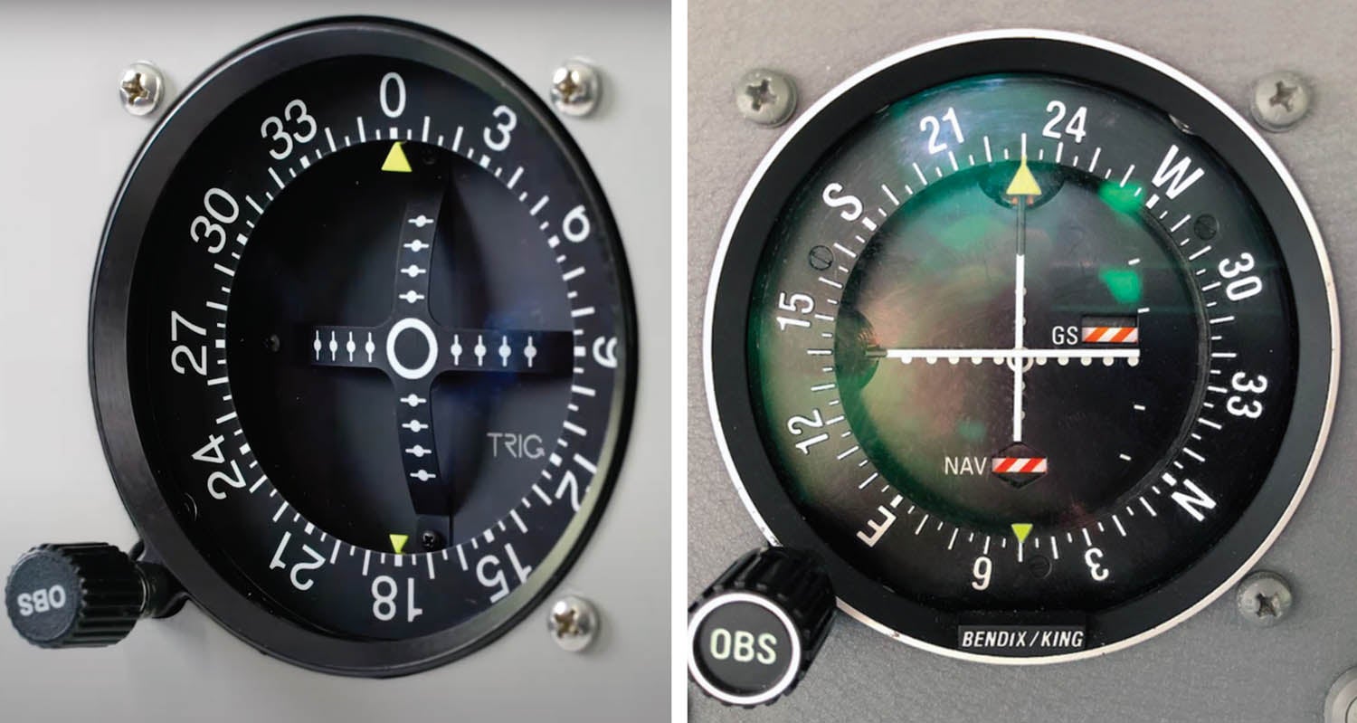

CDI and Trig
We like that the Trig radios are compatible with a variety of external CDIs. That’s Trig’s TI106 on the left and a King KI209 on the right.
Open Architecture, Easy To Install
Trig understands the importance of cross-brand compatibility because of the wide variety of nav indicators that are in existing panels—everything from modern EFIS displays to analog CDIs. That’s a dollar-saver for existing panel upgrades and enticing for new kits. With composite analog nav, an OBS resolver and RS-232 serial outputs, the Trig is likely compatible with a legacy nav indicator that may already be in place—maybe a King KI 209 as a common example.
At the Trig kiosk at AirVenture, the demo was saddled up to an Aspen EFD1000 Pro Max PFD and the second radio was connected to Trig’s own TI106 mechanical CDI. Trig said it designed the radios to also work with Garmin G3X Touch integrated flight displays (and the GI 275 EHSI) and Dynon SkyView displays. Since the radio has an RS-232 output, it can display left/right course data on the uAvionix AV-30 flight instrument. Got a King KN 63 DME? The Trig radio will channel it. Thumbs up to Trig for good compatibility.

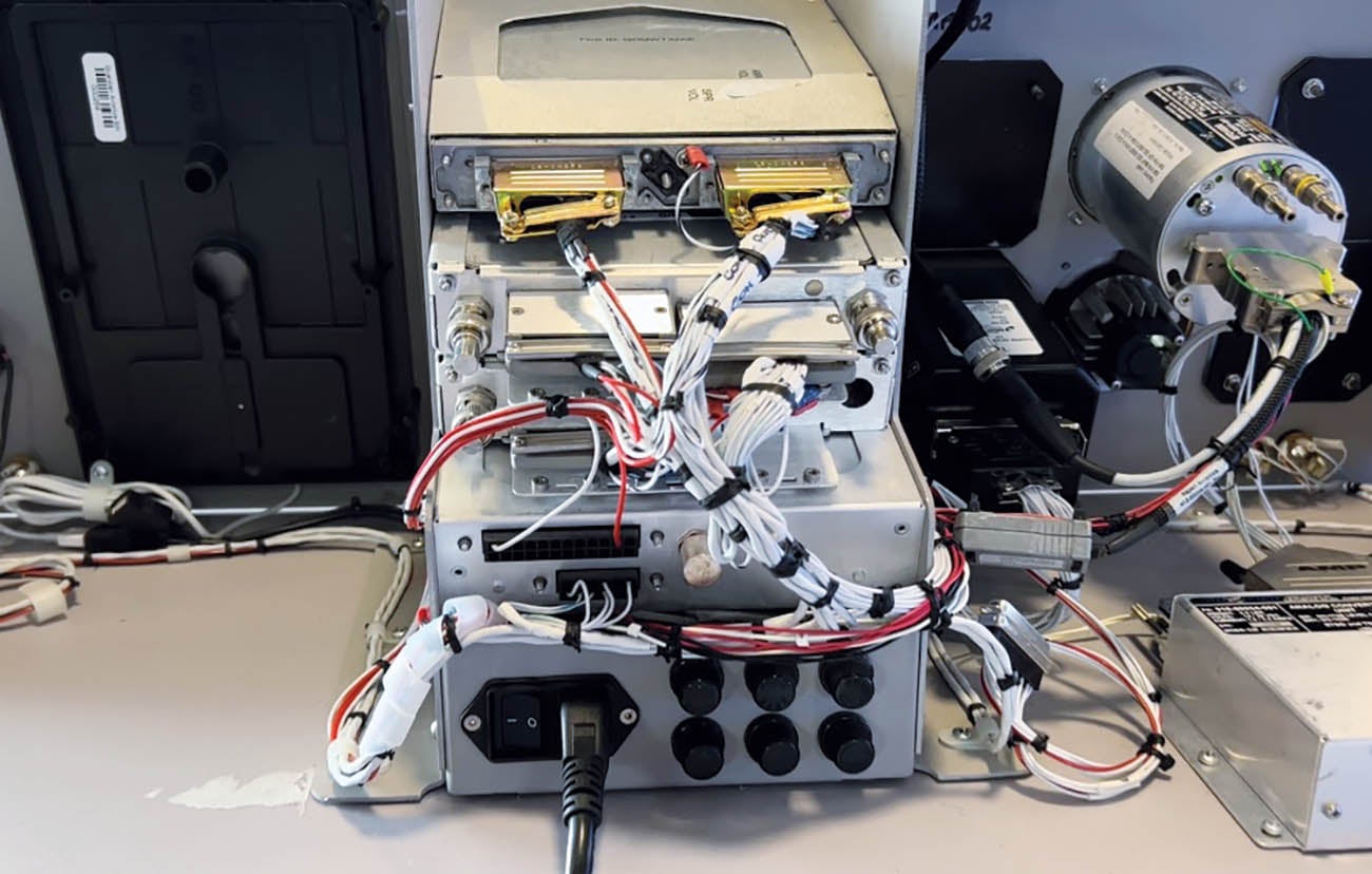

Trig stack rear wiring
That’s a full Trig radio stack and wiring.
If you want out with the old CDI, Trig’s TI106 3-inch solid-state mechanical CDI can be used for primary course guidance. Priced at $2600 and made by Mid-Continent Instruments and Avionics, the LED backlit TI106 has a striking resemblance to the Garmin GI 106A. It has OBS course resolver output, which provides the compass card position as a phase reference electrical signal. It also has built-in annunciation for displaying To/From/BC/Nav/GPS mode status. With the appropriate switching relay, the indicator can be used with the Trig radio and a GPS. In fact, the radio’s lateral and vertical nav outputs can simultaneously drive up to five indicators.
When it comes to installation, Trig’s mechanical and electrical interface is straightforward and what you would expect with a modern nav/com. There’s a 25-pin D-type connector for the communications radio and audio system, and a 44-pin D-type connector for the navigation receiver. There are two RF antenna connectors—one for the communications radio and one for the navigation receiver. If the VHF nav portion of the radio will share a nav antenna with another radio (maybe a Garmin GNS 430 or another nav/com), you’ll need a nav antenna coupler. This is also a good time to run new coaxial antenna cable for the com and nav, if your installation still has the older non-shielded cable. Assess the condition of the existing antennas and replace them, too, if there’s any doubt about their performance. Old nav antenna systems can be a big source of signal loss.
The recommended signal combiner/splitter is the frequency-independent Minicircuits ZFSC-2-1-B+ (Trig Avionics part number 02309-00). Because it is frequency independent, it can combine and split both VOR/LOC and glideslope signals on the same coax antenna cable. Remember, every time you pass through a splitter/combiner, the signal strength is reduced.
