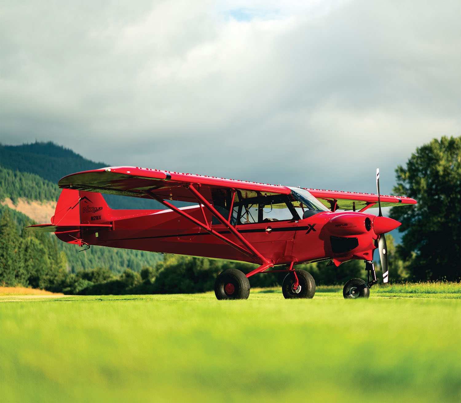

Big wheels turning: The NXCub’s tri-gear arrangement uses a very large 8.00×6 nosewheel and even bigger, 26-inch tundra-style mains.
Good, now we can talk. The only thing culturally remarkable about the CubCrafters nosewheel-equipped XCub—which I’ll contract to NXCub hereafter, though, technically it’s an XCub with the optional gear arrangement—is that the company has the smarts and courage to build it. The world in 2020 is radically different than it was in 1950, when new pilots started in Cubs (or Cub-like aircraft, such as the Taylorcraft, Luscombe and the Cessna 120/140). Then you could understand  why tailwheels were the “conventional” gear. These pilots moved up the ranks to the Cessna 170 or Piper Pacer, and if they were lucky would find themselves in the Cessna 180. All the best airplanes had tailwheels, steaks were still good for you and all was right with the world.

Developing the nosewheel structure is a story in and of itself, and consumed a tremendous amount of R&D effort on CubCrafters’ part. The system is based on a massive vertical strut with an integral shock mechanism. It’s a free-castering design with a seriously robust trailing link. The benefit here is that the nosewheel acts like it has a much greater diameter, rolling over terrain more easily. (Ever wonder why dirt motorcycles have big front wheels and street bikes do not? This is why.) Even then, the nose gear carries a big tire: an 8.00×6 with a 20-inch outer diameter. We’re not talking a 6.00×6 skateboard tire here! As CubCrafters’ Brad Damm says, “This was designed from the outset to be a serious backcountry airplane.”
Tricycle gear gives the XCub an entirely new stance and improves visibility over the nose during taxi, though the taildragger version is actually very good for the genre.
There’s a clever mechanism that allows you to disconnect the steering stops by pulling a pin and dropping a key away, which would allow the wheel to rotate through 360°, in turn making parking of the airplane easier inside a crowded hangar. (The normal limit is 95° in each direction.) You can push the airplane straight back without having to fight the geometry. Anyone who has tried to keep a free-castering nosewheel straight without using a tow bar appreciates this. The outsized nosewheel is joined by Alaskan Bushweel 26×12 tundra tires.
CubCrafters rightly points out that the NXCub has better visibility on the ground than the taildragger version, which is actually quite good by those standards, and the ride is plush even over really quite lumpy runway surfaces. But I’m getting ahead of myself here.

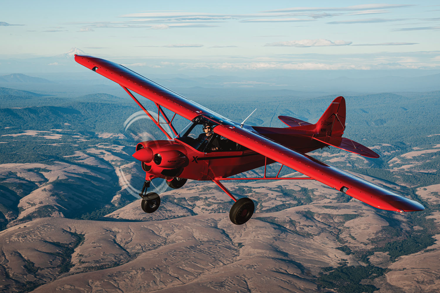

Finally after a bit of chatter, Brad and I got to Yakima’s main runway and pushed off into very little wind. The procedure is simple. With the runup complete and two notches of flaps selected, we turned onto the runway. I should note that we had just 20 gallons of fuel aboard (max is just shy of 50) and no luggage. With less than 400 pounds of human cargo aboard, we were around 450 pounds under the 2300-pound max gross. (The certified version of the XCub is rated in the Normal category to 2300 pounds and 1980 pounds in the Utility category.)
The CC393i needs (and gets) plenty of cooling air, thanks to a shapely cowling in carbon fiber.
So, do the math. Under 2000 pounds of airplane with 215 hp and a big prop. Roll the throttle open, count to about two and a half. By then, the airspeed has whipped through 40 mph indicated (IAS) and you can hoist the nose. Up it comes as the NXCub accelerates rapidly. It takes quite a bit of deck angle to maintain the best-angle climb rate 59 mph IAS, and as I glanced down we were easily beating the rated climb spec of 1500 feet per minute. It felt like we were almost hovering over the runway, which seemed excessively long by now, by the time I thought to lower the nose and start retracting the flaps. Trees at the end of the runway? No problem.
cubcrafters nx cub 14
Engine controls are mostly stacked on the left window sill (right). You will want to open the window and hang your elbow out.
Departures happen very quickly but here’s the important thing: While the acceleration was brisk, the airplane is marvelously controllable and predictable. At no point did I feel it getting ahead of me or requiring unusual control inputs. The ailerons have a tiny bit of deadband right on center but pick up their effectiveness smoothly and progressively, with little effort at this low speed. It took almost no adjustment for me to get the inputs right to keep the bank angle and rate of change right where I wanted them.
And, as you might expect from a certified aircraft, it was trim-stable in pitch with relatively long stick throws, meaning it was easy to nail the pitch attitude despite power and configuration changes. In yaw, the airplane has clearly benefitted from the added fin area that came with the XCub, and while it is sometimes the case that a nosewheel becomes destabilizing in yaw, I didn’t see any of that. It was a bit bumpy as we crossed the foothills to the south of Yakima, but it was no trouble keeping the ball in the center and the other axes under control.
Brad and I did one landing back at Yakima and it was easy. The airplane wants to approach at about 60 mph IAS, which feels slow but is well within its performance envelope. (How much so I would find out a bit later.) The big prop makes speed management simple and adding the third notch of flaps adds enough drag that you’ll want to carry a little bit of power. But that combination makes it crazy easy to find your spot on the runway and hit it, right on speed, with exactly as much energy as you’d planned. It helps, I suppose, that you can see so easily over the nose and that you can be a little lazy with your feet. (I’m not advocating that but, hey, it happens.)
